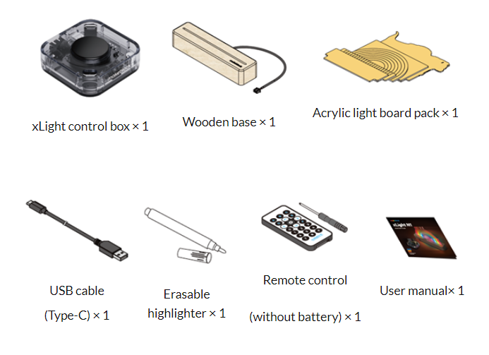

xLight N1

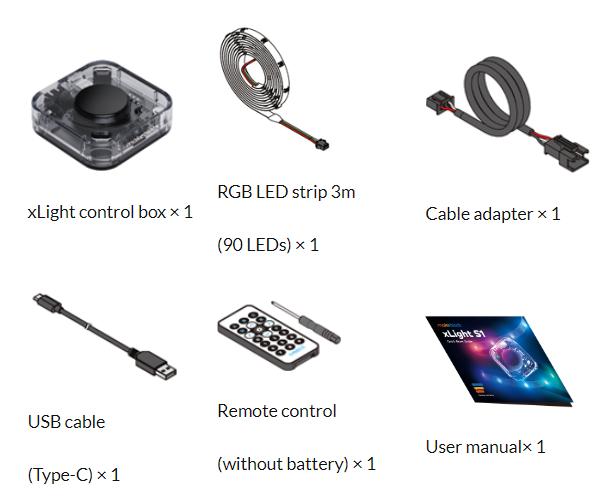

xLight S1
Note: When you use xLight S1, you need to use the Makeblock app to activate the LED strip. Otherwise, only the first 21 LEDs of the LED strip work by default. For details about how to use the Makeblock app, see Control xLight with the Makeblock App.
xLight U1
Note: When you use the LED strip or string, you need to use the Makeblock app to activate the LED strip or string. Otherwise, only the first 21 LEDs of the LED strip or string work by default. For details about how to use the Makeblock app, see Control xLight with the Makeblock App.

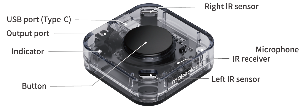

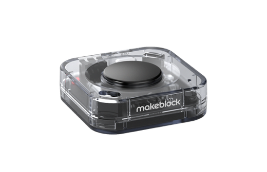

xLight control box
Indicator state |
xLight working state |
Blinks blue 3 times |
Bluetooth connection succeeded |
Blinks red |
Entering the sleep state |
Blinks white |
Operation succeeded |
Normally on in green |
In mood lighting mode/user-defined program |
Normally on in yellow |
In music-reactive lighting mode |
Normally on in purple |
In magic lighting mode |
Normally on in cyan |
In interactive gaming mode |

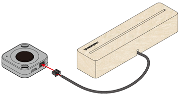

2. Connect the LED strip to the control box.

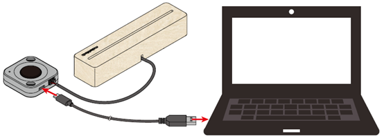

3. Connect the control box to a power supply.
Tips: Alternatively, you can use a charger or power bank to supply power to the control box.

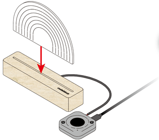

4. Insert a light board into the wooden base.
The rainbow board is used as an example. You can use any of the light boards.
