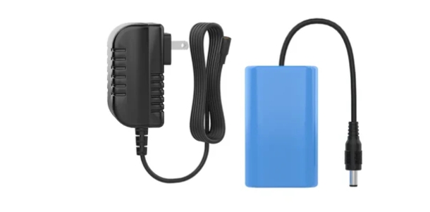

  2. If the product is currently powered a battery holder, please install new Nanfu AA batteries. If the problem persists, you can plug in a USB cable to power the product at the same time, and then test the Bluetooth connection in the App. If the connection is successful at this time, it can be verified that the problem is the battery. It is recommended to use Makeblock rechargeable battery pack.
