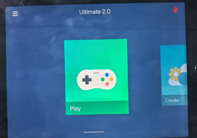

(1)Open the machine's Power Switch and Makeblock App and connect the two via Bluetooth.

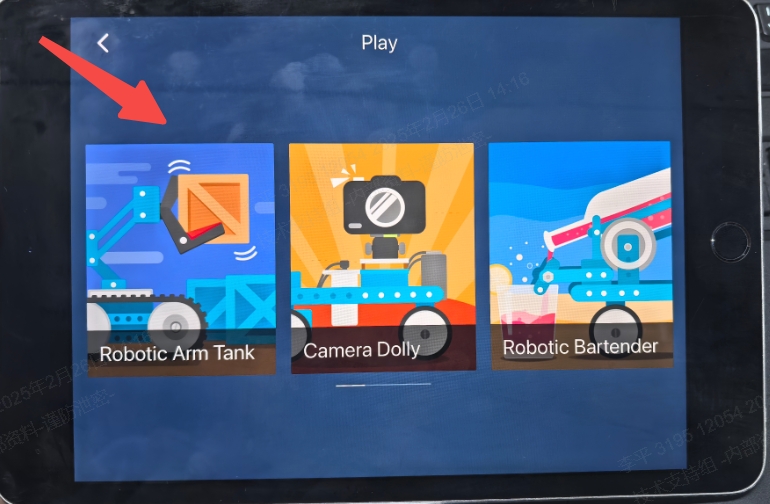

(2)Assuming that the product is assembled in the form of Robotic Arm Tank, enter the “Play” section of Makeblock APP and select the function page of that bulding form. If the product is built in another form, select the page for the corresponding form.

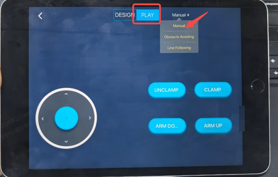

(3)After entering this mode, just click Manual at the top and then run the machine for seconds with the direction switch key.
