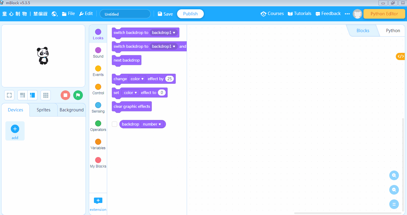

  1. Download the latest version of mBlock software or directly enter the web version to operate: https://mblock.cc/pages/downloads
  1. Turn on the Power Switch on the machine's motherboard and connect the robot to your computer using the original USB cable.
  1. Open mBlock, enter the device library and add the Ultimate 2.0 device extension (if there is a green arrow in the upper right corner of the device, click on the arrow to update the device plugin first)
  1. Click Connect and note that you do not need to check the “Show all connectable devices” box.
  1. Click "setting"after successful connection, and then click Firmware Update to start the process. Please do not exit or close the current page during the update process.
