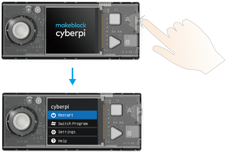

2. Enter CyberOS
CyberPi automatically enters CyberOS after you restart mBot Neo. If it doesn’t, press the Home button on CyberPi.
3. Choose and execute a program
Take program 1 as an example.
Move the joystick down to choose Switch Program, choose Program1, and press button B to execute the program.

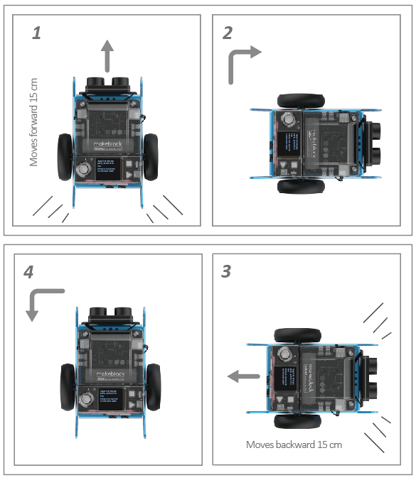

Mode 1: Path design
In path design mode, the LEDs on CyberPi are lit up in red, and you can use the joystick to plan the path.
(1) Move the joystick to plan the running path of mBot Neo.
For example, move the joystick up, to the right, down, and then to the left.
The path you have planned is displayed on the screen of CyberPi.
(2) Press button B on CyberPi.
mBot Neo runs in the path you have planned.
