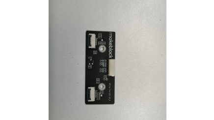

Q11: Why are mTiny eyes not displayed (full white)?
1. Update the firmware according to this article.
2. If the adapter board is faulty, please contact service@makeblock.com .
