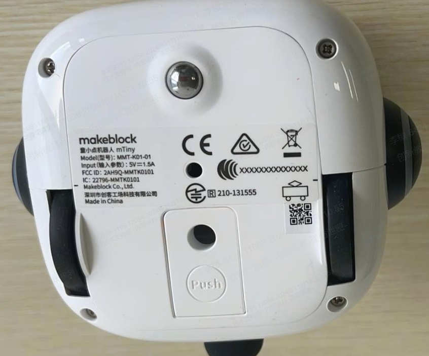

No color markers slot on the bottom of the robot
V28.01.006.002.t1
B-end version (Education version)
mTiny Discover Kit
(with old black motherboard)
No SN label on bottom of robot
V28.01.006.002.t1
mTiny Discover Kit
(with new green motherboard)
Has SN code label on bottom of robot
V28.01.008.002.t1

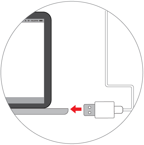

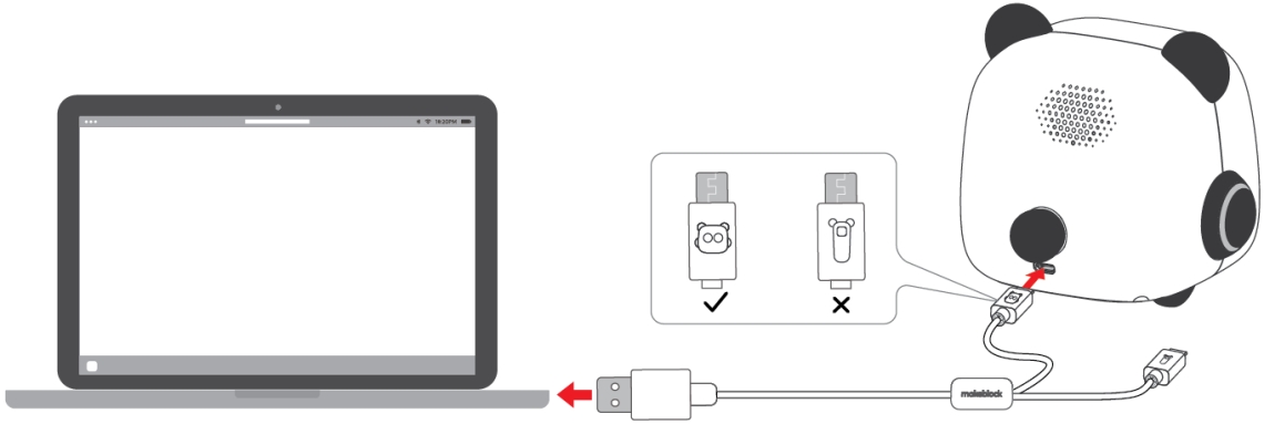

  1. Connect the mTiny to your computer via the original USB cable. Make sure to connect the mTiny using the end with the mTiny robot icon.

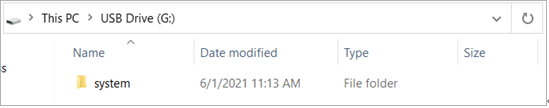

  1. The computer will recognize the mTiny disk after the USB connection is successful. Please open it and you will see a folder named “system”.
Step 4: Remove Old Firmware and Add New
  1. Right-click on the folder “system” and select “Delete” to delete the folder.
  1. Decompress the firmware package downloaded in “Step 2”, find the “system” folder and “audio_mcu_firmware.MVA” file in the extracted directory. Copy and paste the folder and file directly into the mTiny disk.

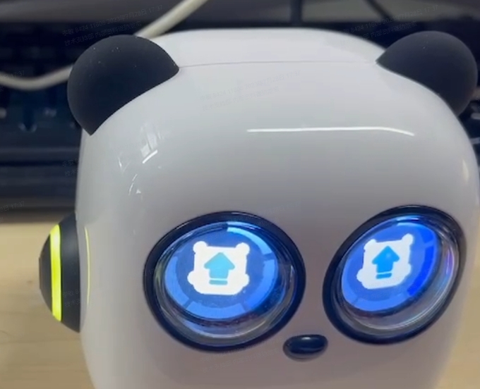

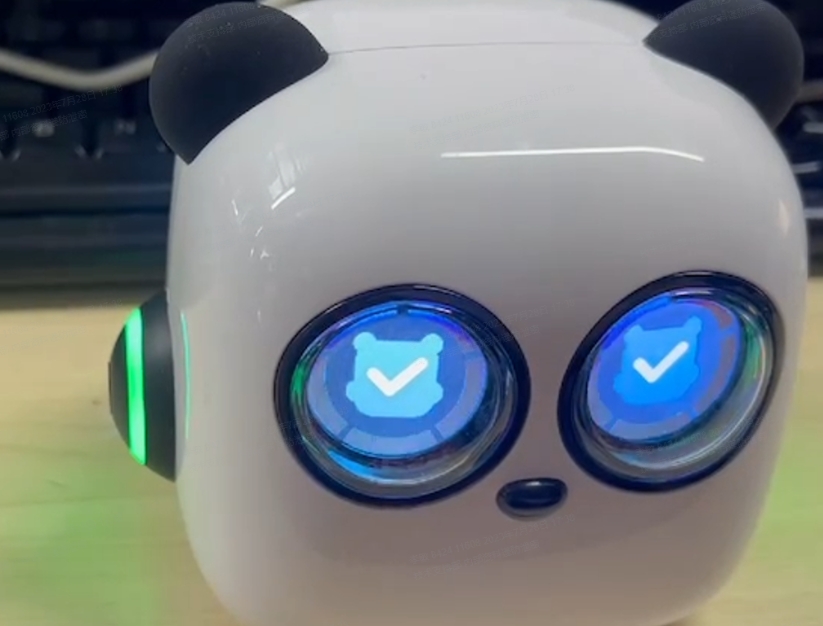

  2. Restart the robot to begin the update. During the upgrade process, the mTiny display will show a logo that the upgrade is in progress. When the upgrade is successful, the mTiny display will show the “✔” logo and make a “hi” sound, then the side will light up green.
Note: If the above phenomenon does not occur, it means that the firmware upgrade is most likely unsuccessful.
Updating Updating Successful
