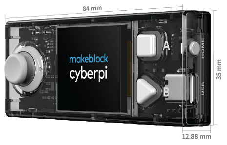

Dimensions 84 mm x 35 mm × 13 mm (height × width × depth)

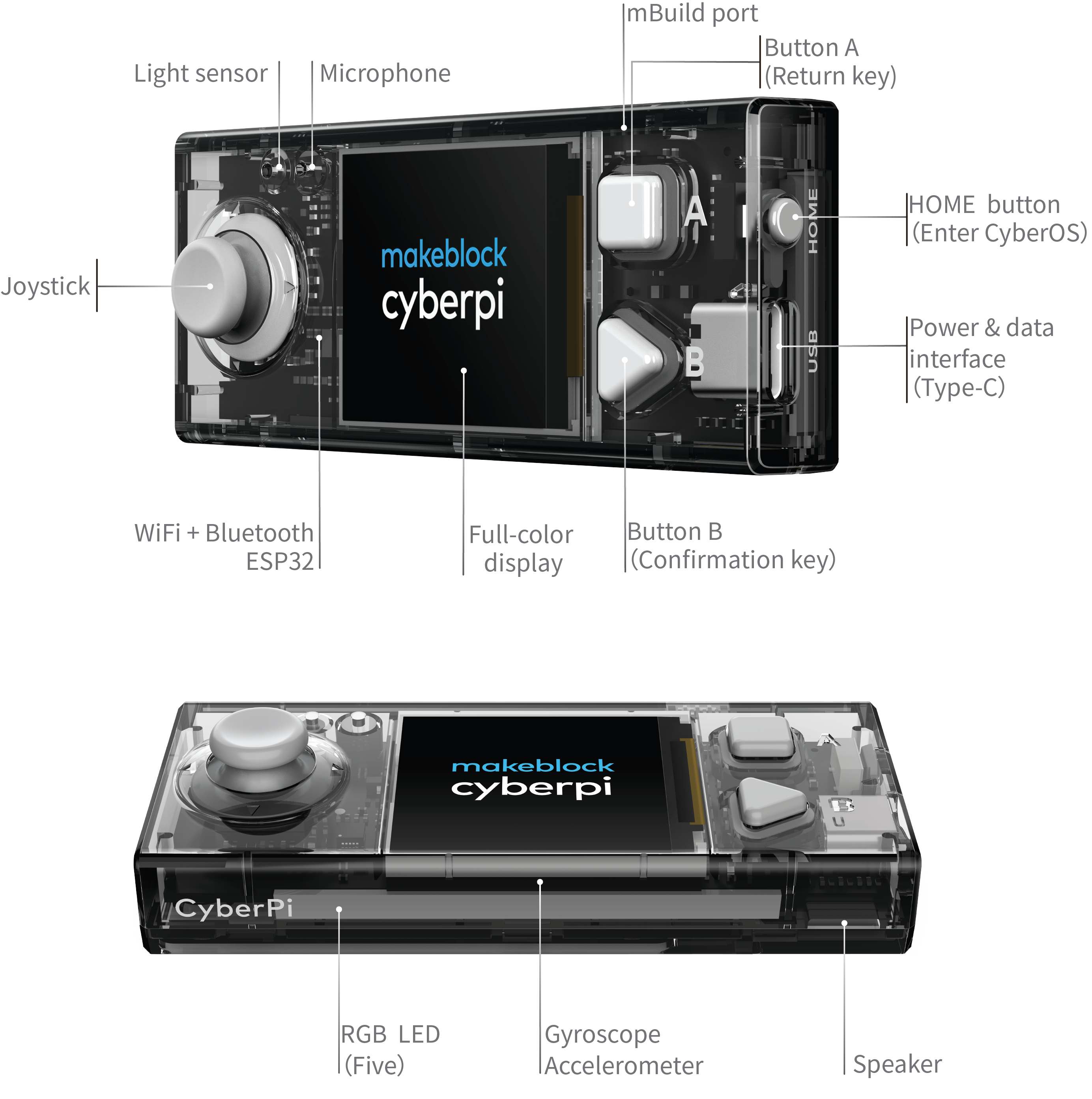

  • Full-color display, providing user-friendly UIs for human-machine interaction
  • CyberOS system, allowing you to execute the predefined programs, set the system language, and update the system through the onboard joystick and buttons
  • One Micro USB port (Type-C) for connecting to PCs for power supply and communication
  • One electronic module port for connecting to electronic modules
  • One extension board port for connecting to extension boards
  • Multiple onboard sensors, such as light sensor and gyroscope, which provide multiple types of data
  • Five LEDs, allowing you to present abundant light effects
  • Onboard Bluetooth and Wi-Fi modules, enabling wireless communication

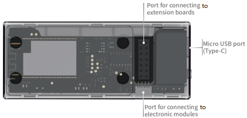

CyberPi is equipped with a USB Type-C port, a port for connecting to electronic modules, and a port for connecting to extension boards, which allow CyberPi to easily and quickly connect to various types of electronic modules and extension boards.
The Micro USB port allows CyberPi to connect to various types of computer devices for power supply and communication.
When charging CyberPi, ensure that the voltage is lower than 6 V. Otherwise, the hardware of CyberPi may be damaged.
Port for connecting to extension boards
You can easily and quickly connect CyberPi to an extension board through the extension board port. Currently, the extension board Pocket Shield is available for CyberPi.
Pocket Shield is equipped with a built-in rechargeable battery that can supply power for CyberPi and provides 2-pin and 3-pin interfaces that can be used to connect to servos, LED strips, and motors, which significantly improves the extensibility of CyberPi.
For more information, see Pocket Shield.
Port for connecting to electronic modules

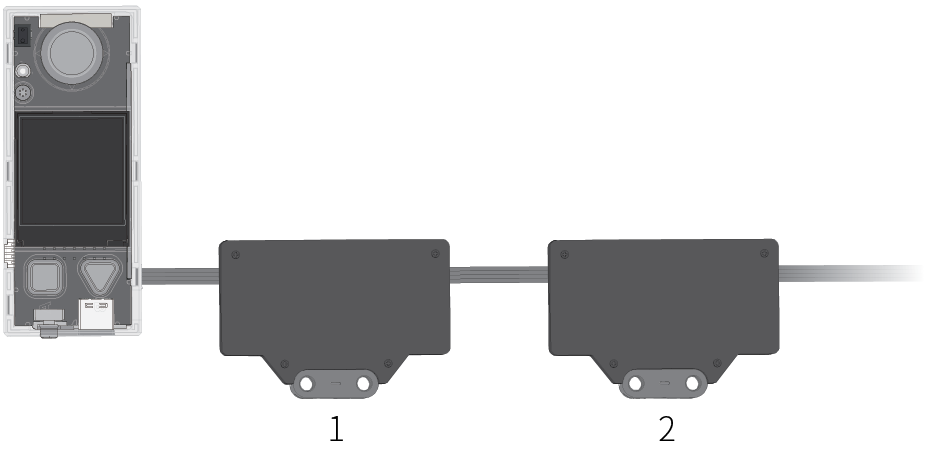

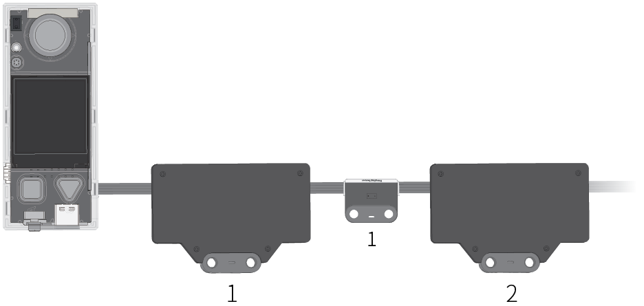

You can connect CyberPi to multiple electronic modules in series through the electronic module port.
CyberPi can identify the addresses of the modules, which simplifies your programming. You don't have to set the information about the addresses of the modules when you add or remove a module.
Example:
Connect CyberPi to multiple LED matrixes

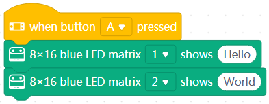

After connecting CyberPi to multiple LED matrixes, you only need to specify the place of an LED matrix among the ones connected instead of specifying the port to which the LED matrix is connected when compiling a program. As shown in the figure above, the first LED matrix connected to CyberPi is numbered 1, the second one numbered 2, and so on.7.png
When you press button A on CyberPi, the first LED matrix displays "Hello" and the second one displays "World."
The preceding program still works after you add a ranging sensor. When you press button A on CyberPi, the first LED matrix displays "Hello" and the second one displays "World."
