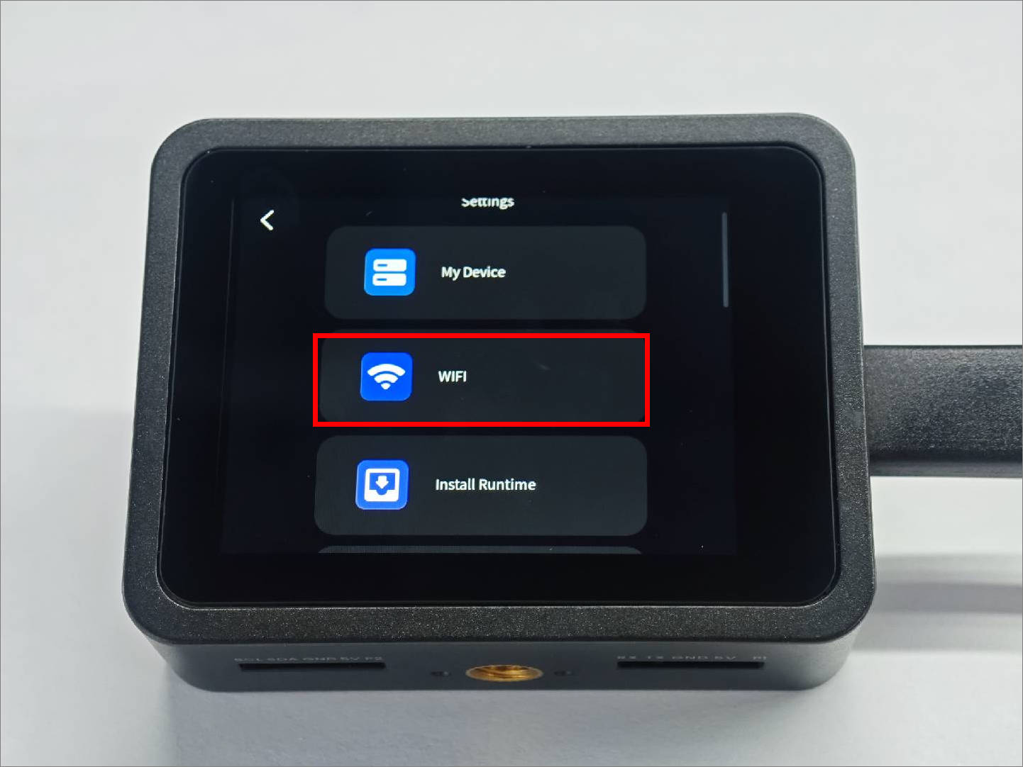

1. Tap Settings.
2. Ensure that the network is available, and then click WIFI.

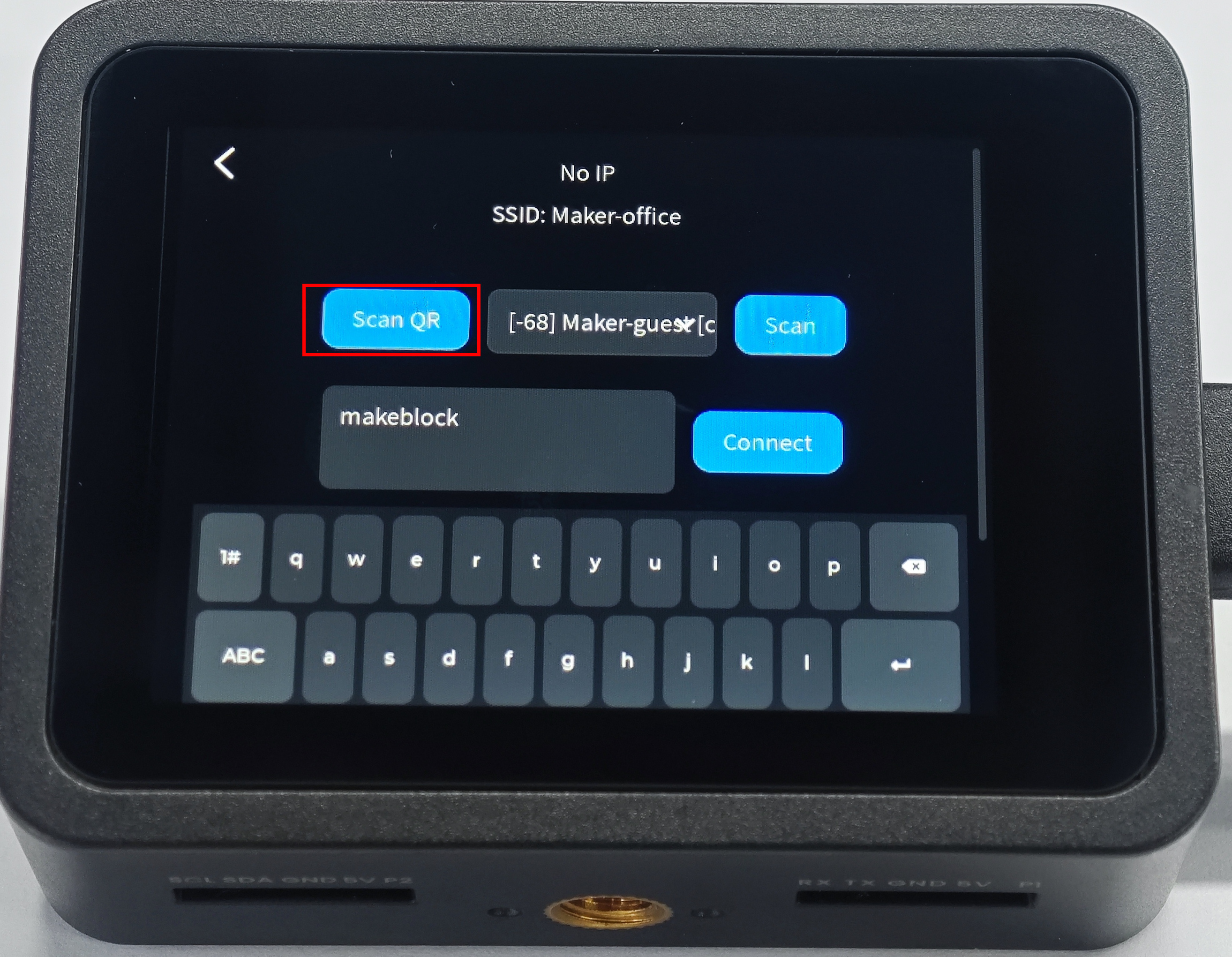

  • Option 1: Click Scan QR to connect to Wi-Fi by scanning the Wi-Fi's QR code.
  • Option 2: Click Scan to search for nearby Wi-Fi networks, enter the password, and then click Connect.
