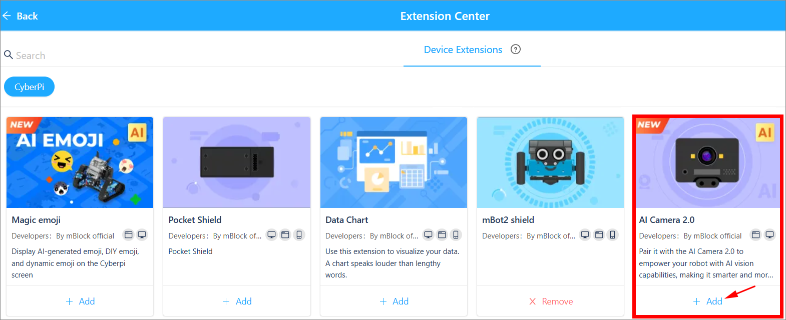

3. Add the AI Camera 2.0 extension
Web version
  1. Add CyberPi from the device library.
2. Add the AI Camera 2.0 extension.
Click extension. And click Add in the AI Camera 2.0 card.
PC version
  1. Click extension.
2. On the Extension Center page, click Device Extensions (NOT Installed).
3. Find AI Camera 2.0 and click Add.
4. Restart the mBlock software. Then you can use and update the AI Camera 2.0 extension from Installed extensions.

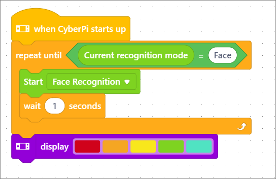

4. Start AI Camera 2.0
Open AI Camera 2.0. The device will take a moment to initialize and switch modes.
To ensure stable operation, the system automatically checks whether the current recognition mode is set to face recognition, and sends a switch command every second until the process is complete. Once ready, the indicator light changes color to confirm the system is prepared for recognition.
