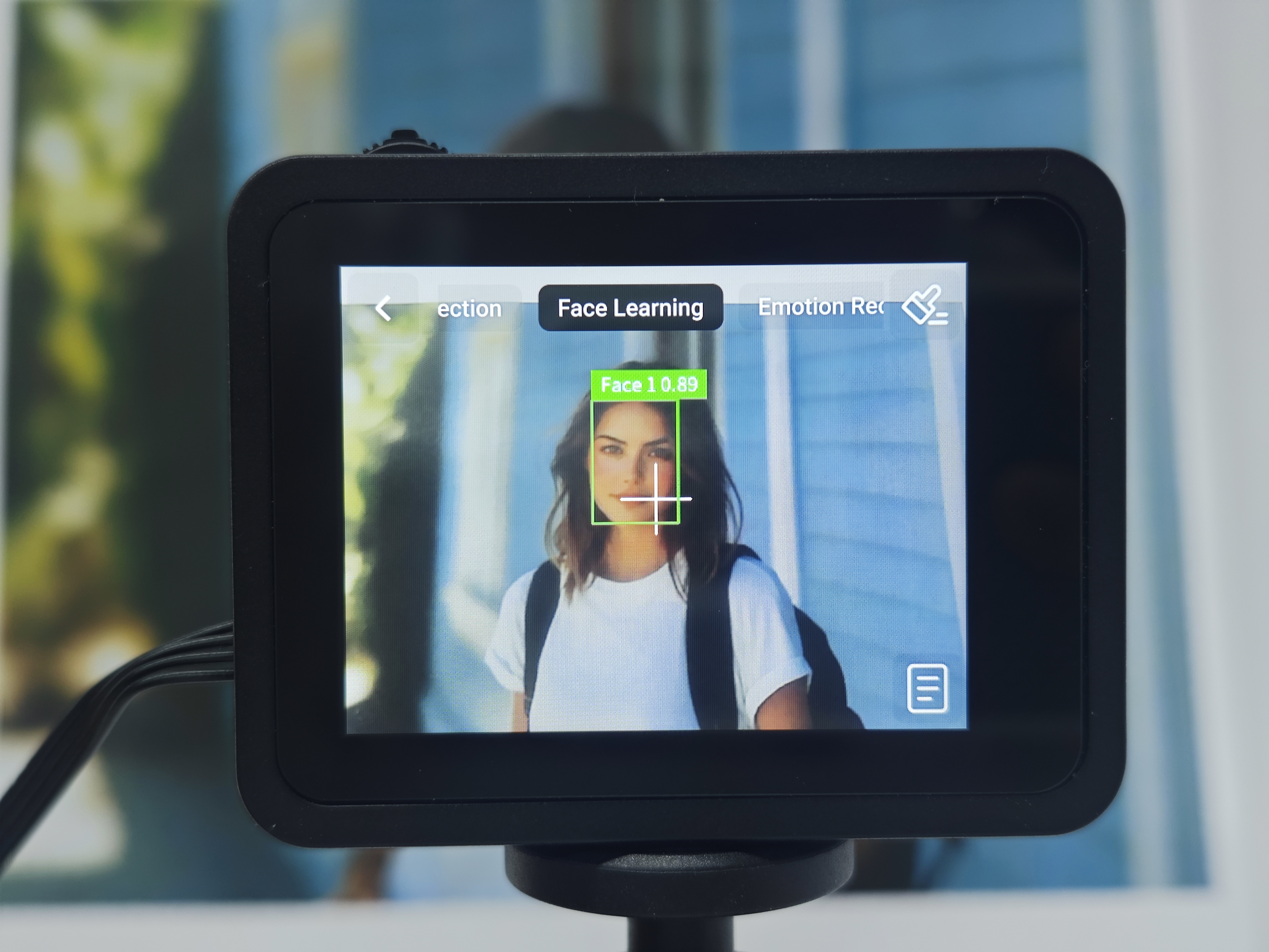

  1. Tap the Face icon on the AI Camera 2.0 to start the face recognition feature.
  1. Orient AI Camera 2.0 toward the face for recognition. For a new face, AI Camera 2.0 will frame it in white and display Unknown. The top menu shows available operations for the current face: Face Detection, Face Learning, and Emotion Recognition. You can tap the corresponding option or toggle the switch on the top left or right to switch between them.

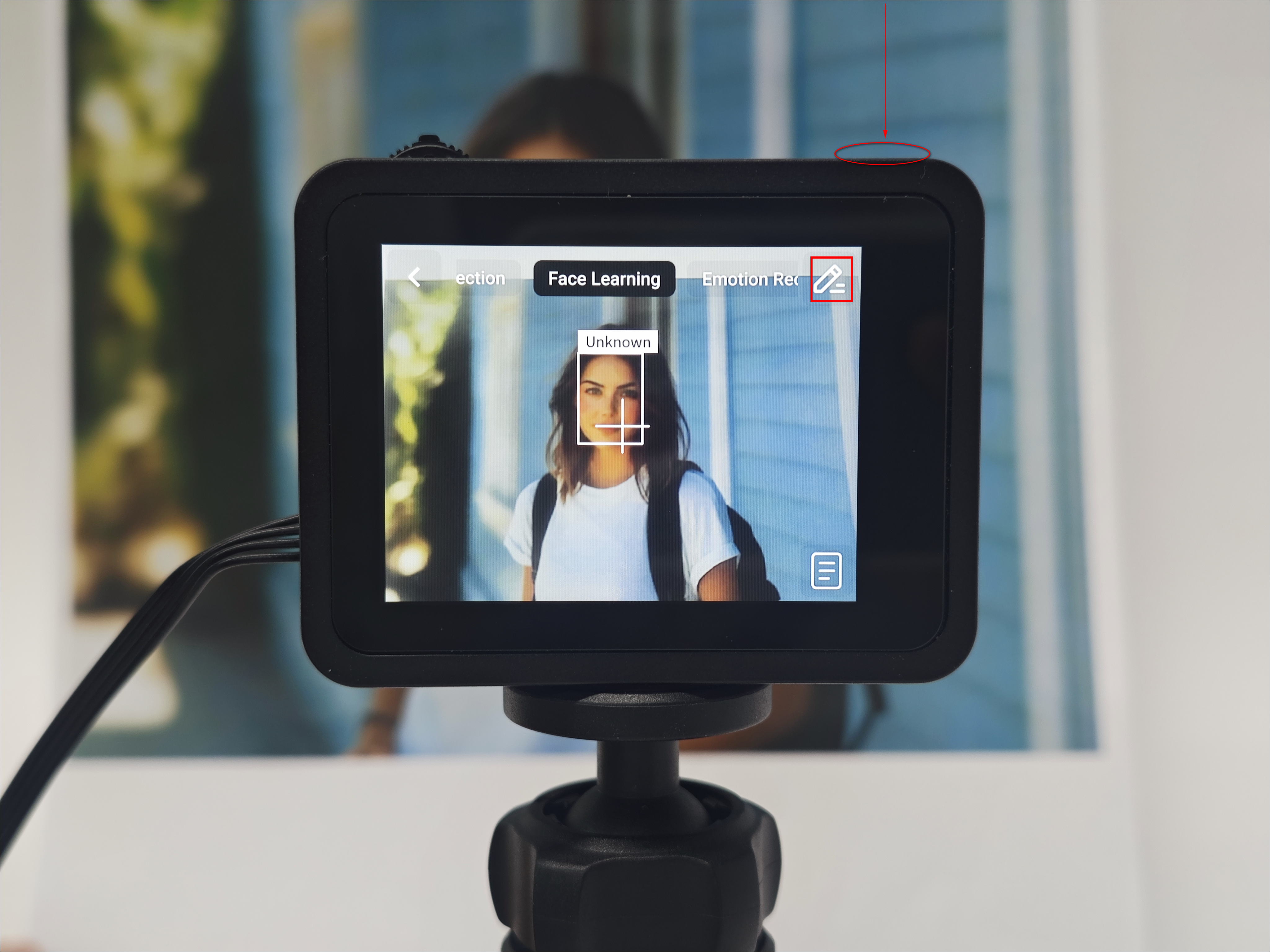

Face learning
Aim the cross in the center of the screen at the face, then press the Learn button on the top of the device or tap the learning icon.
After learning, AI Camera 2.0 marks the face with a green box and displays it as Face1. The number following the name represents the recognition confidence. In the example below, the confidence is 0.89.

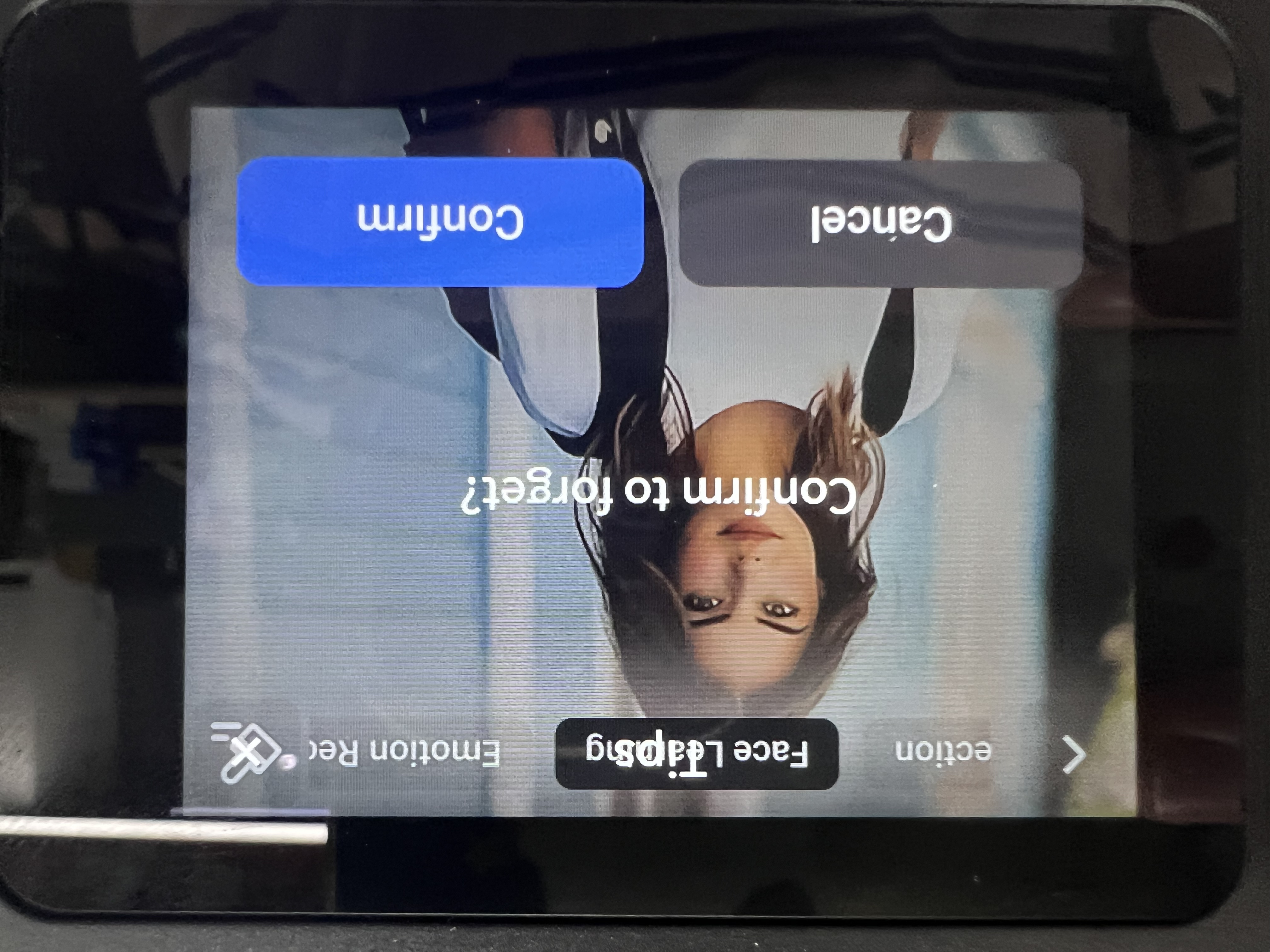

Face deletion
Aim the cross on the screen at a learned face, and then press the Learn button or tap the forget icon. In the Confirm to forget? dialog box, tap Confirm.

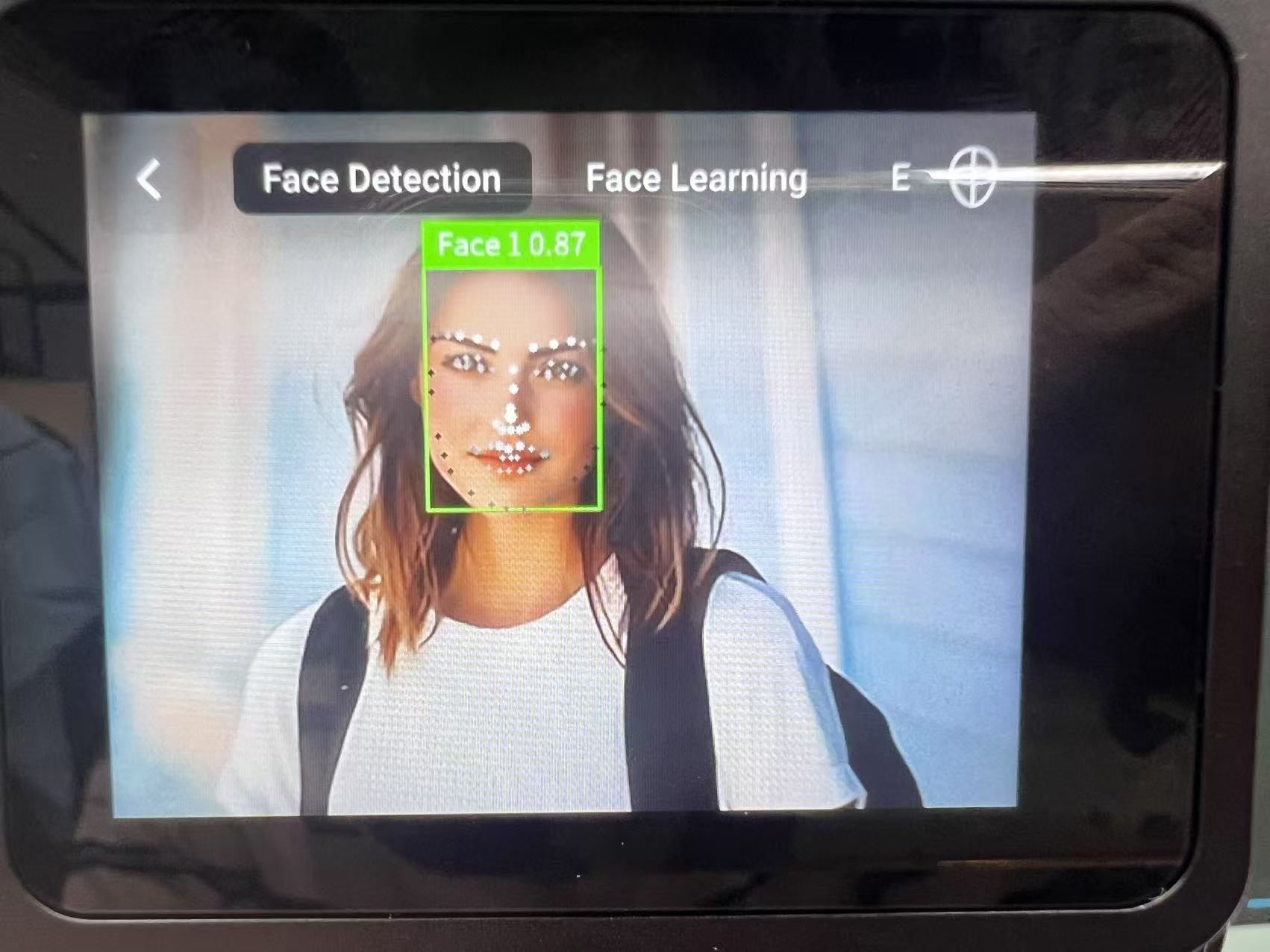

Face detection
Tap Face Detection or toggle the switch on top to the left to select Face Detection.

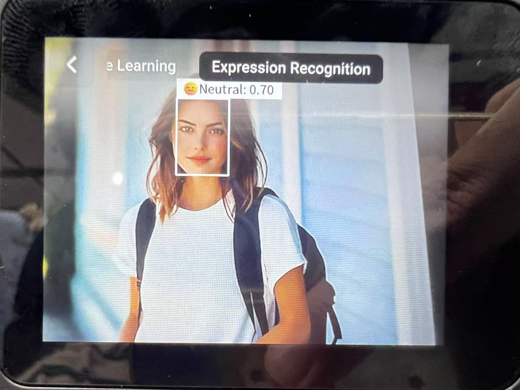

Expression recognition
Tap Expression Recognition or toggle the switch to the right to select Expression Recognition.

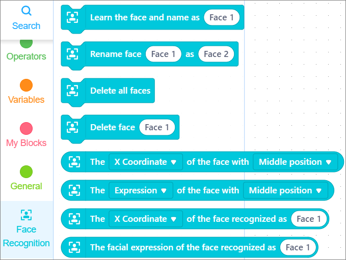

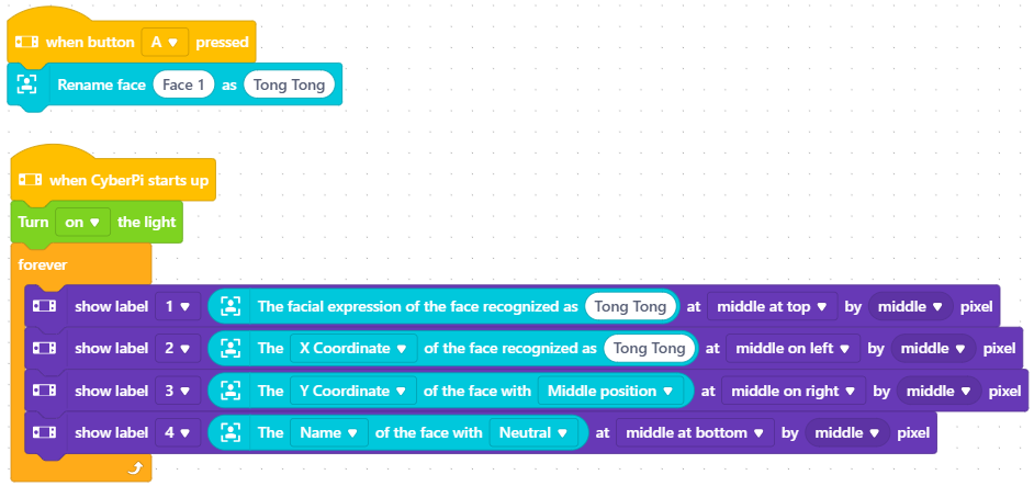

Coding block example
Face recognition blocks
In this example, pressing button A triggers face recognition and renaming. Combined with emotion judgment, coordinate tracking, and screen feedback, it intuitively demonstrates the interaction process from face recognition and data binding to state awareness.

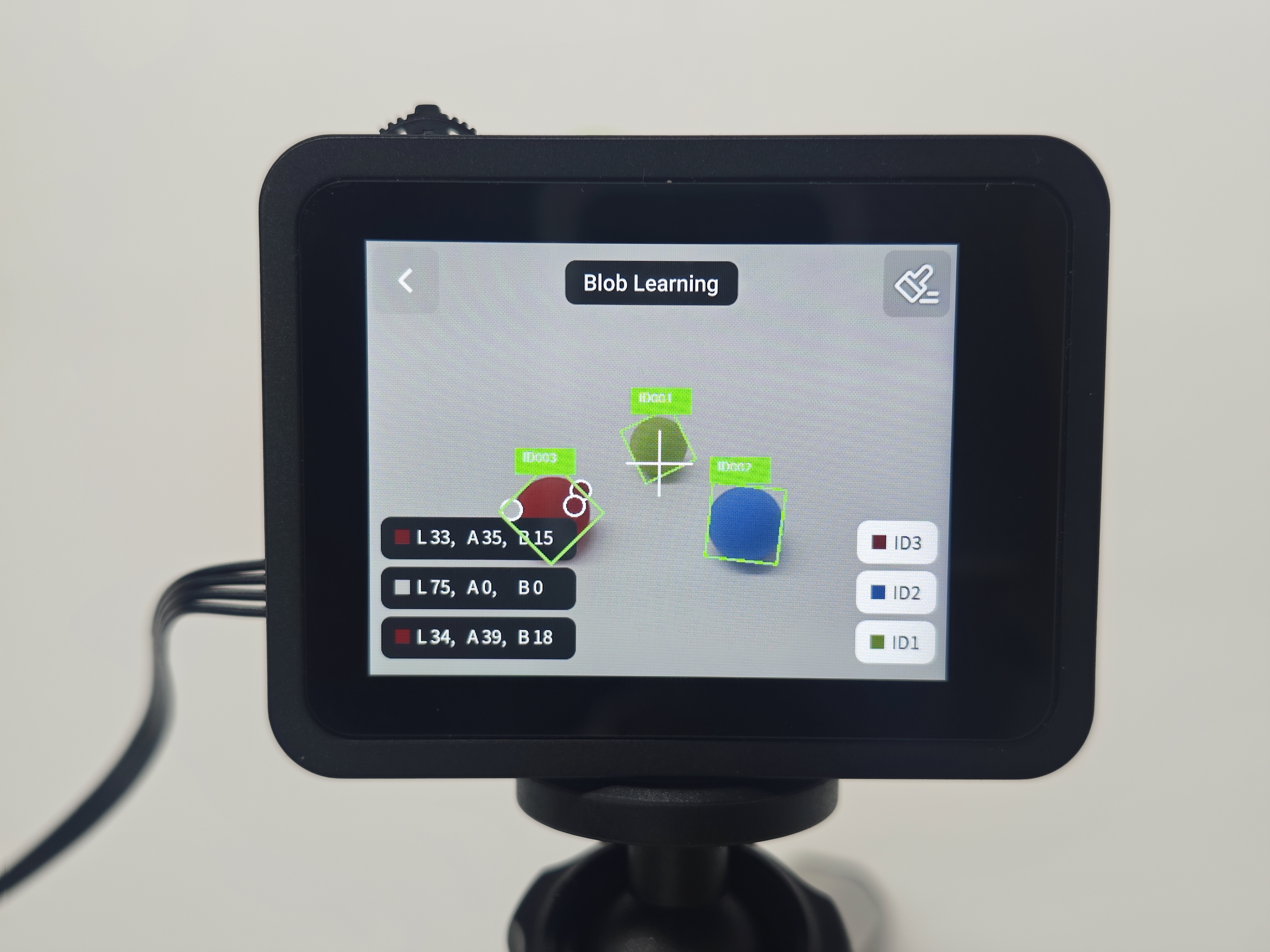

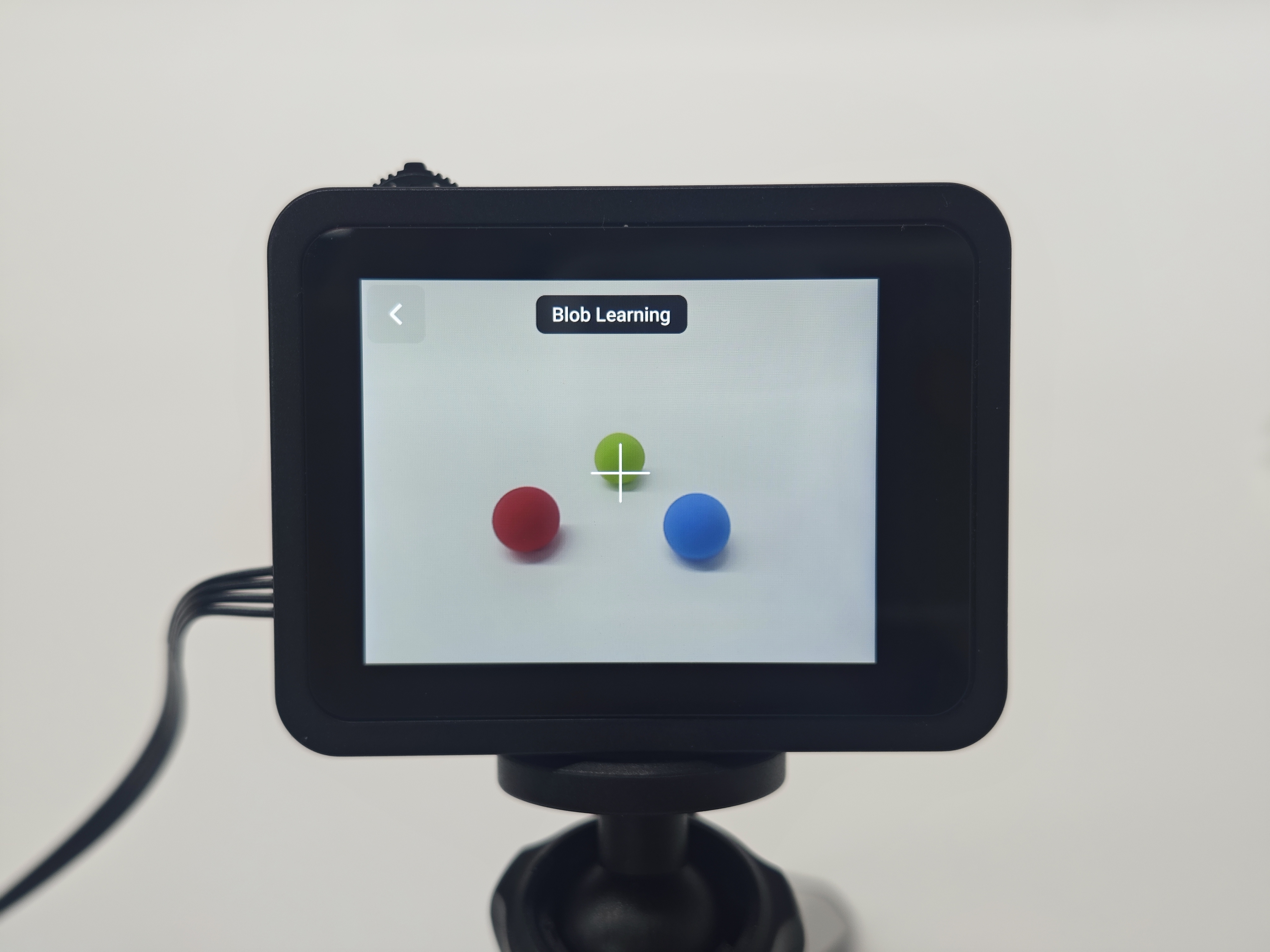

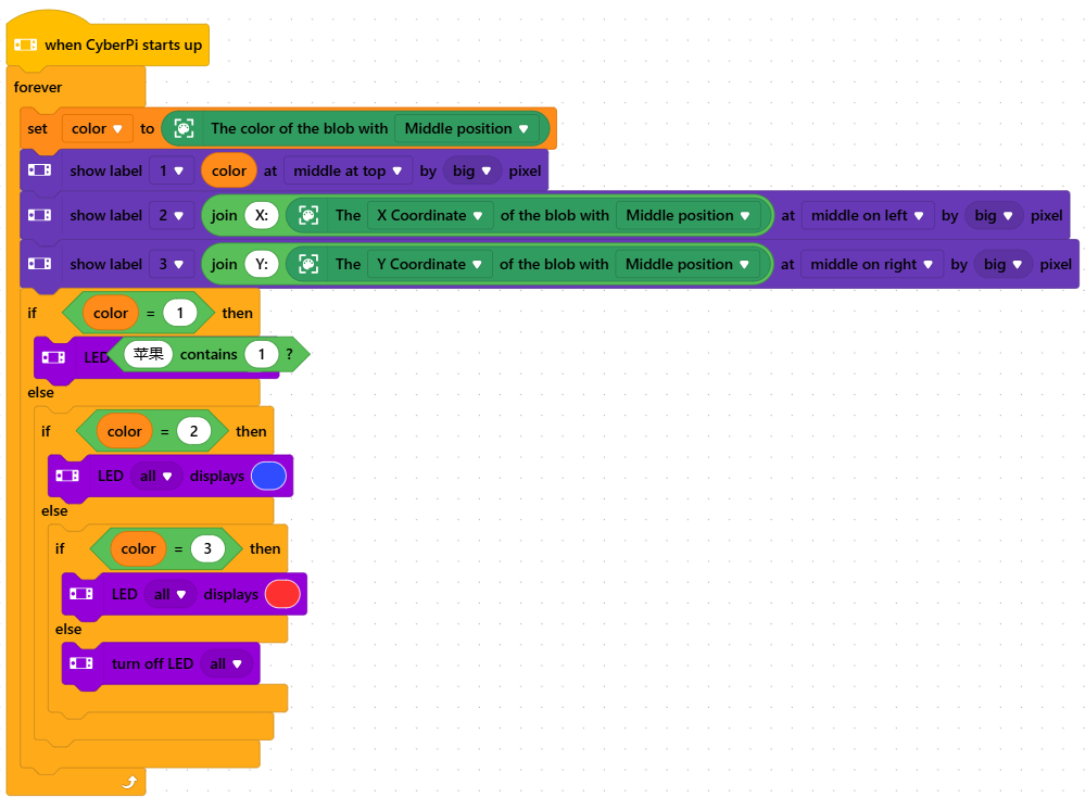

Color recognition

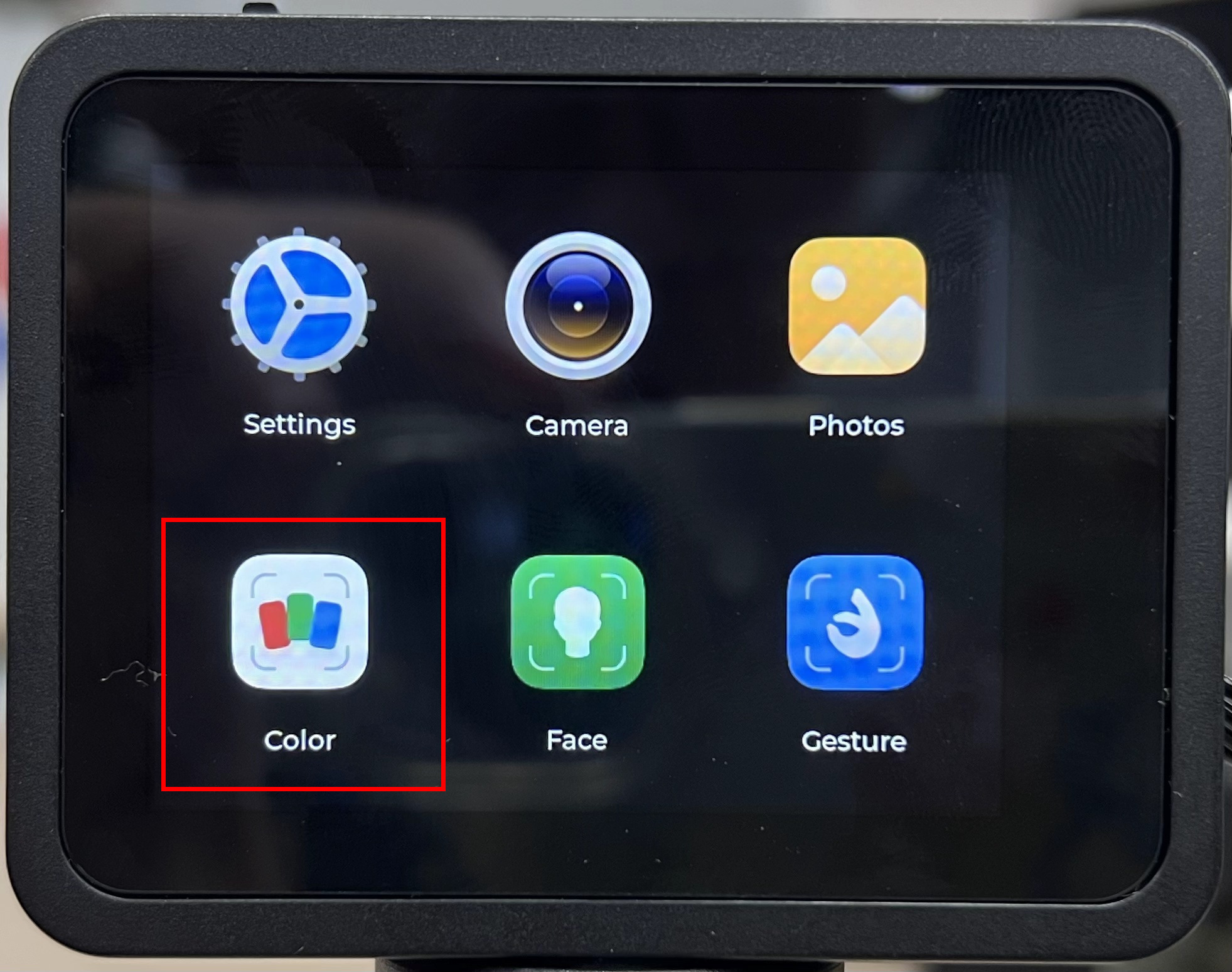

AI Camera 2.0 can learn and recognize colors. It can obtain information such as a color’s coordinates (X, Y), width and height (W, H), and quantity. This feature, together with the small balls included in the package, helps you create color-based sorting projects.
Operation steps
  1. Start the color recognition feature:
    Method 1: Tap the Color icon on the AI Camera 2.0 screen.
    Method 2: In mBlock’s General category, use the Start Blob Recognition block to start the feature.

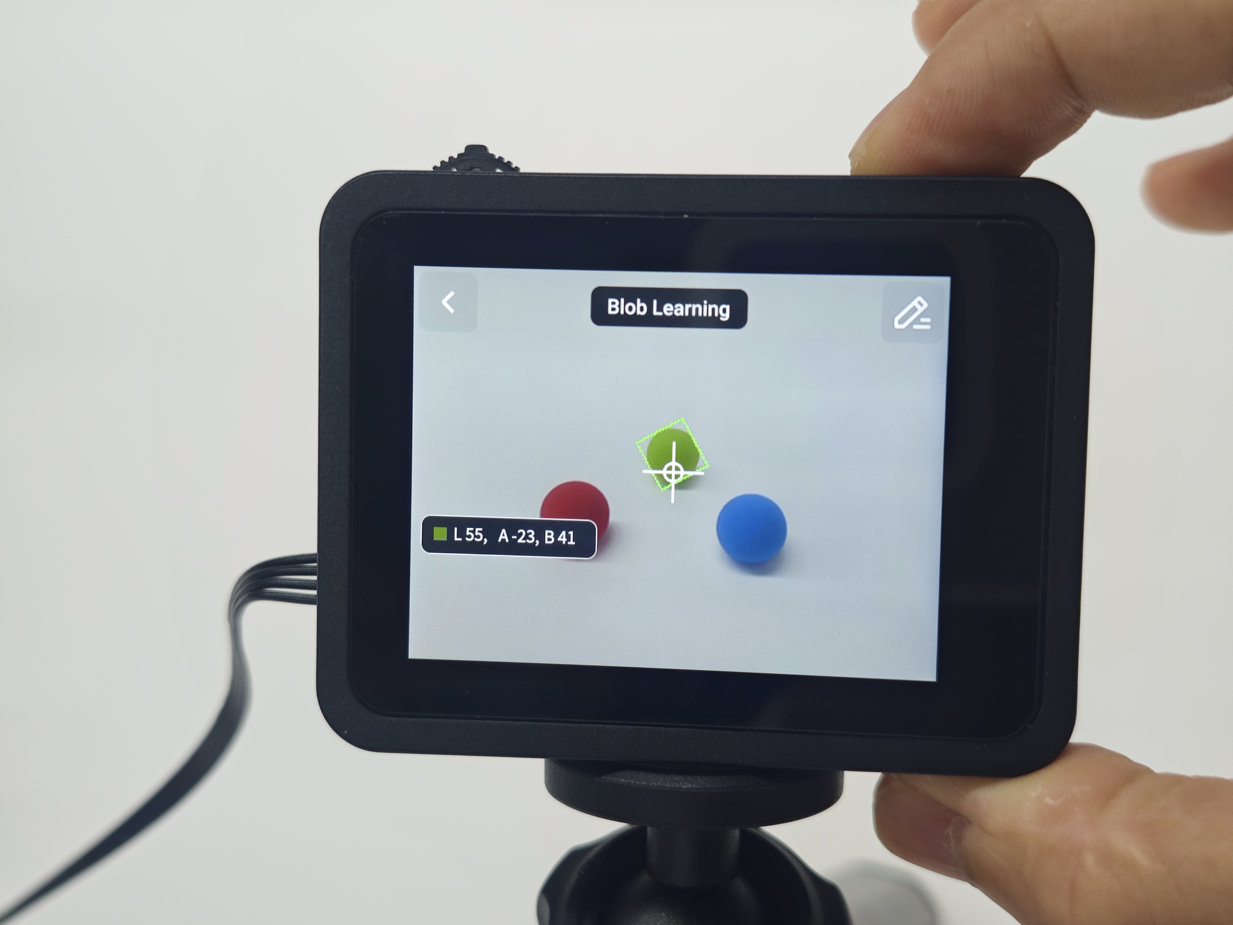

  1. Aim the cross in the center of the AI Camera 2.0 screen with the target color block. Press the Learn button or tap the color area. AI Camera 2.0 will automatically frame the block and display its L, A, and B values.
Color learning

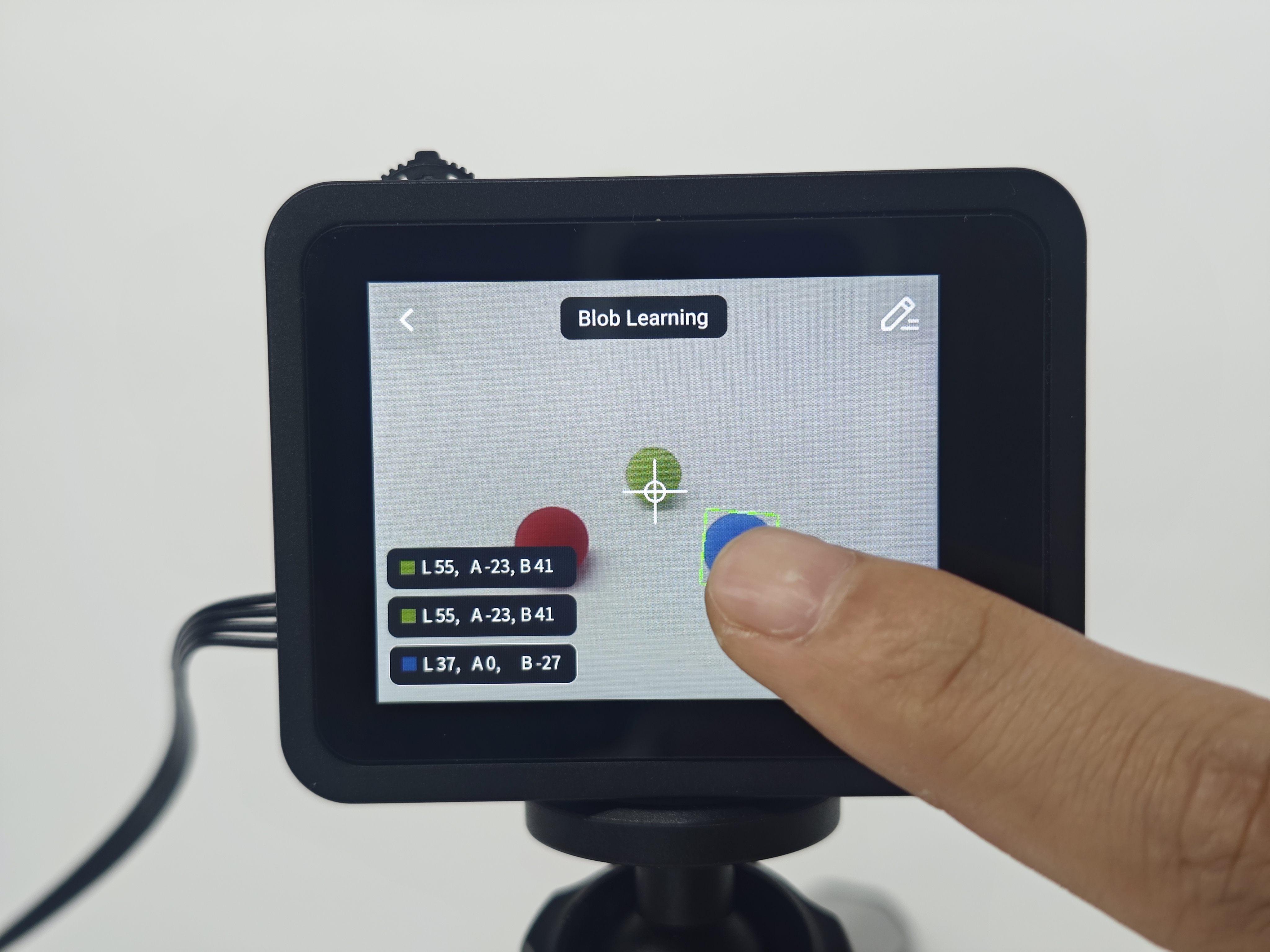

Tap the learning icon in the upper right corner, and the device will learn the color block selected in the lower left corner. The block will be marked with a green box and assigned a color block ID.
Color switching
Switch the color in the lower left corner. The device marks the new color block with a green frame and displays its color block ID.
Color deletion
Select the color block ID you want to delete in the lower right corner, then tap the forget icon in the upper right corner to remove that color.
In this example, AI Camera 2.0 can learn and recognize the colors of different balls within its field of view. Combined with LED light feedback and screen display, AI Camera 2.0 intuitively demonstrates the process from color recognition and data extraction to visual feedback.

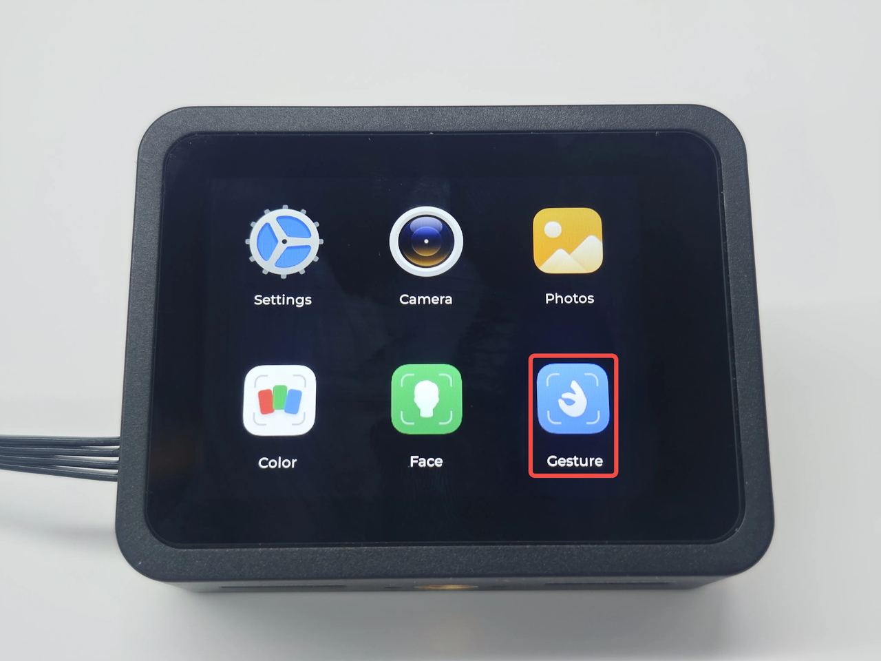

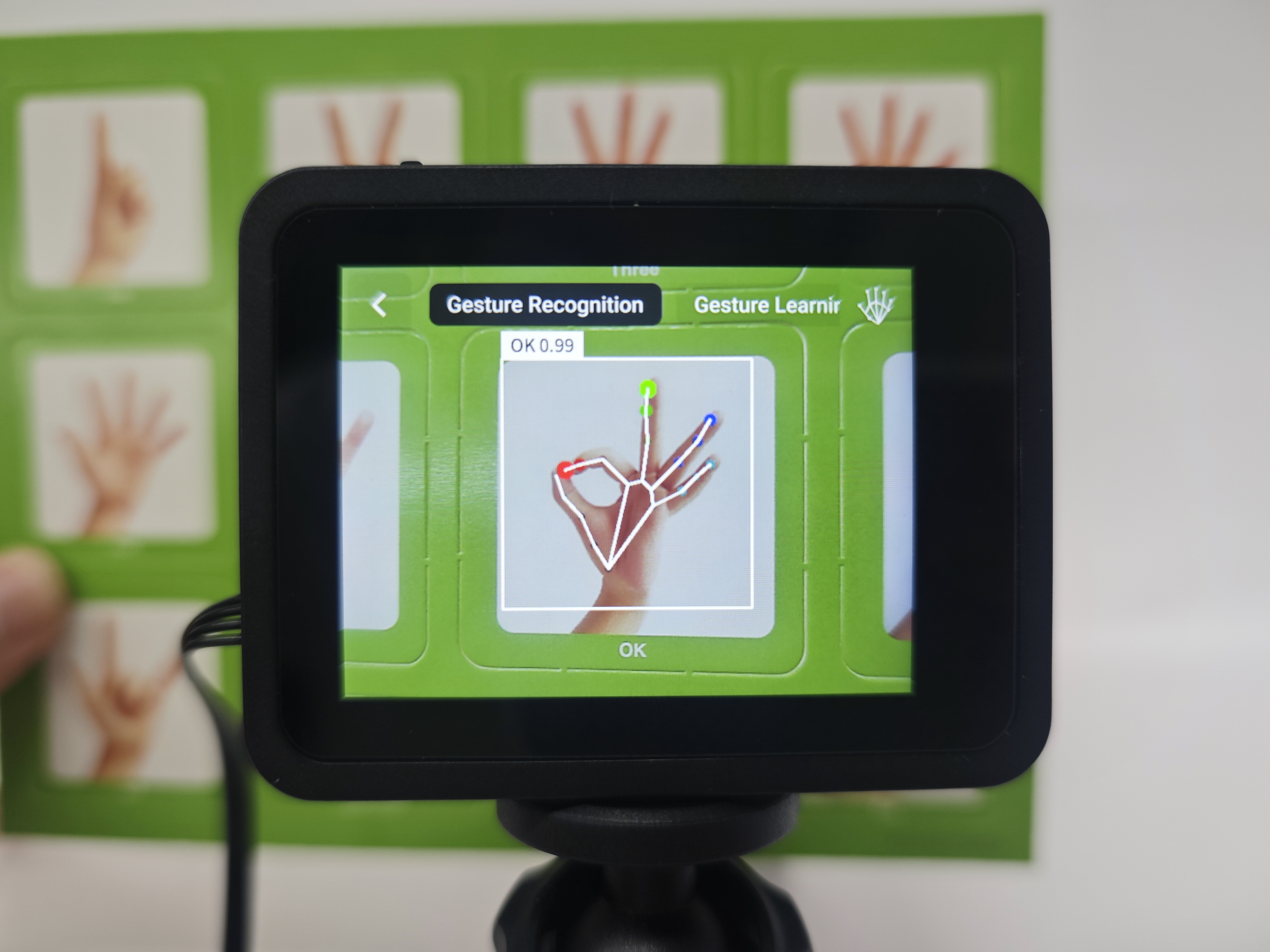

Gesture recognition
AI Camera 2.0 comes with 12 built-in gestures and recognition cards to support gesture recognition. It provides the coordinates of each key point, enabling more advanced interactive features.
In addition to gesture recognition, AI Camera 2.0 also supports gesture learning, which allows you to create fun projects such as interactive robots.
Operation steps
  1. Start the gesture recognition feature:
  • Method 1: Tap the Gesture icon on the AI Camera 2.0 screen.
  • Method 2: In mBlock’s General category, use the Start Gesture Recognition block to start the feature.

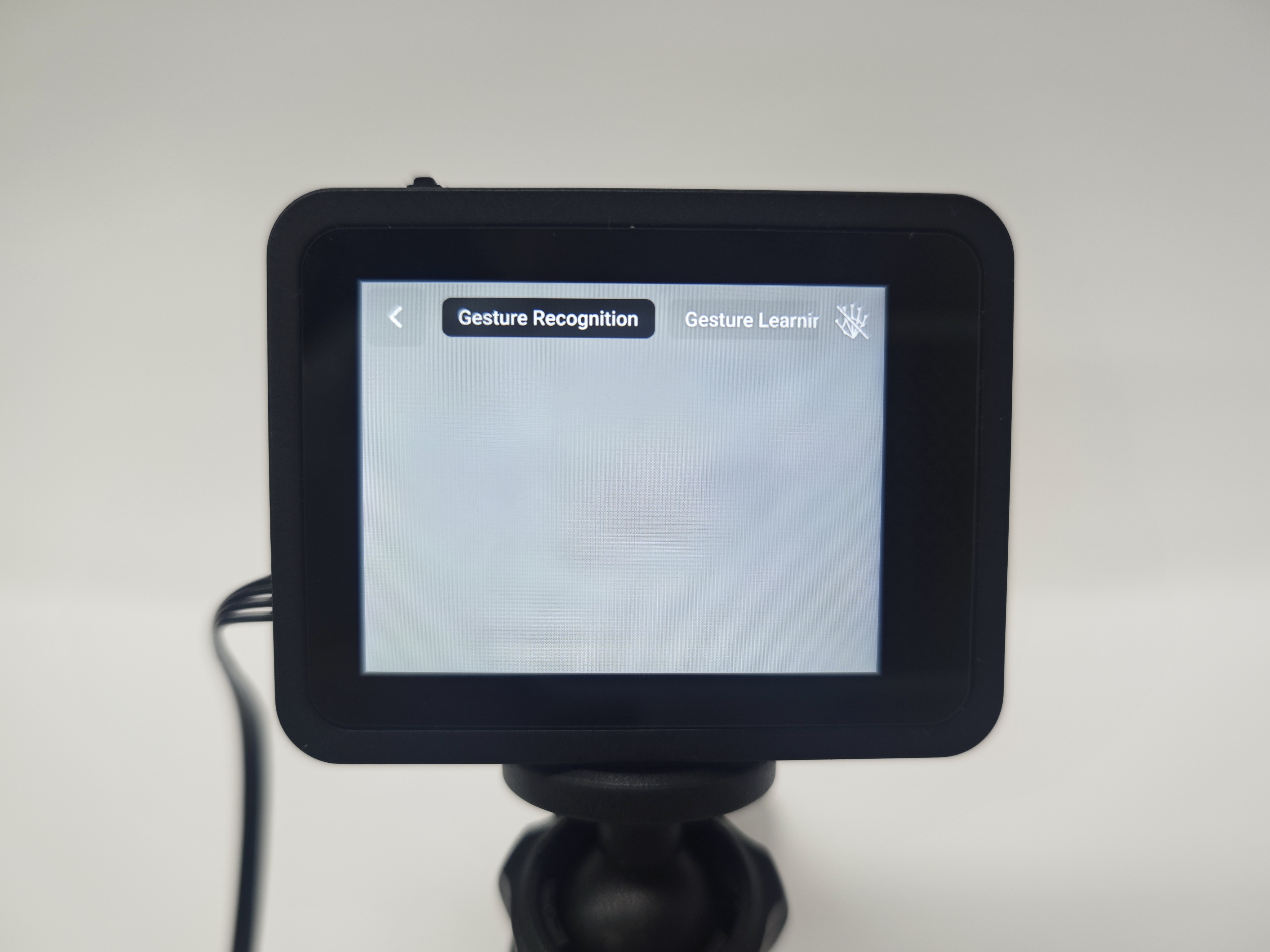

  1. Use gesture recognition features.
Gesture recognition
In Gesture Recognition mode, AI Camera 2.0 can detect multiple gestures and display a hand keypoint map. You can turn keypoint detection on or off by tapping the upper-right corner icon.

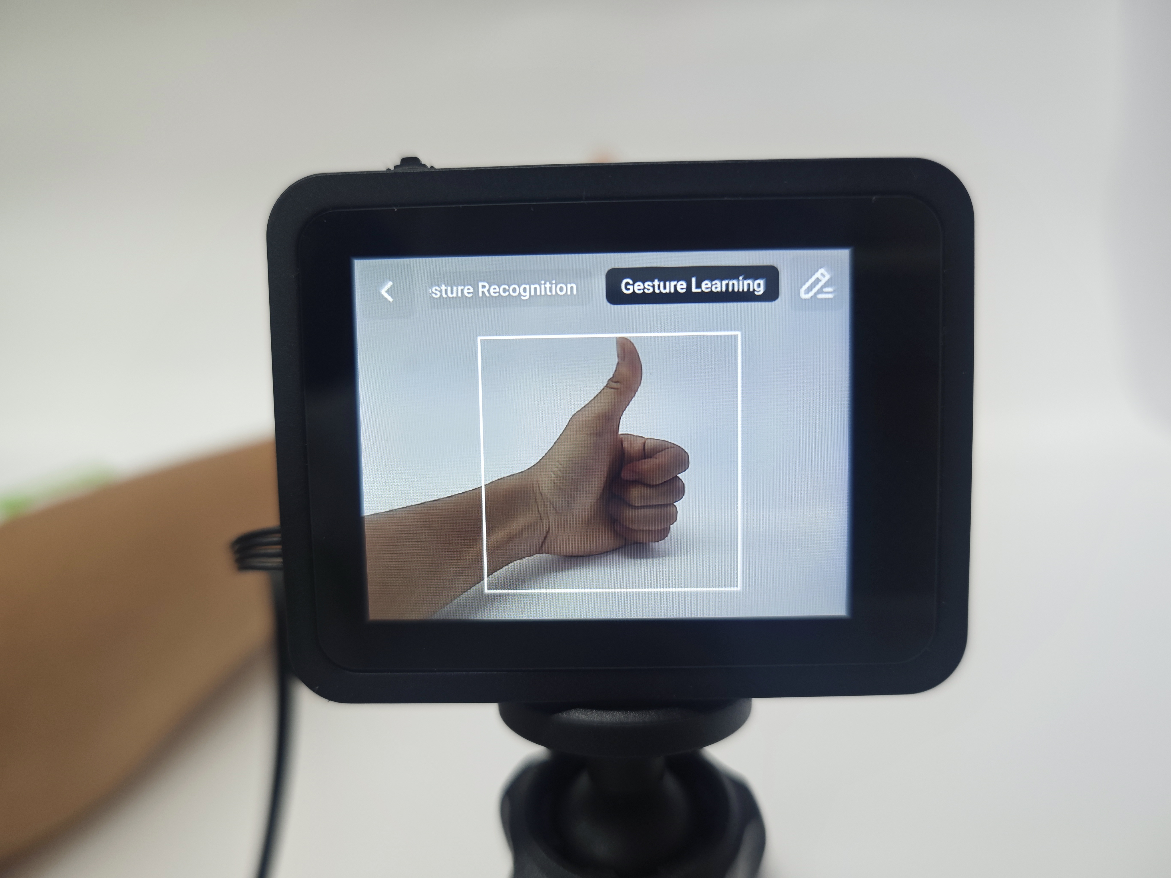

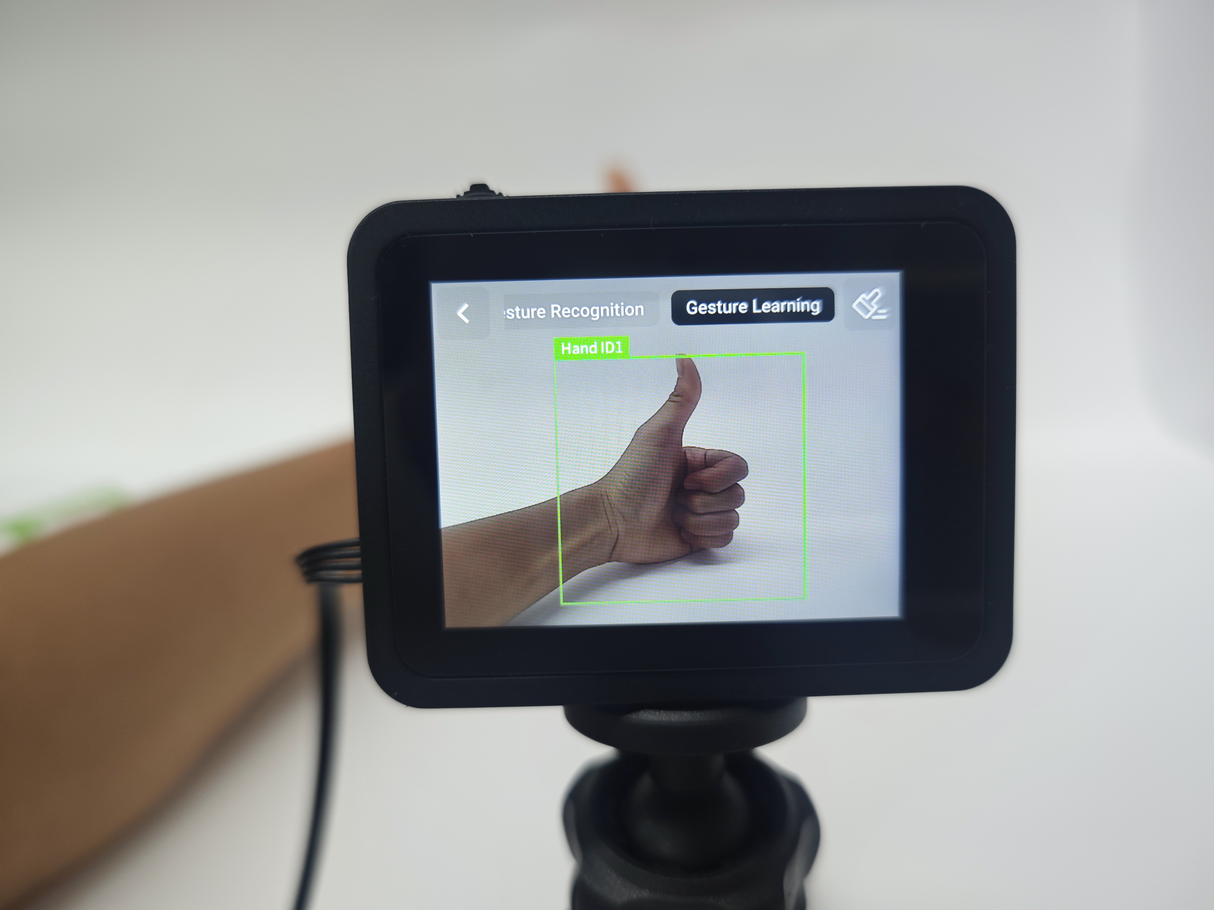

Gesture learning
When AI Camera 2.0 detects a new gesture, a white box will appear. Press the Learn button on the device or tap the learning icon to save it. When the same gesture is detected again, AI Camera 2.0 will show a green box and the stored name (e.g., Hand ID1).
Gesture deletion
Make the gesture you want to delete and press the Learn button or tap the forget icon. The screen will prompt Confirm to forget?. Tap Confirm to delete the gesture.

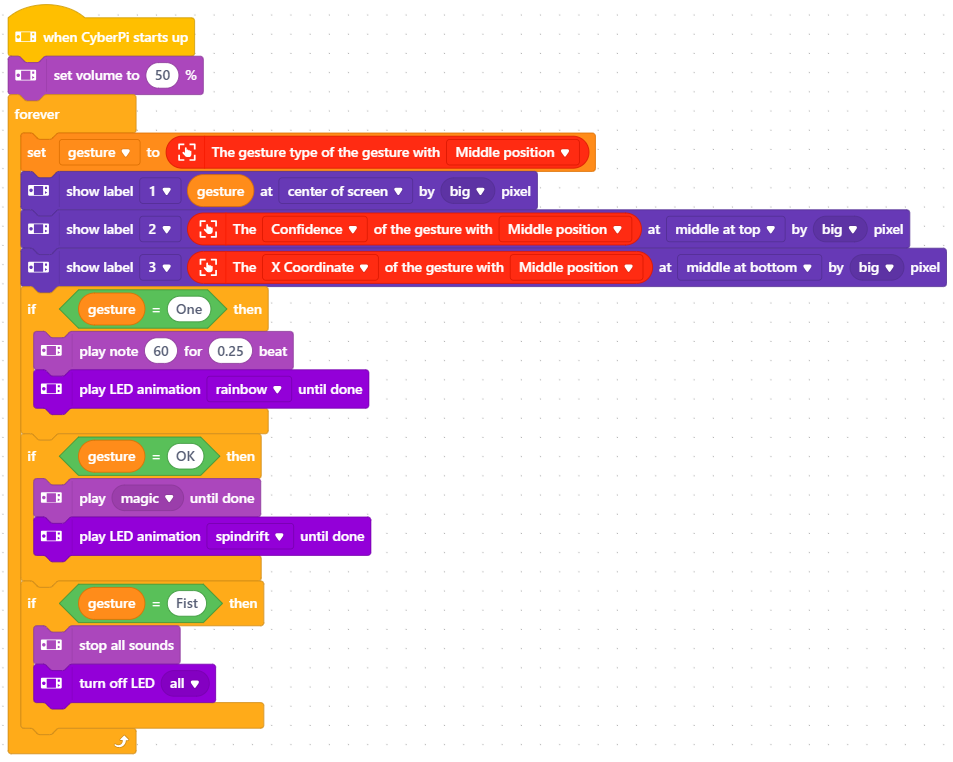

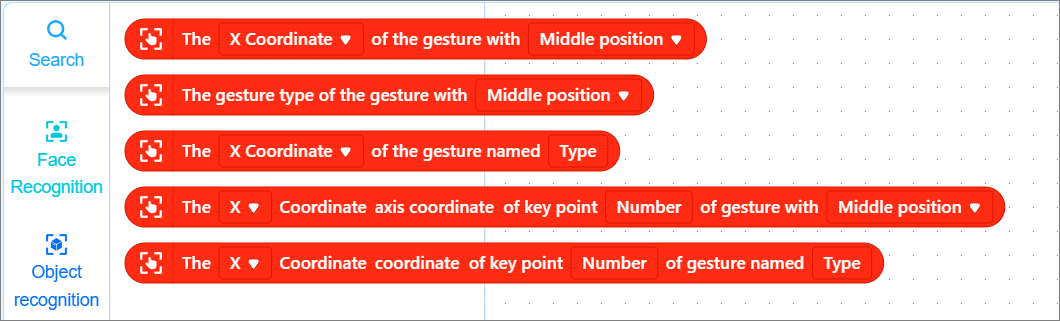

Gesture recognition blocks
In this example, AI Camera 2.0 recognizes multiple gestures in real time in Gesture Recognition mode. Combined with on-screen display, LED lighting, and sound feedback, AI Camera 2.0 demonstrates the interaction process from gesture recognition and data extraction to multisensory interaction.

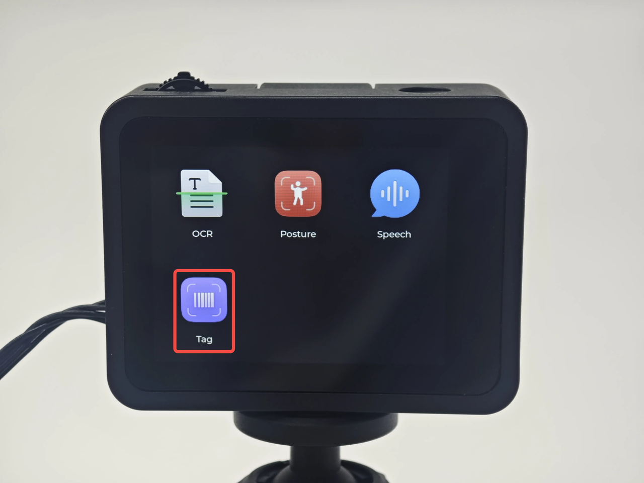

  1. Start the tag recognition feature:
  • Method 1: Tap the Tag icon on the AI Camera 2.0 screen.
  • Method 2: In mBlock’s General category, use the Start Tag Recognition block to start the feature.

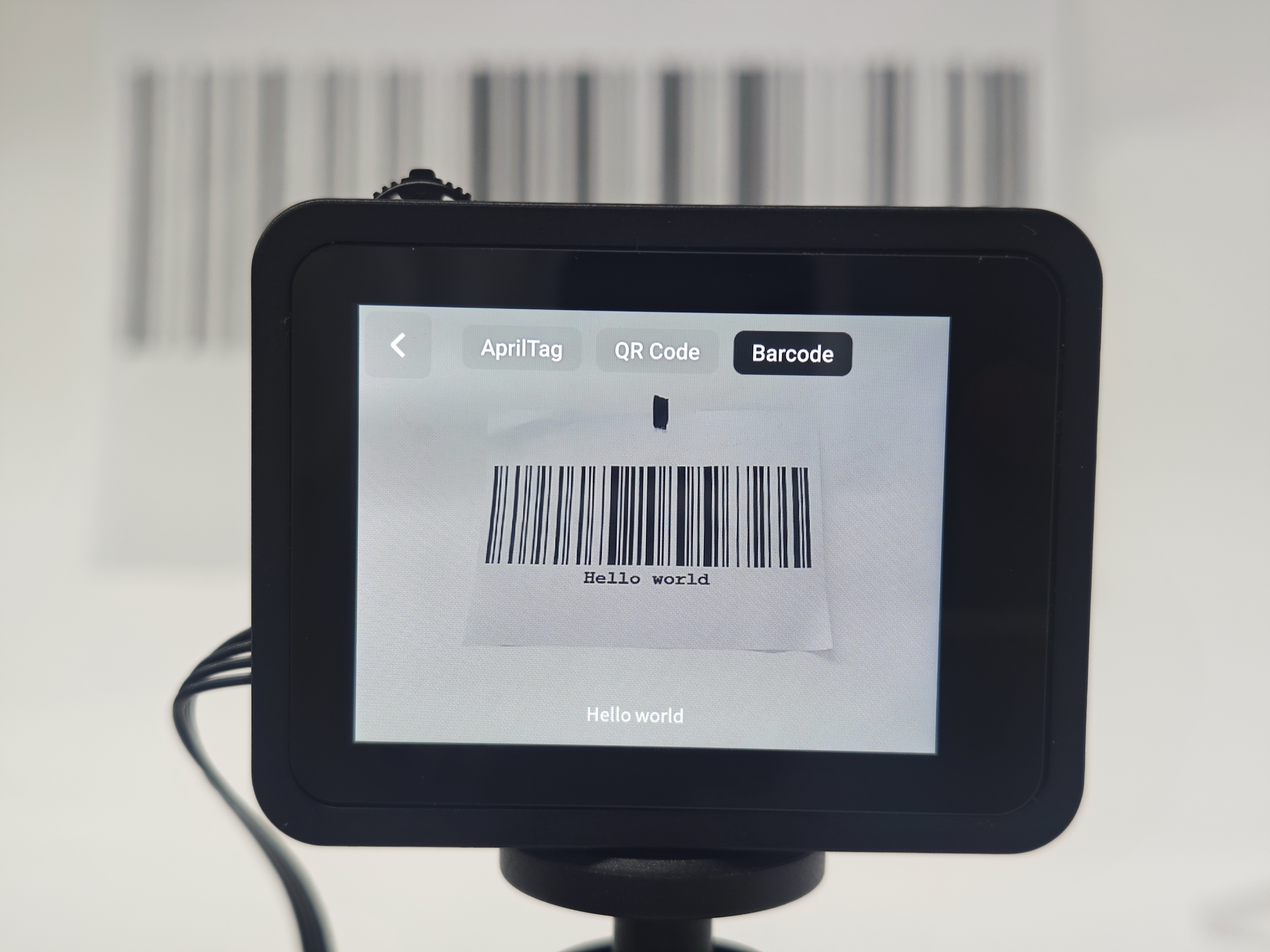

Barcode recognition
AI Camera 2.0 automatically detects barcodes in view and shows the decoded result at the bottom of the screen. It also supports recording via barcode scanners.

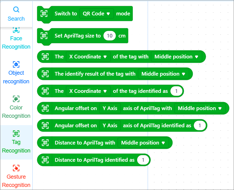

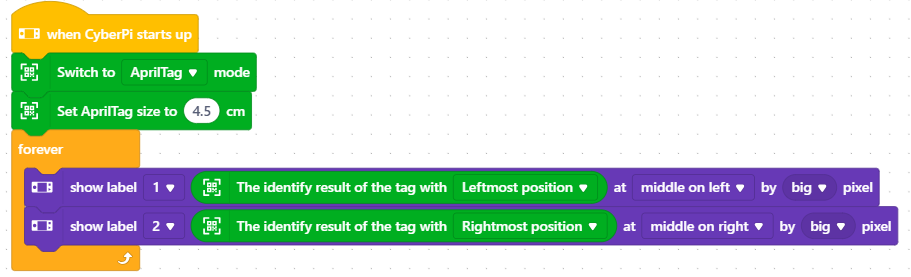

Tag recognition blocks
In this example, AI Camera 2.0 performs AprilTag recognition and spatial positioning. Combined with 3D distance calculation, angle offset, and on-screen display, AI Camera 2.0 intuitively demonstrates the perception process from visual recognition and spatial awareness to data feedback.

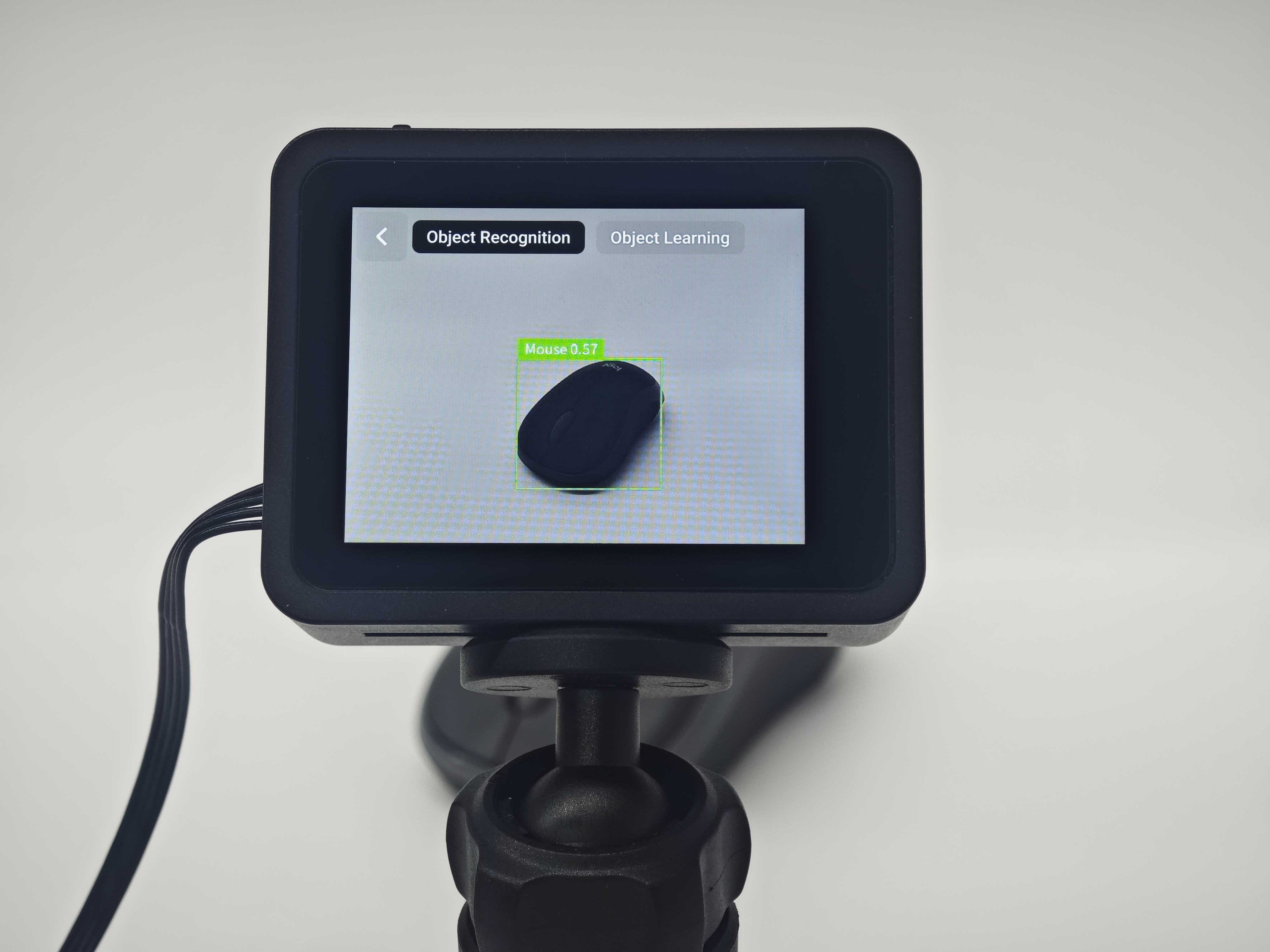

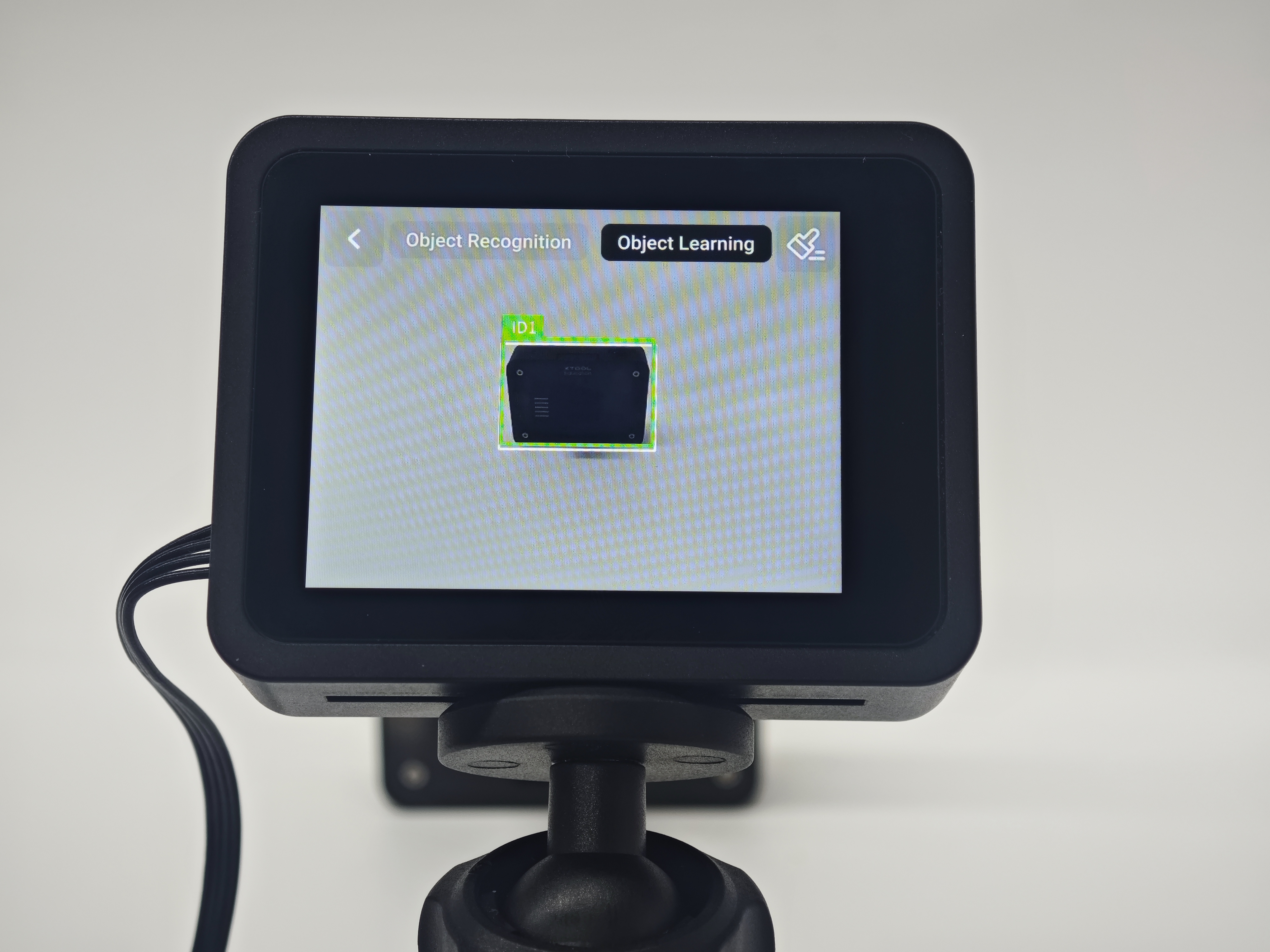

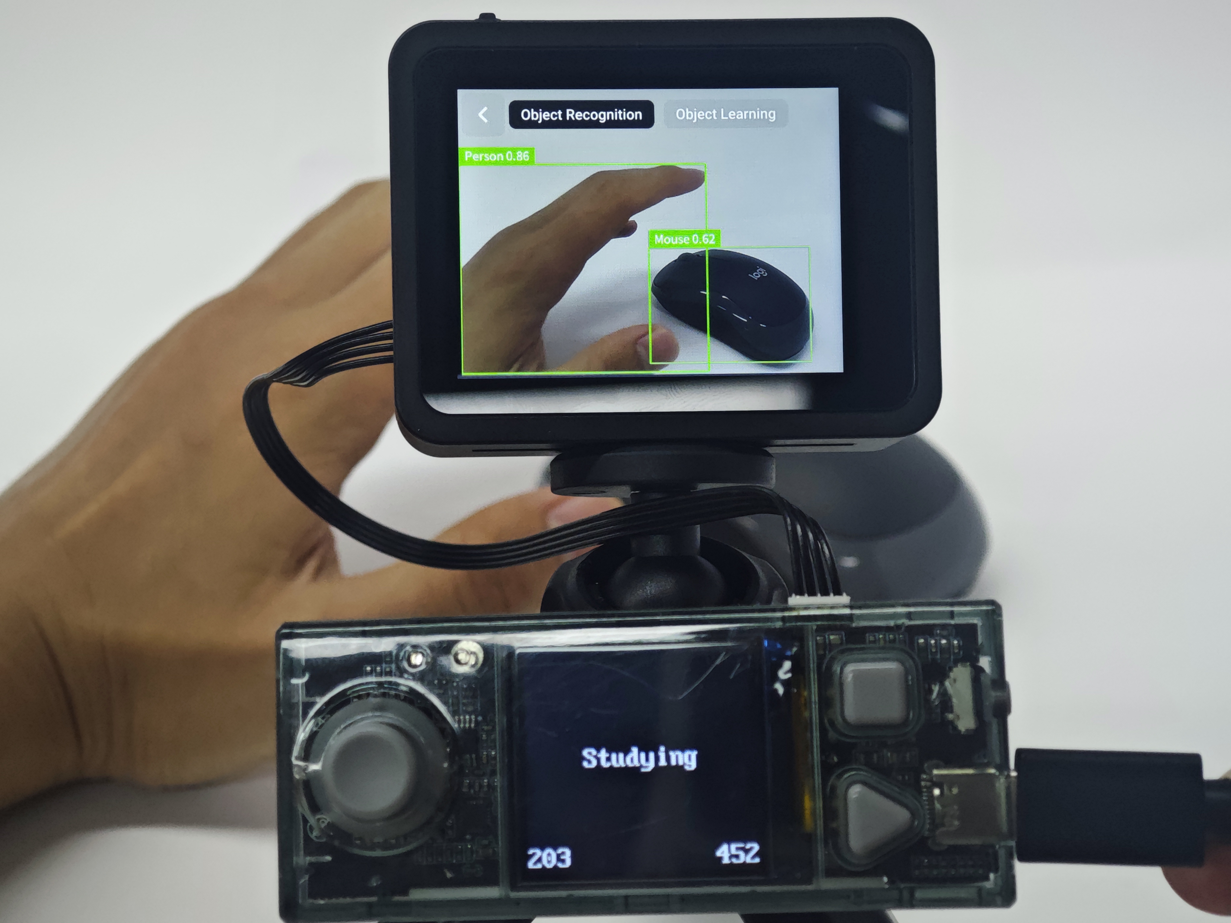

Object recognition
AI Camera 2.0 comes with a built-in large language model (LLM) and identification cards, supporting recognition of 80 types of objects. Additionally, AI Camera 2.0 can recognize the objects selected on the screen. Leveraging the object recognition feature, you can implement projects involving object classification and tracking.
Operation steps
  1. Start the object recognition feature:
  • Method 1: Tap the Object icon on the AI Camera 2.0 screen.
  • Method 2: In mBlock’s General category, use the Start Item Recognition block to start the feature.
  1. Use object recognition features.
Object recognition
Select Object Recognition and AI Camera 2.0 will mark the detected object with a green frame and display its name.

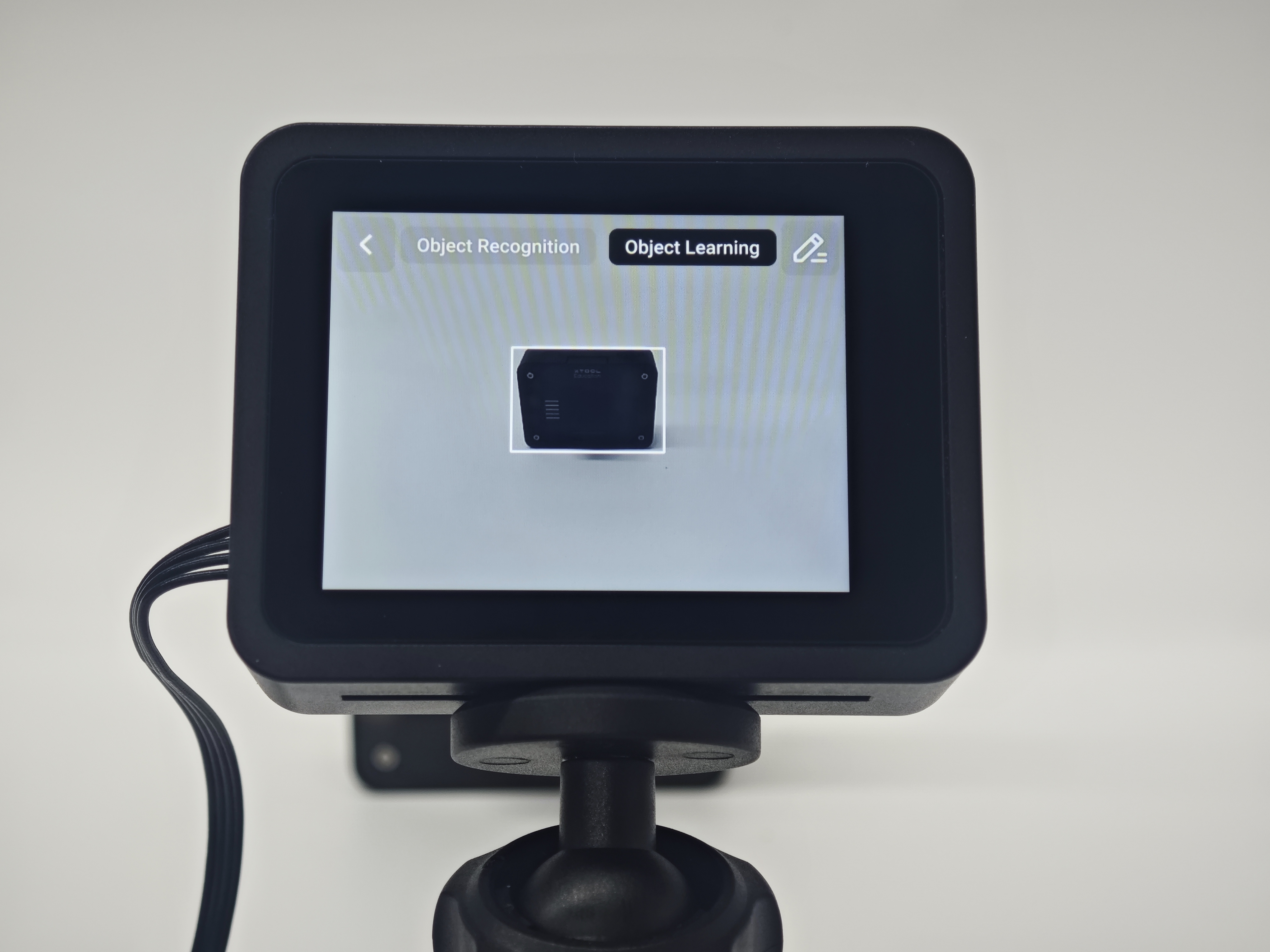

Object learning
Align the white box frame with the object, then press the Learn button or tap the learning icon to complete learning.
When a learned object is detected again, AI Camera 2.0 will display a green box and the recorded name, such as ID1 in this example.
Object deletion
Align the white box frame with the target object, press the Learn button or tap the forget icon in the upper right corner. The screen will prompt Confirm to forget?. Tap Confirm to delete the object.

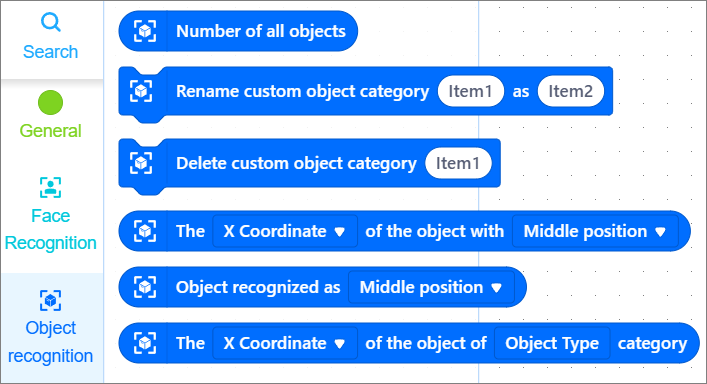

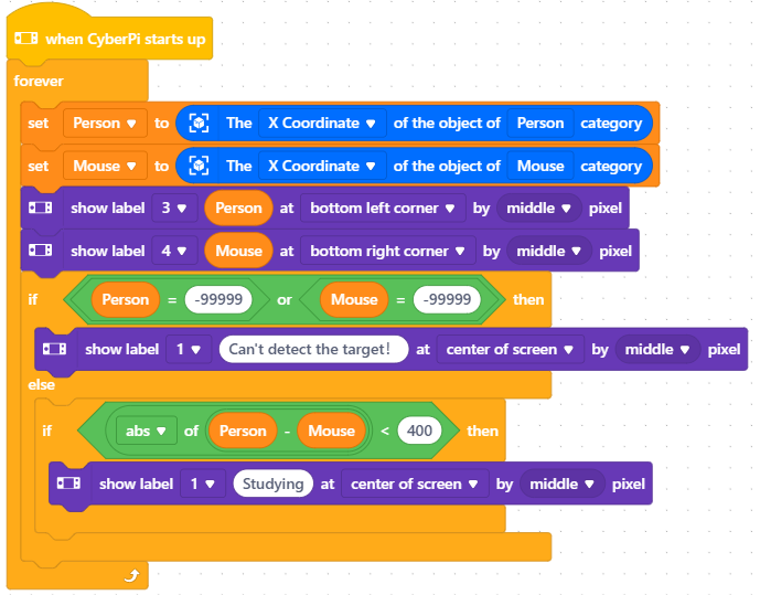

Object recognition blocks
By using AI Camera 2.0 to recognize objects and identify coordinates, you can specify the conditions for determining whether different objects are close. In the following example, AI Camera 2.0 is used to determine whether a person and a mouse are close by acquiring their respective positions.

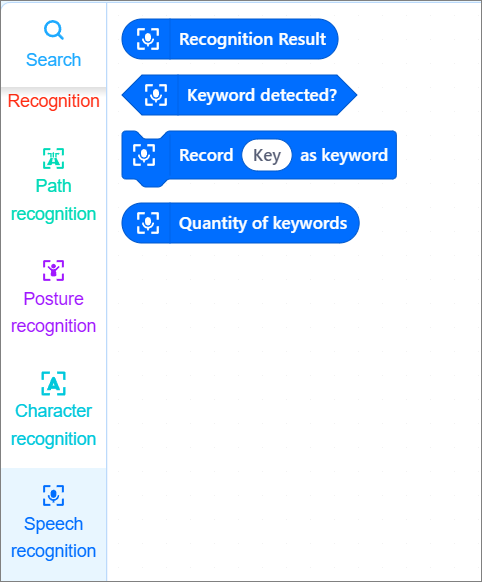

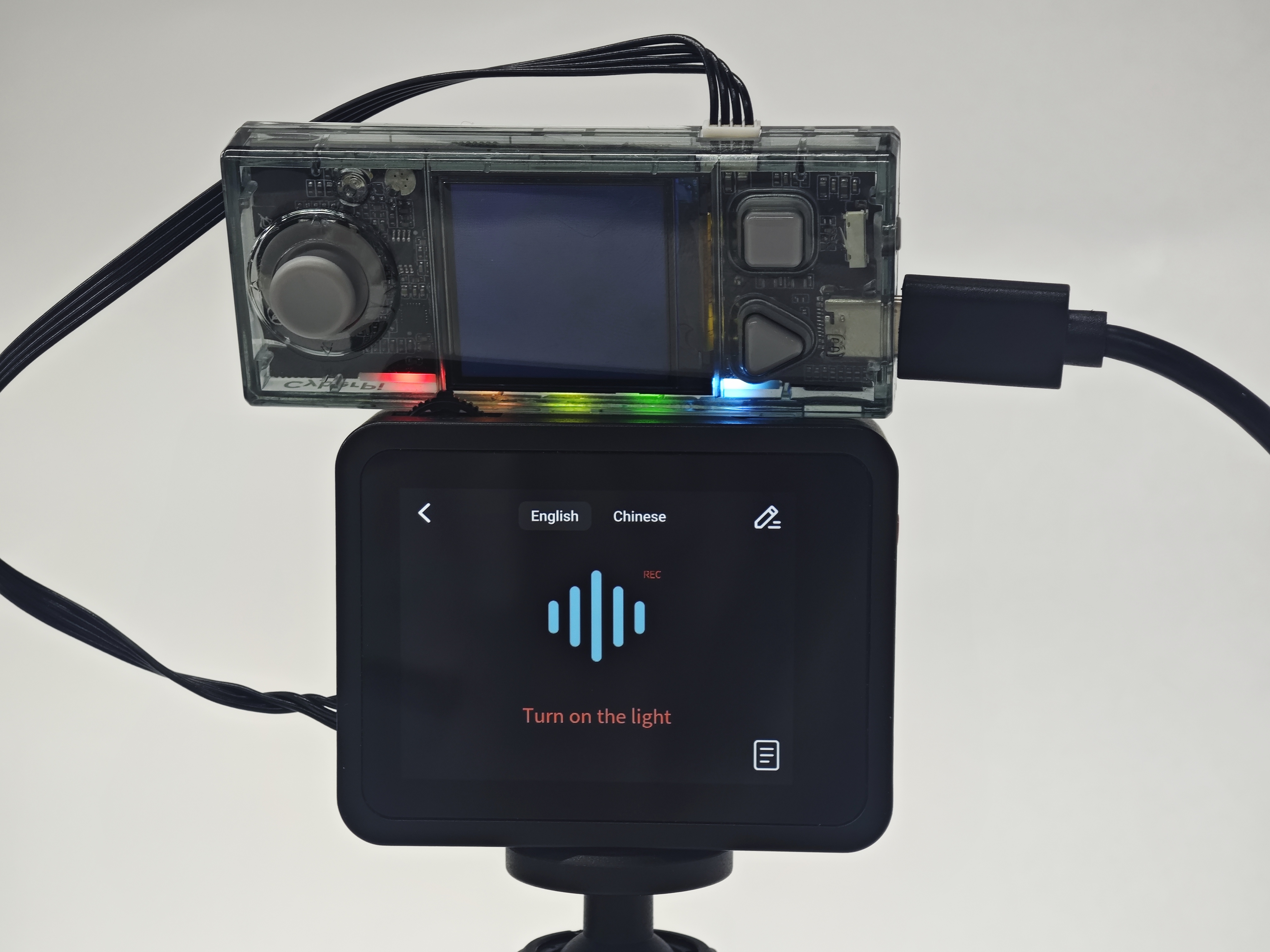

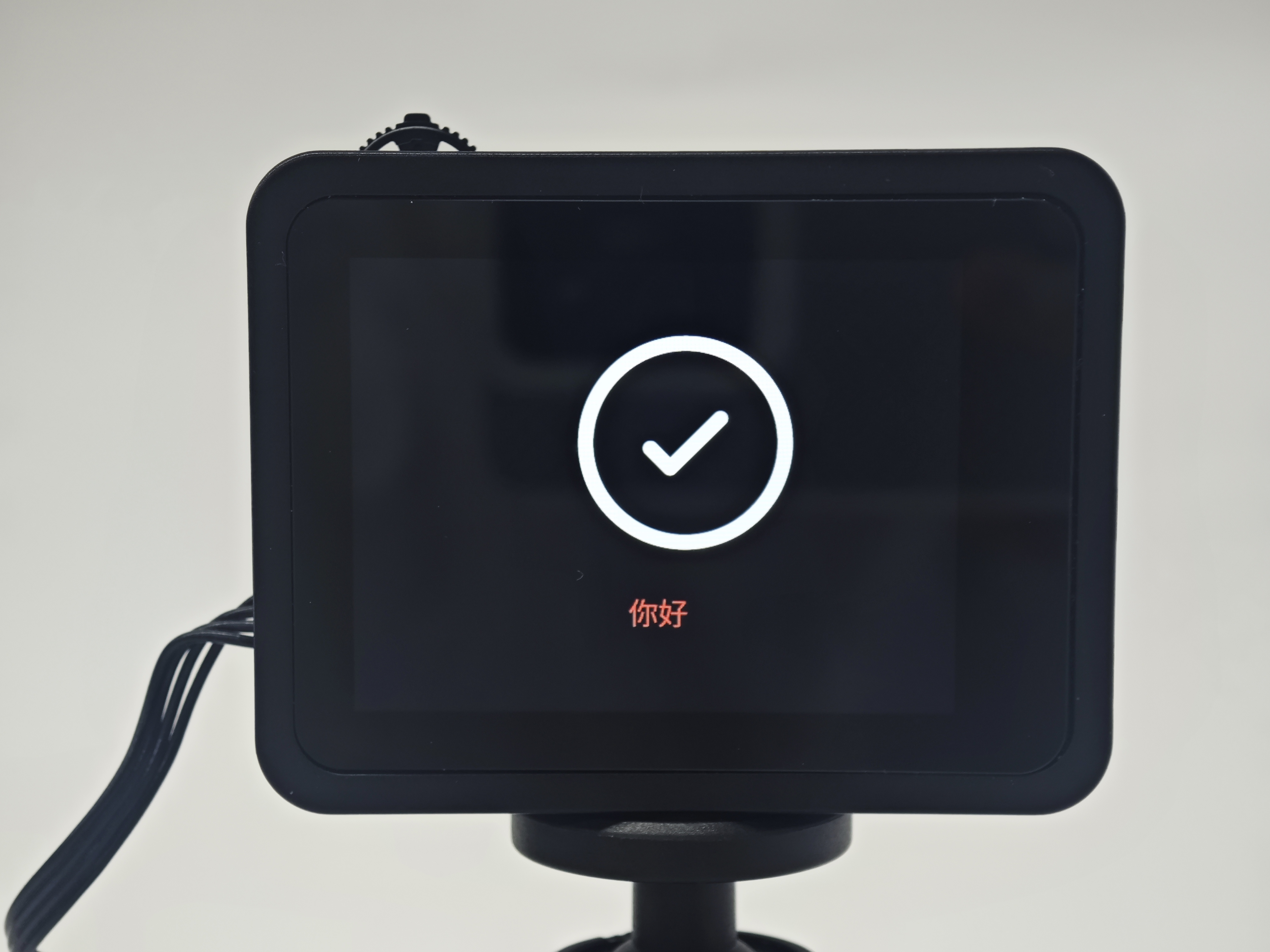

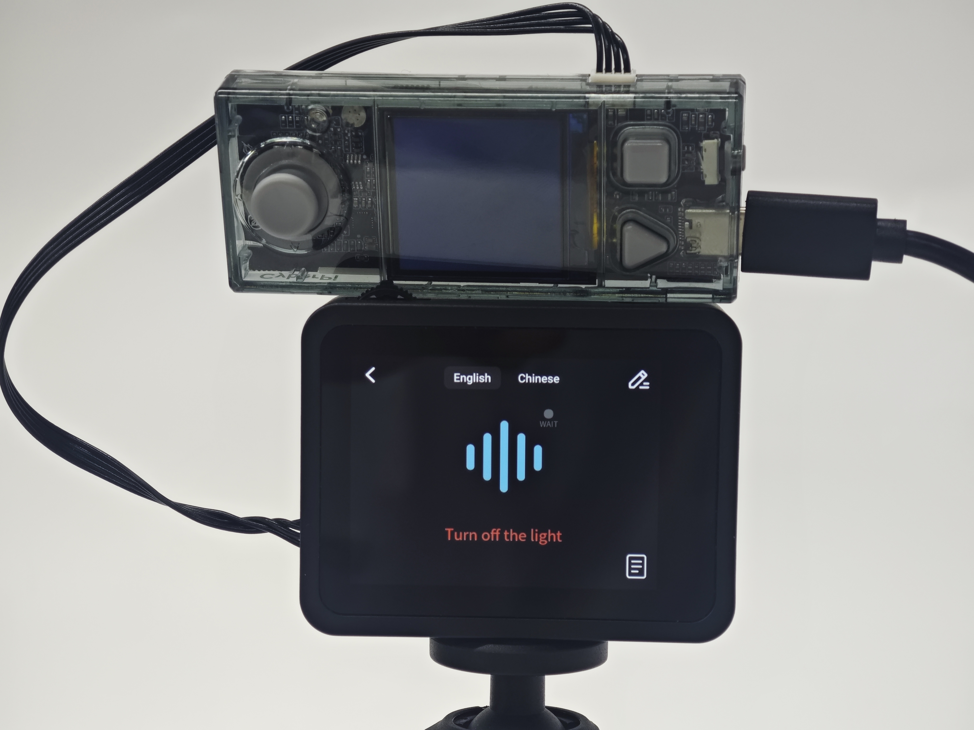

Speech recognition
AI Camera 2.0 supports Chinese and English speech recognition. With this feature, you can create projects such as a voice assistant.
Operation steps
  1. Start the speech recognition feature:
  • Method 1: Tap the Speech icon on the AI Camera 2.0 screen.
  • Method 2: In mBlock’s General category, use the Start Speech Recognition block to start the feature.
  1. Use speech recognition features.

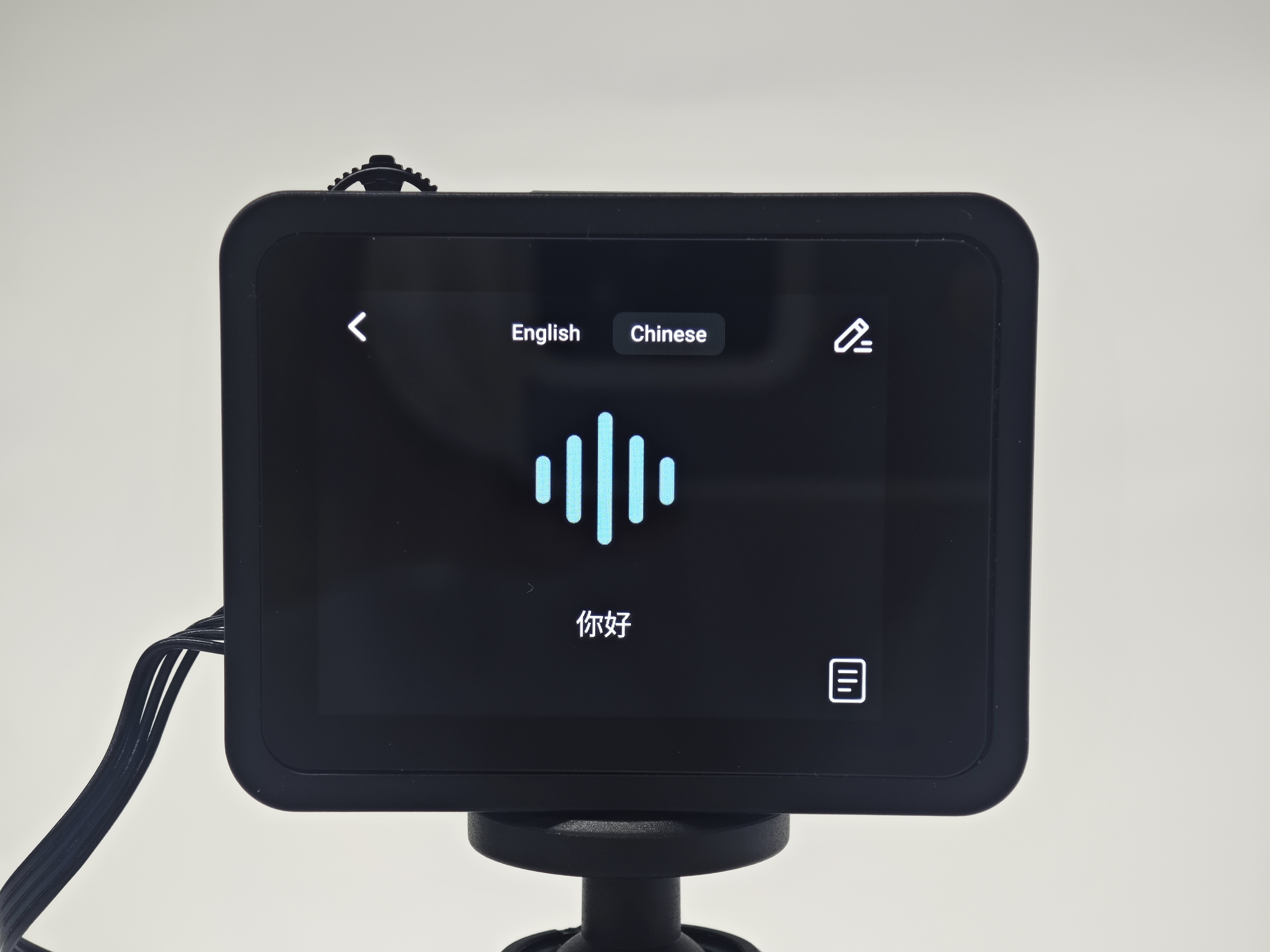

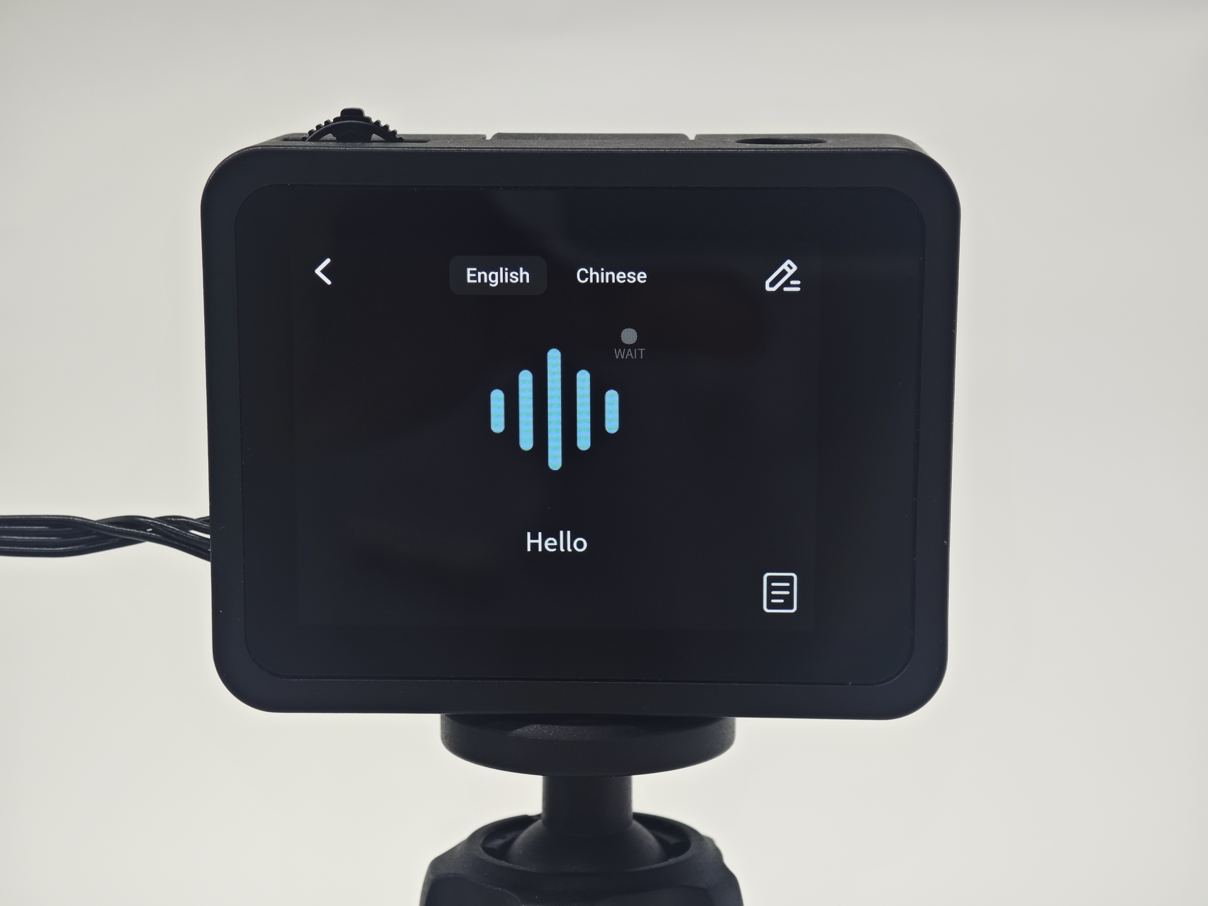

Speech recognition
In English or Chinese mode, speak in the selected language. AI Camera 2.0 will recognize your speech and display the detected text in English or Chinese at the bottom of the screen.

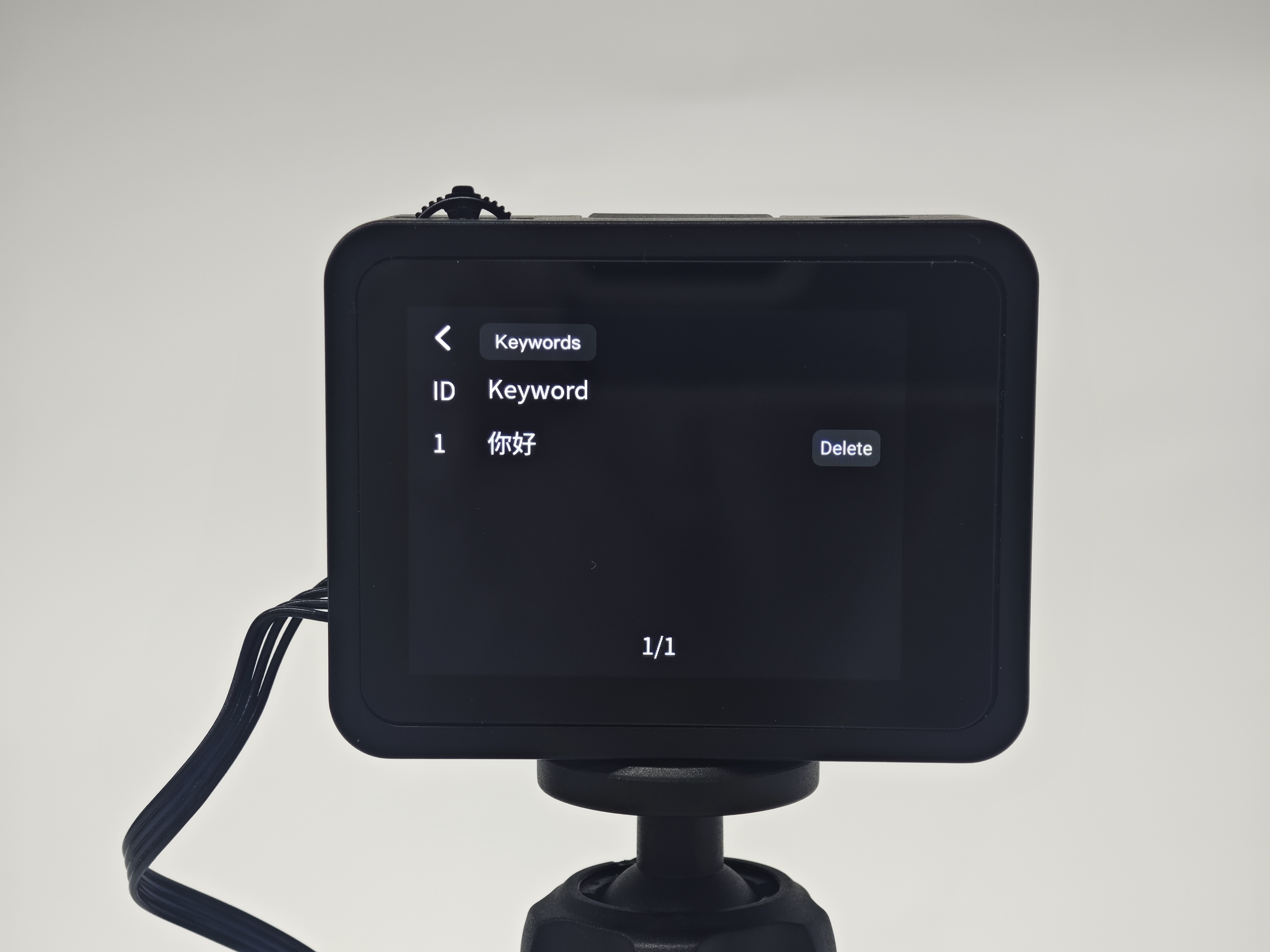

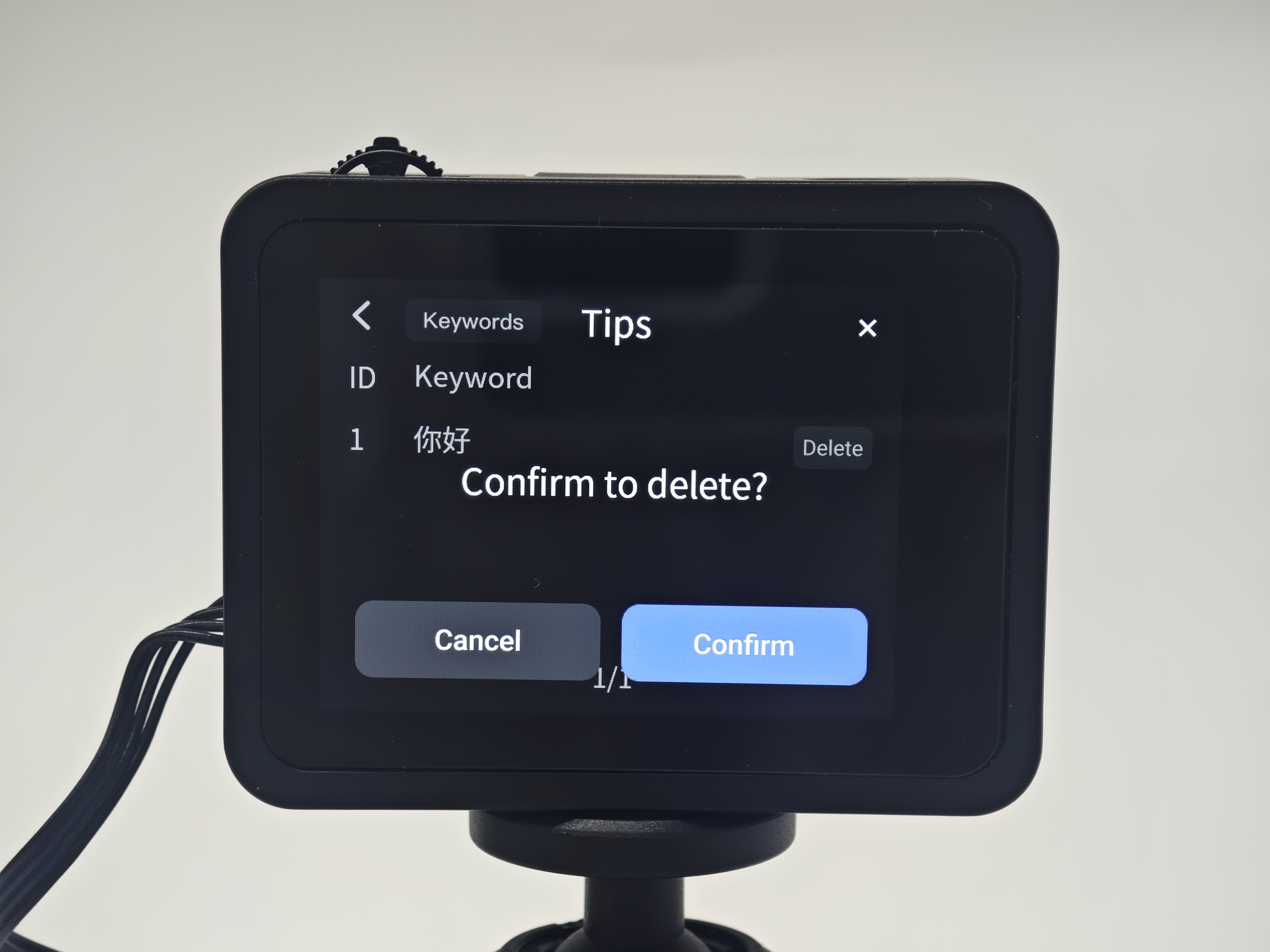

Speech learning
After a word or phrase is recognized, press the Learn button or tap the learning icon in the upper-right corner to save it. Tap the list in the lower right corner to view stored words.
Speech deletion
Tap the Delete icon next to a saved word. The screen will prompt Confirm to delete?. Tap Confirm to delete the word.
Speech recognition blocks
In this example, AI Camera 2.0 recognizes the keywords Turn on the light and Turn off the light. Combined with LED light feedback, this example demonstrates the process from speech recognition and command response to visual interaction.

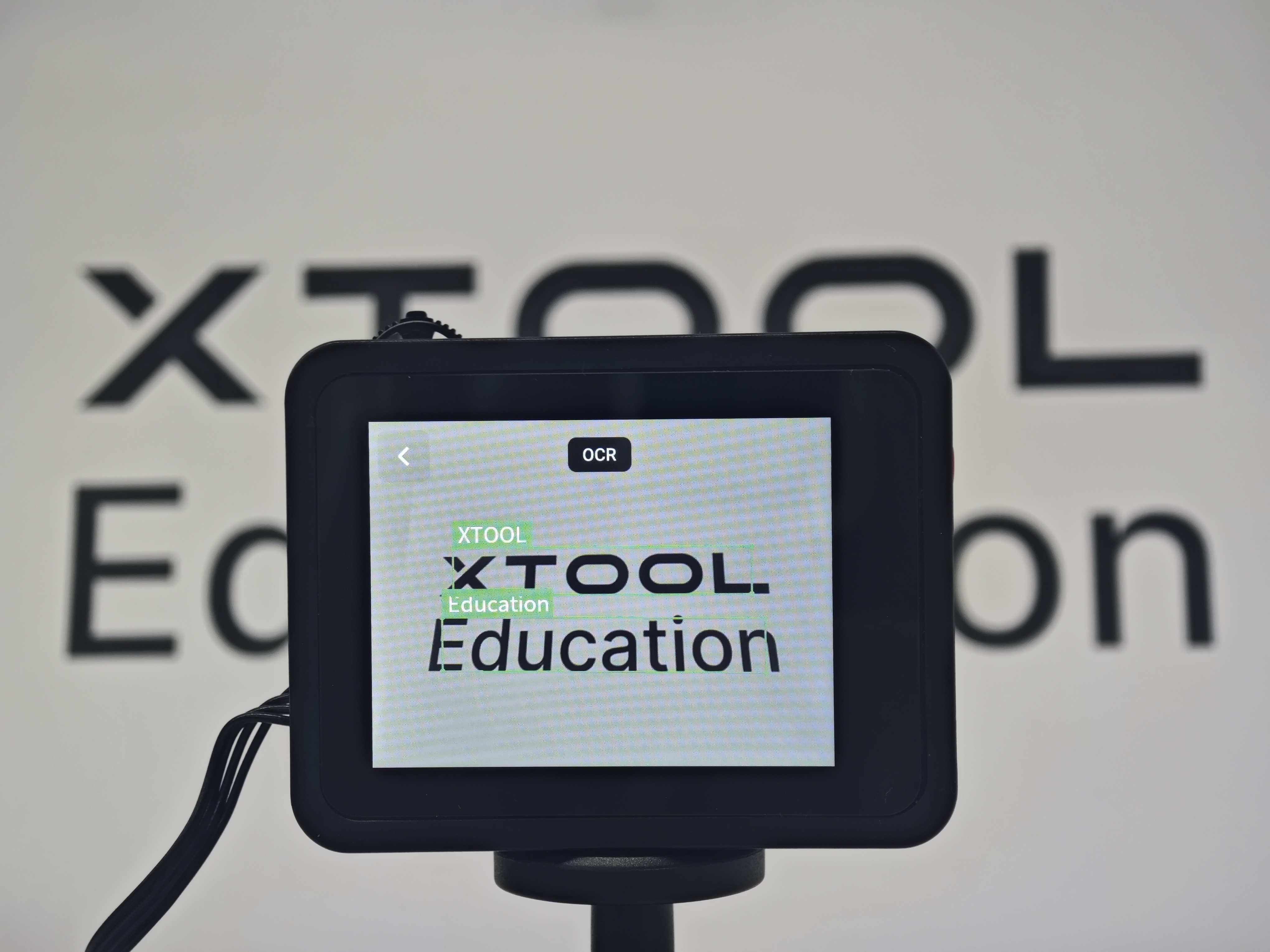

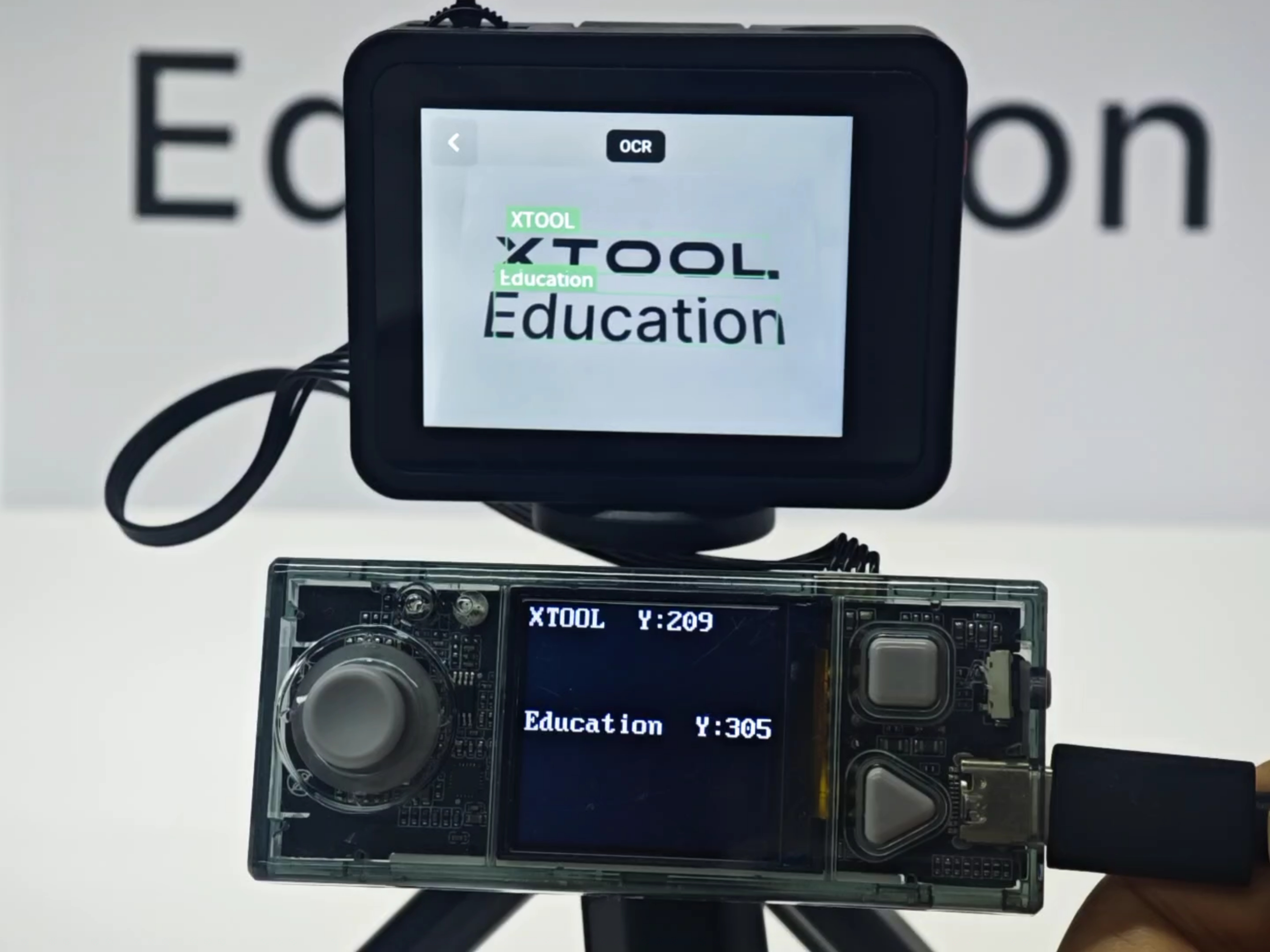

Character recognition
AI Camera 2.0 supports character recognition (or OCR) of both Chinese and English. With this feature, you can create projects such as a smart parking system.
Operation steps
  1. Start the character recognition feature:
  • Method 1: Tap the OCR icon on the AI Camera 2.0 screen.
  • Method 2: In mBlock’s General category, use the Start OCR block to start the feature.
  1. Use the character recognition feature. AI Camera 2.0 highlights detected Chinese or English characters with a green box, and the recognized text will be displayed in the upper-left corner of the box.

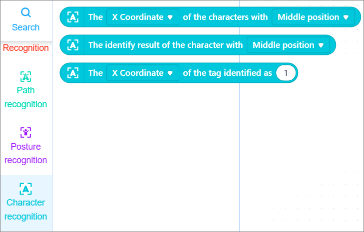

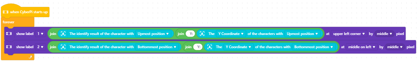

Character recognition blocks
In this example, AI Camera 2.0 recognizes characters in real time and determines its coordinates, which can be applied to smart parking projects.

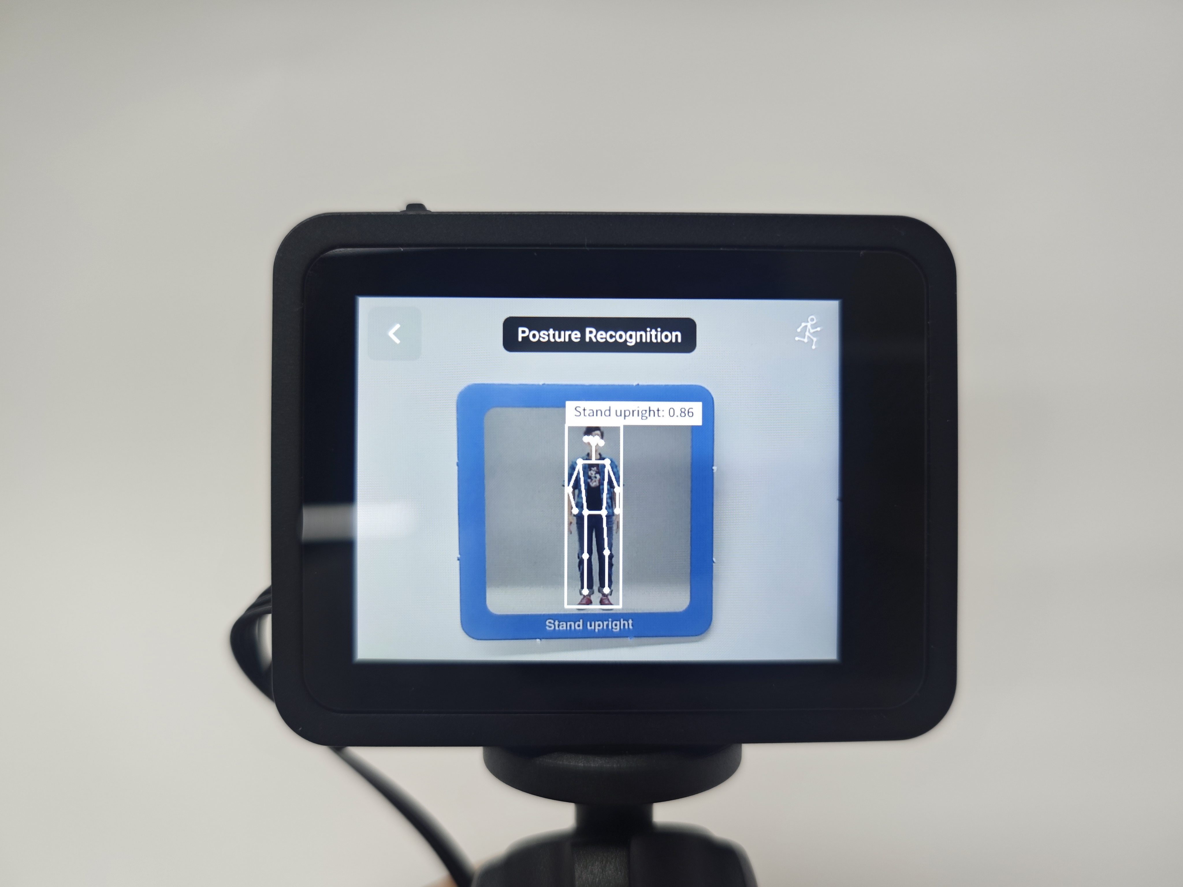

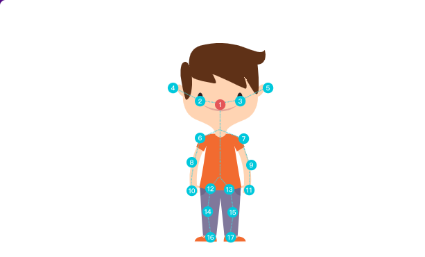

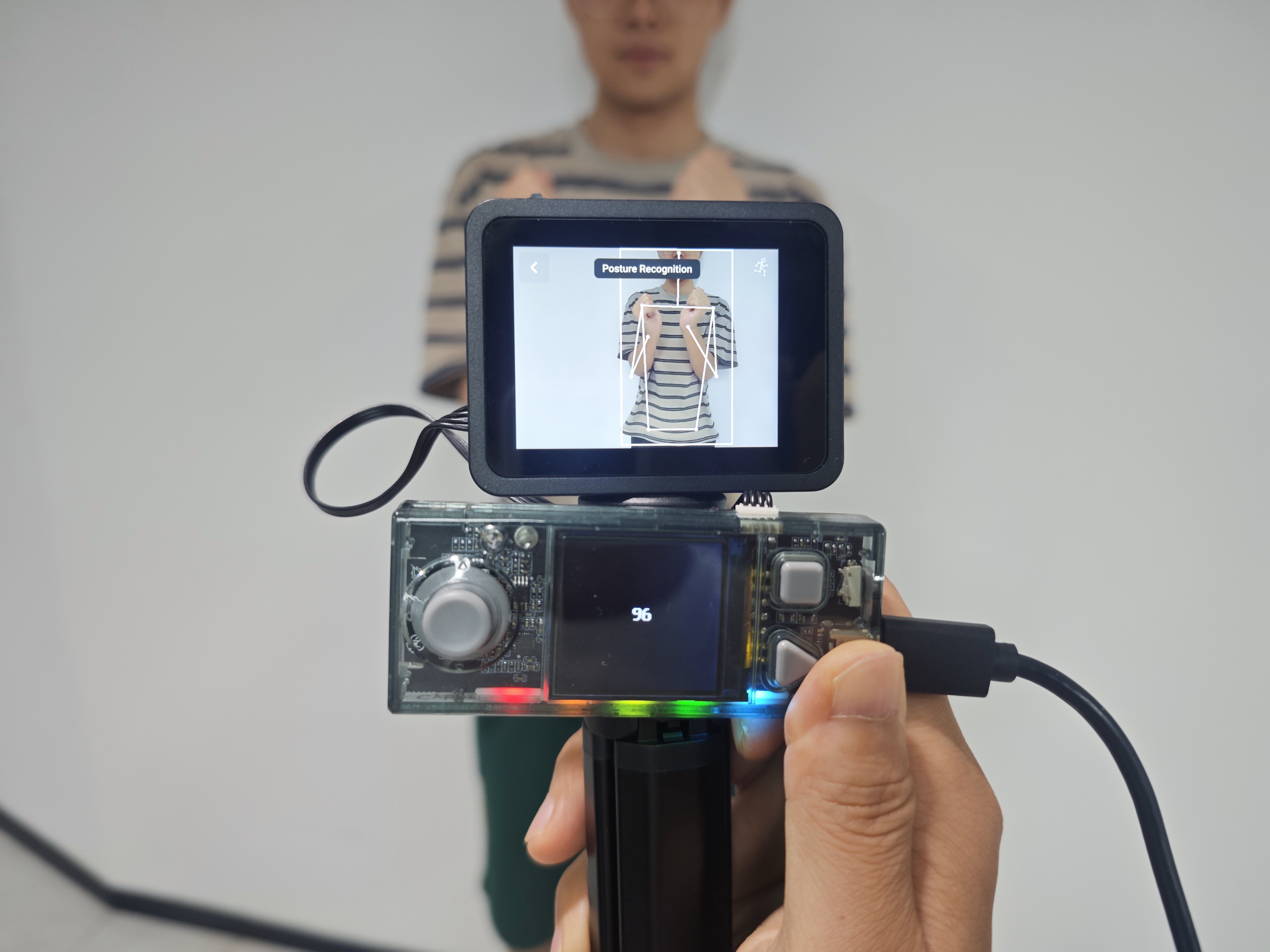

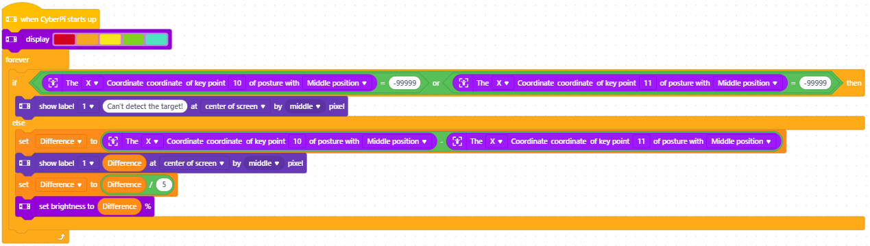

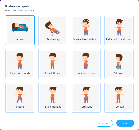

Posture recognition
AI Camera 2.0 comes with 12 built-in postures and recognition cards. The posture recognition feature provides the coordinates of each key point, enabling more precise interaction. With this feature, you can create motion-sensing robot projects, similar to the robots in the movie Real Steel.
Operation steps
  1. Start the posture recognition feature:
  • Method 1: Tap the Posture icon on the AI Camera 2.0 screen.
  • Method 2: In mBlock’s General category, use the Start Posture Recognition block to start the feature.

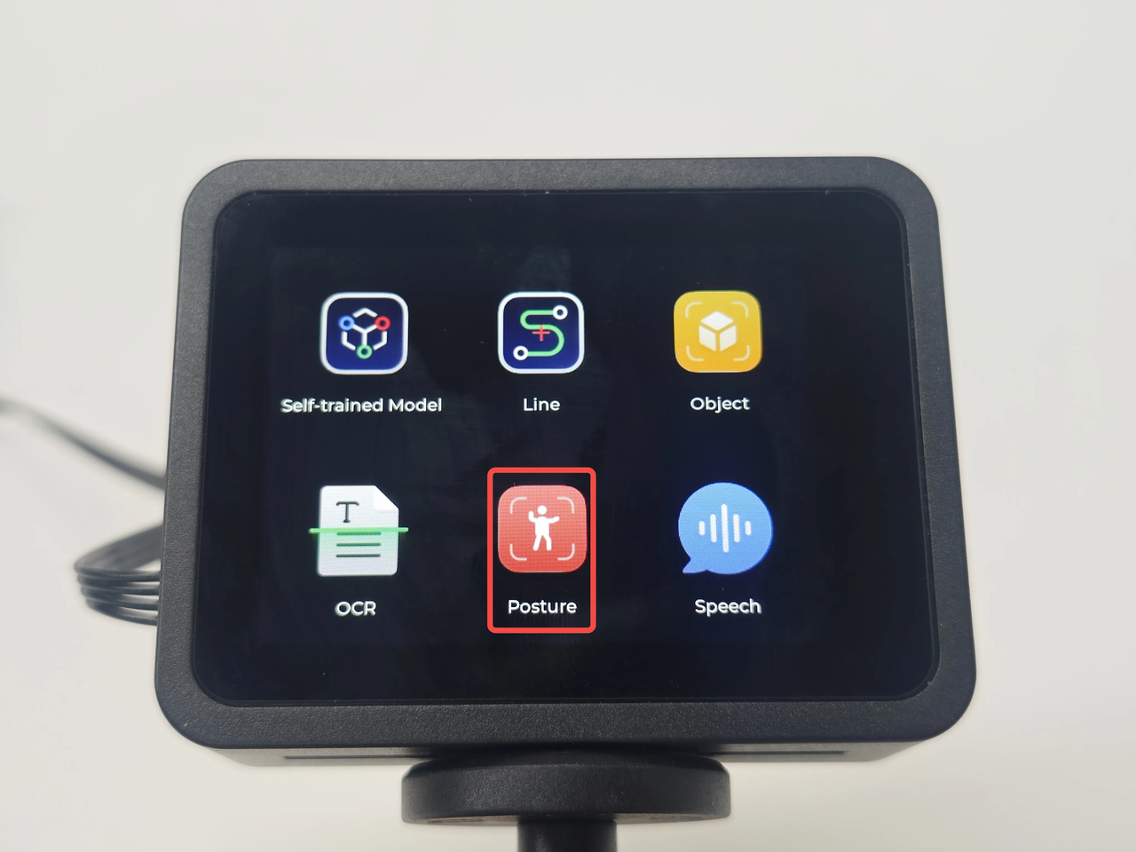

  1. Use the posture recognition feature. Select Posture Recognition. AI Camera 2.0 can recognize 12 common postures and display a human skeleton model. You can turn skeleton point detection on or off by tapping the human icon in the upper-right corner.

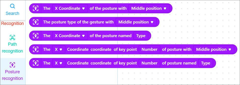

Posture recognition blocks
Recognizable postures
In this example, AI Camera 2.0 captures the X-coordinates of both hands in real time by using posture keypoints. By adjusting LED brightness based on the horizontal distance, it demonstrates the process from motion capture and data processing to interactive feedback.

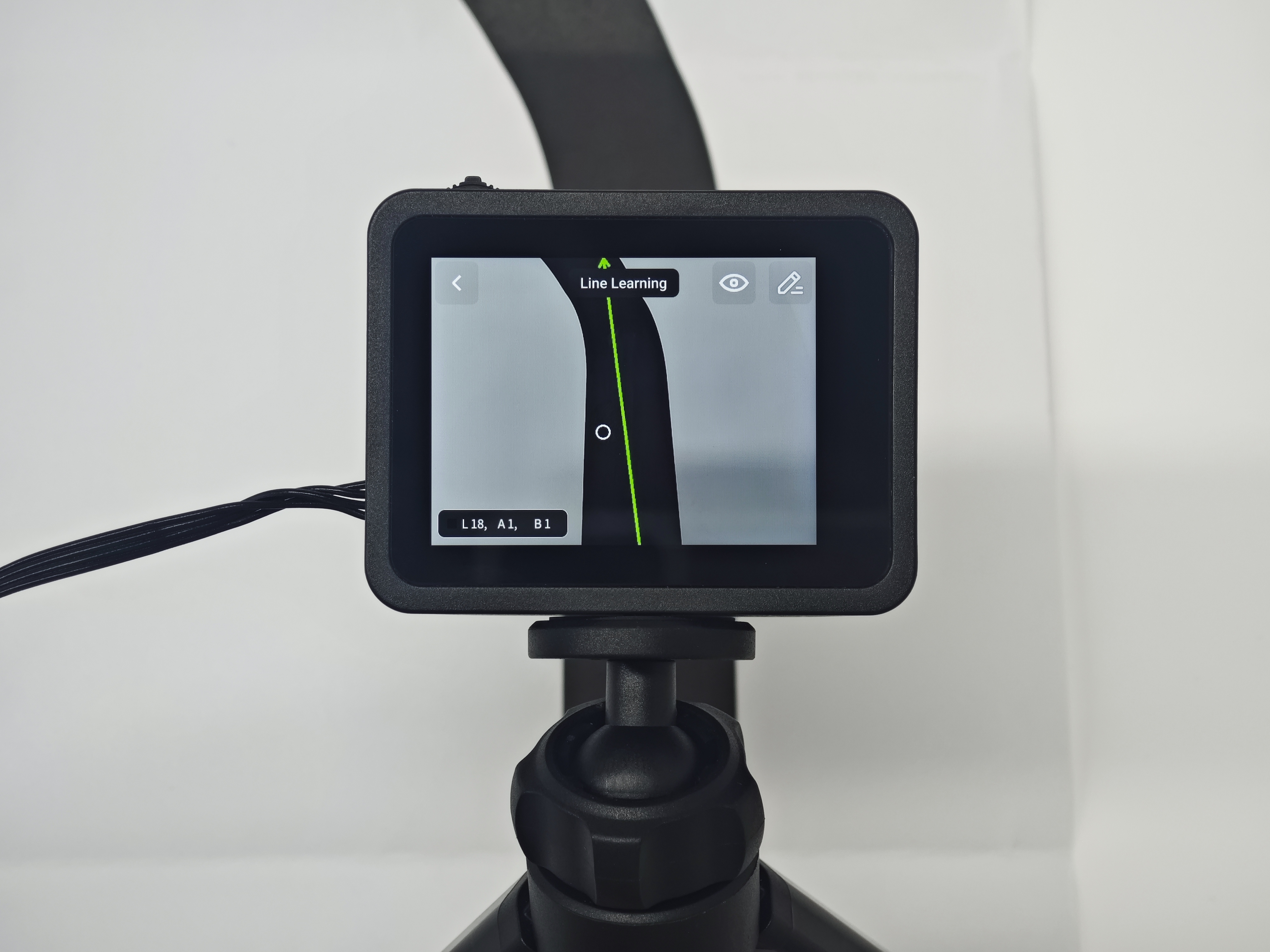

Path recognition
AI Camera 2.0 supports path recognition based on learned line colors and can obtain the path offset.
Operation steps
  1. Start the path recognition feature:
  • Method 1: Tap the Line icon on the AI Camera 2.0 screen.
  • Method 2: In mBlock’s General category, use the Start Line Recognition block to start the feature.
  1. Use line recognition features.

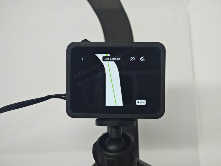

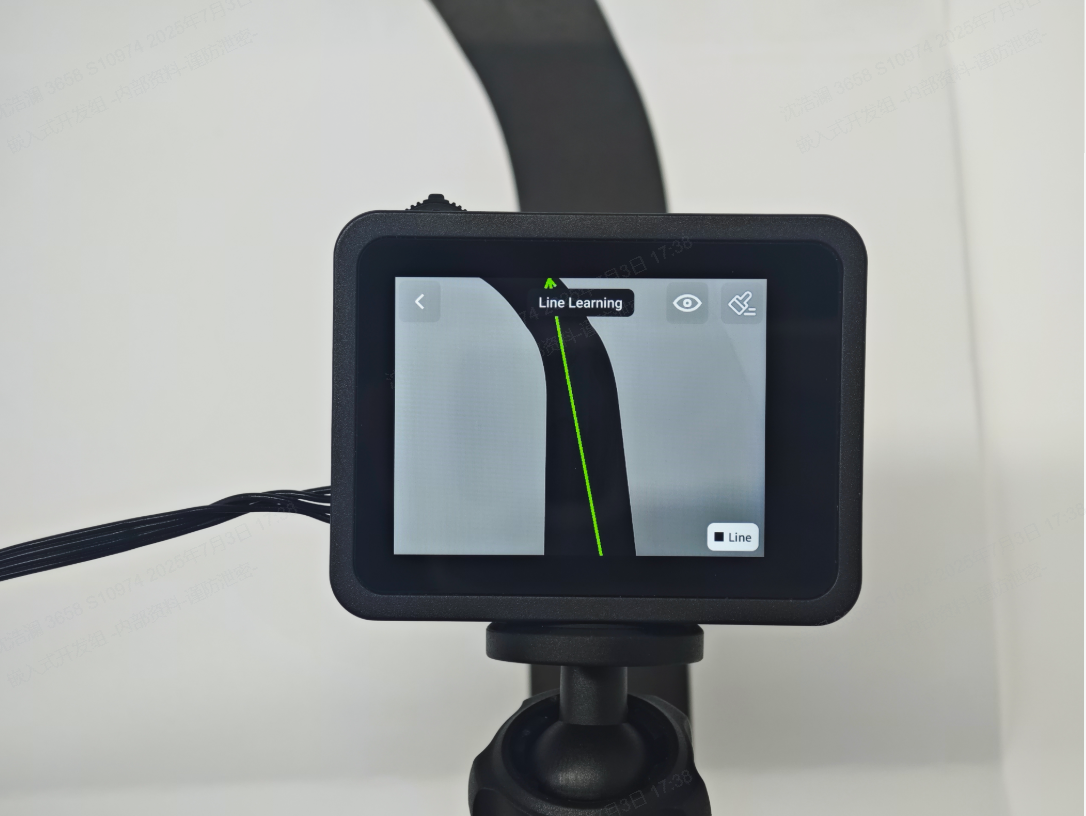

Line learning
Press the Learn button or tap the target position on the screen. AI Camera 2.0 will learn the LAB color threshold at that position, and an arrow in the center of the screen will indicate the forward direction.
Line switching
Tap the eye icon in the upper-right corner to enable or disable binarization. When binarization is enabled, the screen will display in black and white: white represents the learned line color, and black represents unlearned areas.
Line deletion
Tap Line in the lower right corner to view stored lines. Then tap the forget icon in the upper-right corner to delete a learned line, or overwrite it by learning a new one.

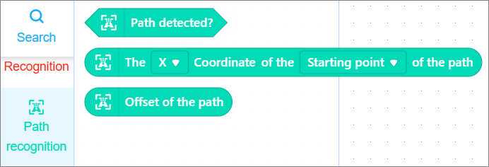

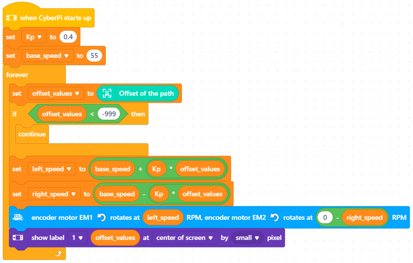

Path recognition blocks
By using CyberPi, AI Camera 2.0, and mBot 2, this example implements line-following control based on path offset. By adjusting wheel speed differences, this example demonstrates the autonomous driving process from line recognition and offset detection to automatic correction.

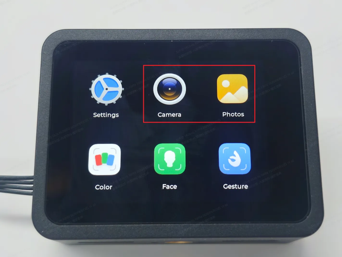

Taking photos and videos
AI Camera 2.0 also supports taking photos and videos. You can take photos or record videos using the Camera feature and preview or view them in the Photos library.
