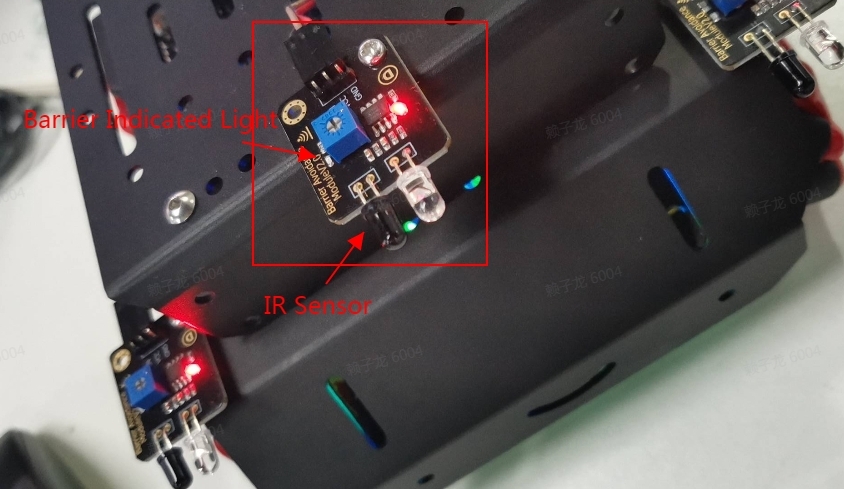

The barrier indicated light keeps on even if there's no obstacle in front.

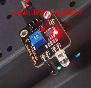

2. Sensitivity is too high

1. Check if the IR sensors are too close or deformed, try to slightly separate or straighten it and then check the indicator light.
2. Using a 2.5mm cross screwdriver to adjust the sensitivity regulator clockwise (Reduced sensitivity).
