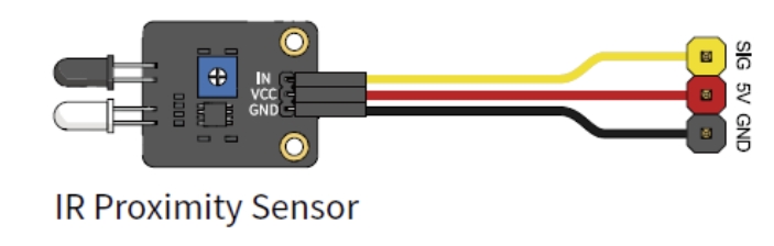

  3. Please set the potentiometer on the sensor closer to the IR transmitter.

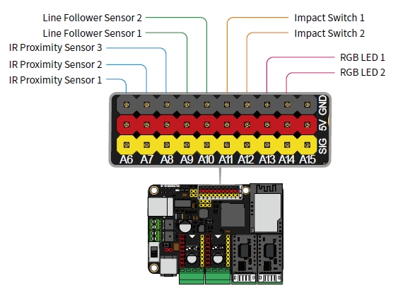

  5. Refer to the following diagram to check whether the cable is correctly inserted into the corresponding pin.
