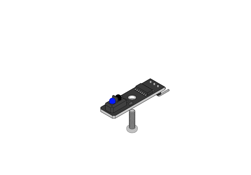

  2. Check if the installation position of the sensor is accurate, if the screws are loose it may cause this module to shift.  03_Install line tracking sensor.gif

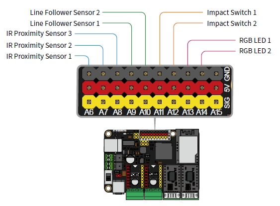

  5. Follow the picture below to check if the sensor is accurately plugged into the corresponding pin port on the motherboard.

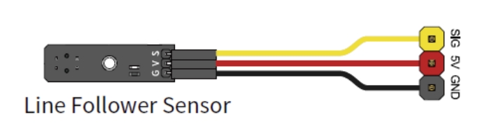

  6. Refer to the following demo diagram to check if the sensor's different color signal wires are plugged into the correct pin ports.
