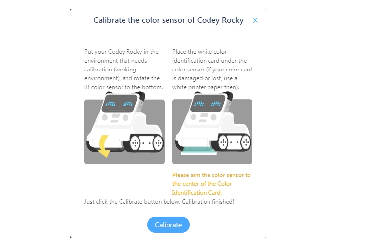

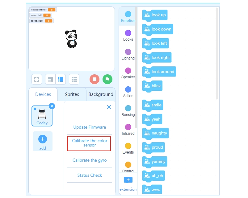

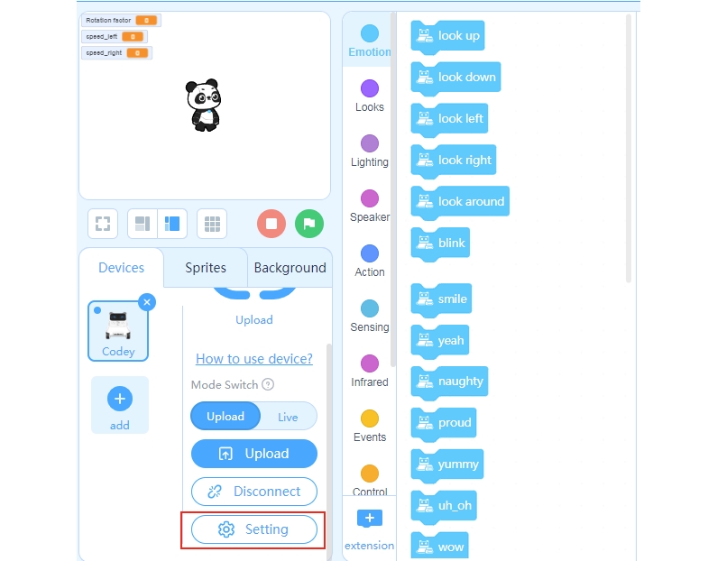

a. Connect Codey Rocky to mBlock software
b. Click the "Calibrate the color sensor" button in the "Setting" section
c. Follow the pop-up window prompts to calibrate. If there are no abnormalities, it will show "Calibration is successful". Otherwise, you need to repeat the operation.

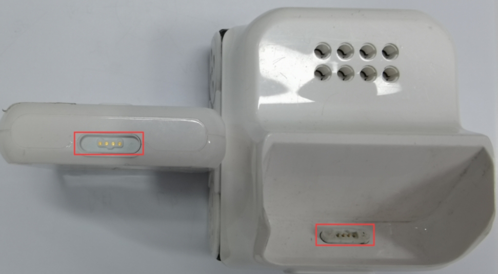

1. The pogo pin interface may be dirty, resulting in poor contact with the device.
2. The color sensor is faulty.
Troubleshooting Steps
1. Use gauze dipped in a little alcohol to wipe the pogo pin interface between Codey and Rocky, and then try to reconnect.
2. If step 1 does not solve the problem, the color sensor itself may be a bit faulty, causing the corresponding functions such as obstacle avoidance not to work correctly. You can contact the support team to confirm the next step.
