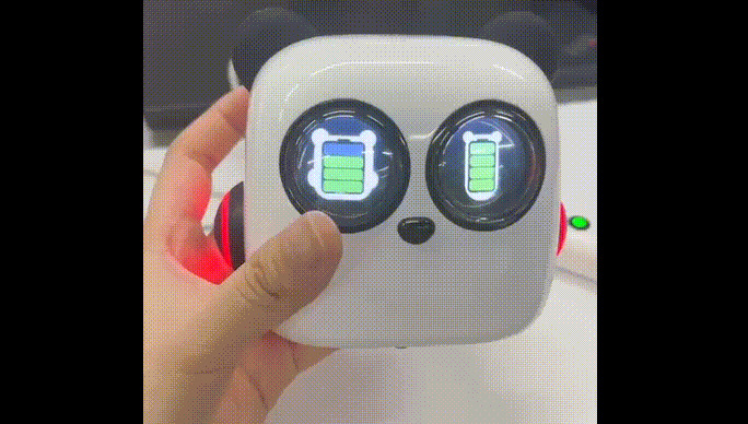

  3.  If the USB power supply still cannot turn on the robot, check whether the charging indicator can light up normally and the charging progress bar can be displayed (as shown below). After charging for a while, disconnect the USB and check whether the battery power is displayed normally. If it can, it is not battery problem, but may be an abnormality of the Carusb board or the motherboard. If it cannot, maybe the charging port(i.e. Carusb board) is abnormal.

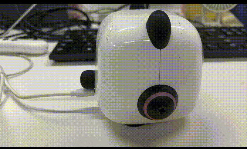

  1.  If the mTiny automatically shuts down after moving a certain distance, you need to check whether it can be charged normally. Observe whether the power level of the car changes during charging, and check the power level of the car again after charging. If there is still no power display after that, you can try to replace another mTiny charging cable and try again to see if it can charge normally. If the problem persists, you need to replace the battery.

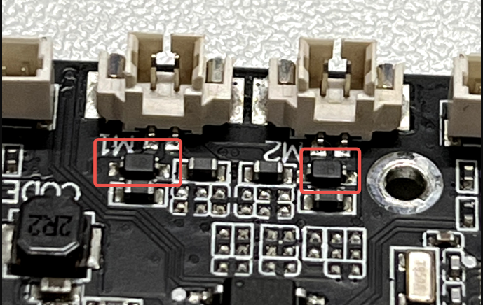

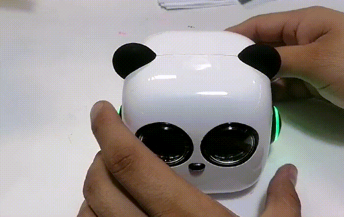

2. Disassemble the mTiny and check if there is TVS tube on the motherboard. If you have a soldering iron, you can try to remove the TVS tube. If not, please contact the support team for a new motherboard. After removing the 4 screws at the bottom of the robot with a cross screwdriver, you can refer to this video to disassemble the product and check the motherboard.
4bd262d0-64ef-44bc-9a80-9f6af9a7012a.png 49a7abd0-b2db-462e-aa51-2a15a6b128af.png
