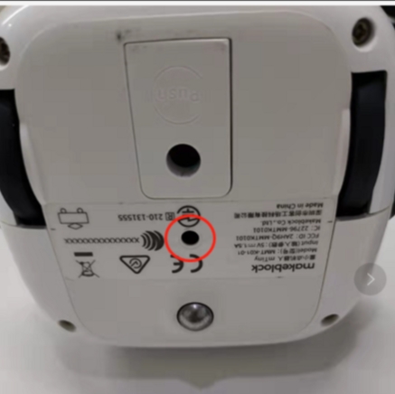

  1. If the mTiny you are using is a C-end version kit, you cannot use the B-end map. You need to confirm that the map pack is compatible with the machine. Since there are many types of map packs, please send the product order number and the picture of the map pack you are using to the support team for confirmation.
  2. Check if the sensor at the bottom of the device is blocked. (Location circled in red in the picture below)
  1. Follow the article "How to Update Firmware for mTiny" to refresh the firmware of the machine and try again.
