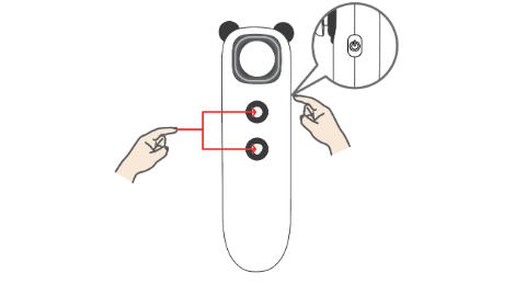

In the mTiny Discover Kit, the joystick of tap pen is disabled by default. To use the joystick to control mTiny, you need to enable the joystick first. In mTiny Coding Kit, the joystick of tap pen is enabled by default, so you can use it to control mTiny directly. Press and hold the Power button, Confirm button, and Stop button simultaneously to enable or disable the joystick of the tap pen controller. (As shown below)

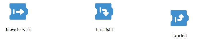

  2. You can use simple coding cards to test whether the machine can move forward and backward normally. If there is no problem, but the robot can't be controlled by tap pen joystick, then the tap pen may be faulty and can be replaced separately.
