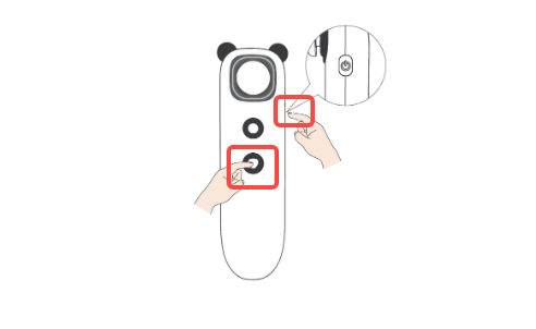

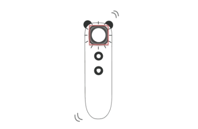

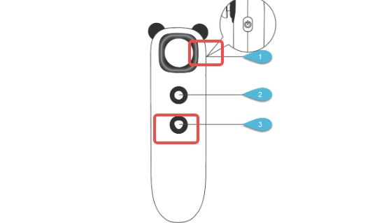

  2. Press the power button and the down button (i.e. buttons 1 and 3 in the figure below) of the tap pen at the same time. When you feel the vibration and the tap pen indicator light turns to blink blue and green alternately, it enters the calibration mode.

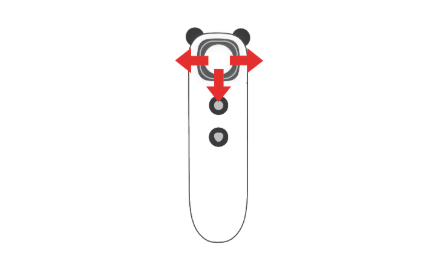

  1. The order of calibration is up, down, left and right in that order, and the procedure is as follows:

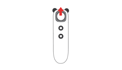

a. Push the joystick up to the end, and then release it to let the joystick return to its home position. Push the joystick fully forward and then release it.
b. When calibrating downward, you also need to push joystick down to the end, and then release it to return to the position. The steps for left and right are the same as above.
c. The steps for left and right are the same as above. After calibration is completed, press and hold the power button and down button of the tap pen at the same time to exit the calibration mode.

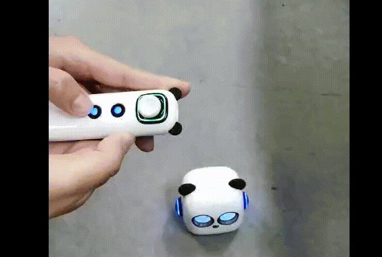

The operation is referenced below:
Please note: If you do not release the joystick first to return it to position, but push up to the end and then push straight down to calibrate, the joystick calibration may fail. If calibration is unsuccessful, the mTiny will move uncontrollably.
