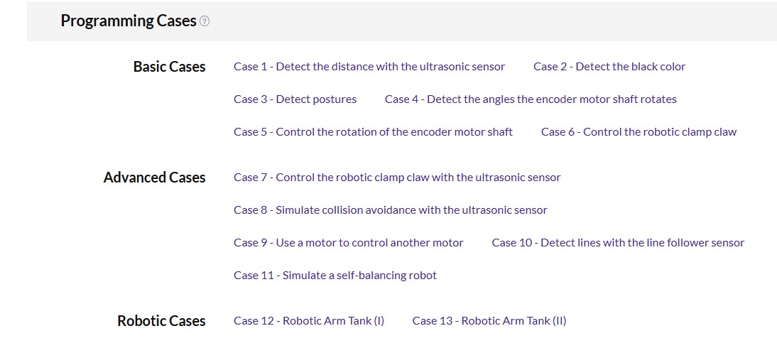

  1. If using a self-created program to control the machine, you can send us the program file first to confirm. In the meantime, you can simply test if the problem persists by using the official program available on the Makeblock Support website. (Note: In this case, please build the product in original Robotic Arm Tank form)
