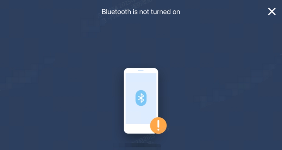

When Ultimate tries to connect to a mobile device (phone or tablet) via Bluetooth, the product cannot be recognized (e.g., the app page stays in a circle searching). Or the product successfully connects to the mobile device's Bluetooth, but becomes disconnected due to motor operation.

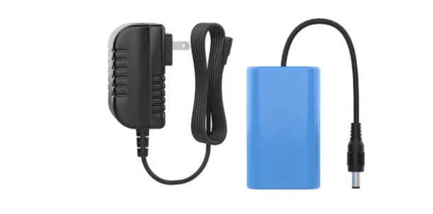

  4. Battery holder or battery problem (low battery power/unstable voltage).

  2. Verify whether the Bluetooth authorization of the app is enabled on the mobile device (operations may vary slightly on different devices)
  • IOS system: Enter the "Settings" section of the mobile device, select "Privacy", click "Bluetooth", and check whether the authorization button of the corresponding app is turned on.
  • Android system: Enter the "Settings" section of the mobile device, select "Privacy Protection", click "Change Bluetooth connectivity" in "Other permissions", and check whether the corresponding app has selected to allow authorization.

  2. If the product is currently powered 6AA battery holder, please install new Nanfu AA batteries. If the problem persists, you can plug in a USB cable to power th e product at the same time, and then test the Bluetooth connection in the App. If the connection is successful at this time, it can be verified that the problem is the battery. It is recommended to use Makeblock rechargeable battery pack.
