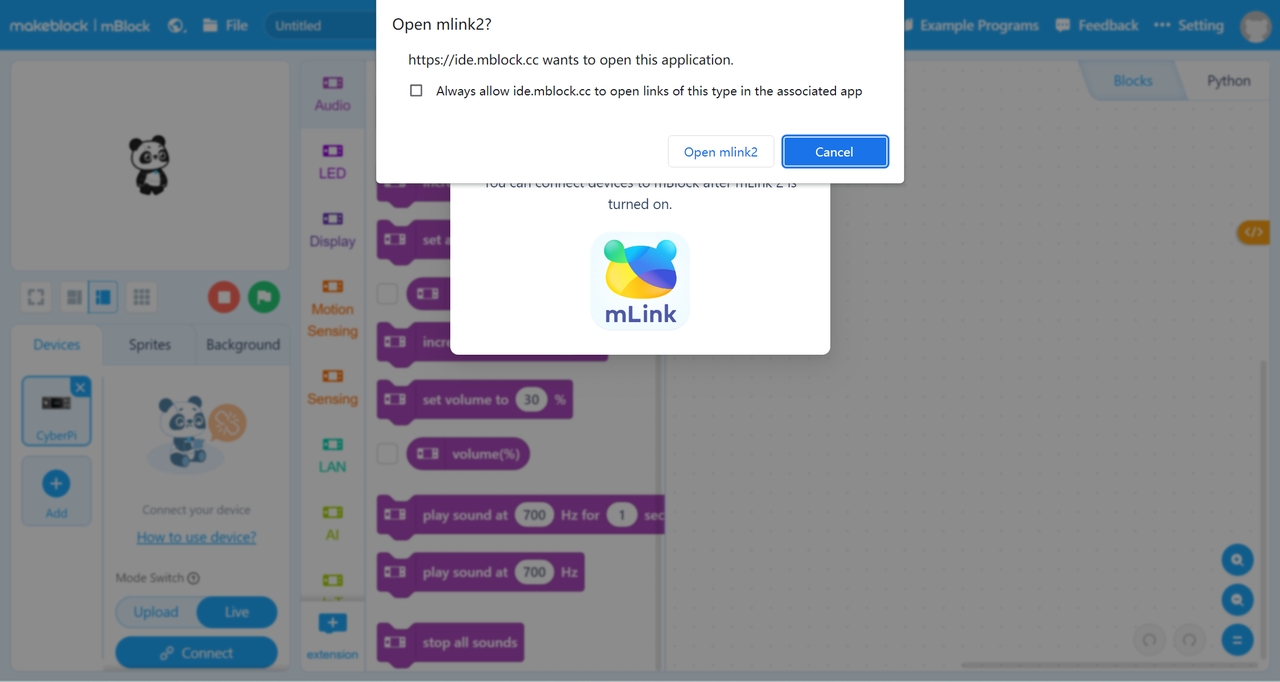

1. Do I have to install the mLink browser plug-in to use the mBlock 5 Web version?
Yes, you need to install the mLink browser plugin for the mBlock to run on your browser. It is recommended using the Chrome browser for the complete functions of mBlock.
Note: If the installation failed, turn off the firewall or anti-virus software and try again.
