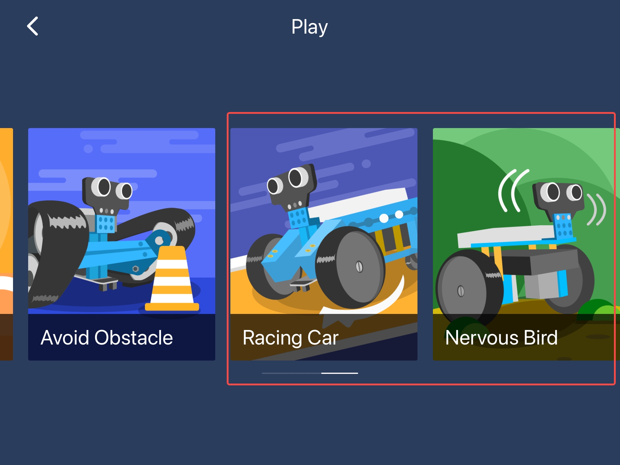

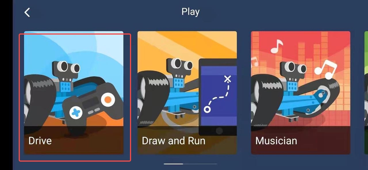

(2)Click the "Play" section, and then enter the corresponding function page according to the current actual form of the machine:

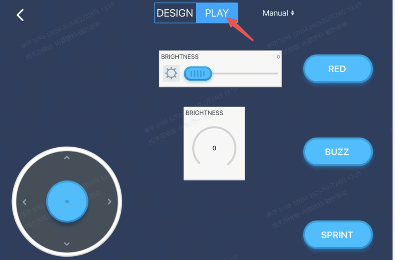

  • If the mBot Ranger is in the form of Land Raider, select “Drive” mode to operate the machin. If the machine is currently built in other two forms, click to enter the corresponding mode.
  • Click the "Play" section and select "Manual" mode (if available), then run the machine with the joystick setting.
