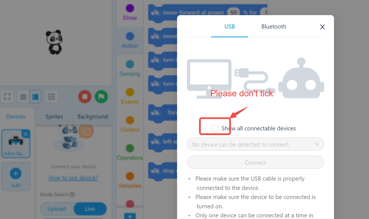

  2. Operation errors, such as selecting the wrong device extension, or ticking the “Show all connectable devices” checkbox when connecting a device.

  2. Incorrect device selection does not actually affect the connection of the product, but the firmware update will fail. So make sure the device extension is selected correctly. If there is a green arrow in the upper right corner of the device extension prompting an update, please update the plugin before adding the extension. In addition, do not tick the “Show all connectable devices” box on the connection page.

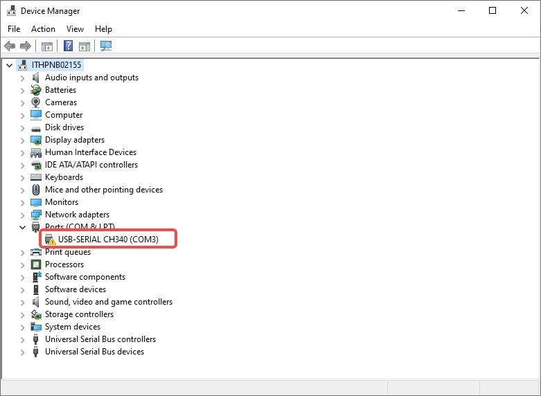

  1. Enter your computer's device manager and check whether the CH340 driver is displayed normally. If the port is not displayed or there is a yellow warning mark in front of it, you can re-download the serial port driver: https://www.wch-ic.com/downloads/CH341SER_ZIP.html
