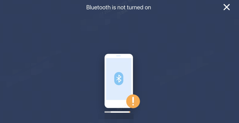

二. App bluetooth connection problem
(1) Possible Causes
  1. Bluetooth module failure.
  2. The mobile device does not enable Bluetooth authorization for the specific app.

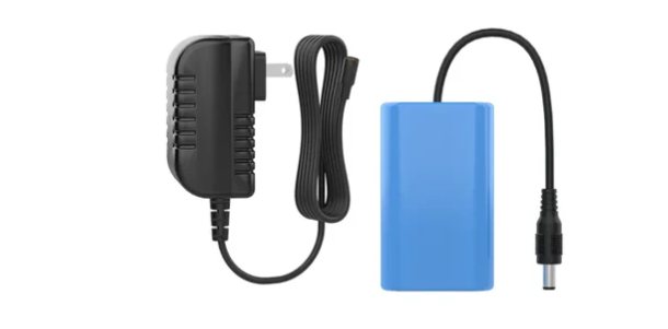

  4. Battery problem (battery power is too low/voltage is unstable).

  1. Check whether the Bluetooth module indicator light is normal. The indicator light of the Bluetooth module flashes slowly in blue after power on, and becomes constant blue when the Bluetooth connection is successful. If the indicator light displays incorrectly in different states, you may need to replace a new module.
  1. Enter the mobile device to confirm whether Bluetooth authorization is turned on (operations may differ slightly for different device models)
  • iOS system: Enter the "Settings" section of the mobile device, select "Privacy", click "Bluetooth", and check whether the authorization button of the corresponding app is turned on.
  • Android system: Enter the "Settings" section of the mobile device, select "Privacy Protection", click "Change Bluetooth connectivity" in "Other permissions", and check whether the corresponding app has selected to allow authorization.

4. If the product is currently powered a battery holder, please install new Nanfu AA batteries. If the problem persists, you can plug in a USB cable to power the product at the same time, and then test the Bluetooth connection in the App. If the connection is successful at this time, it can be verified that the problem is the battery. It is recommended to use Makeblock rechargeable battery pack.
