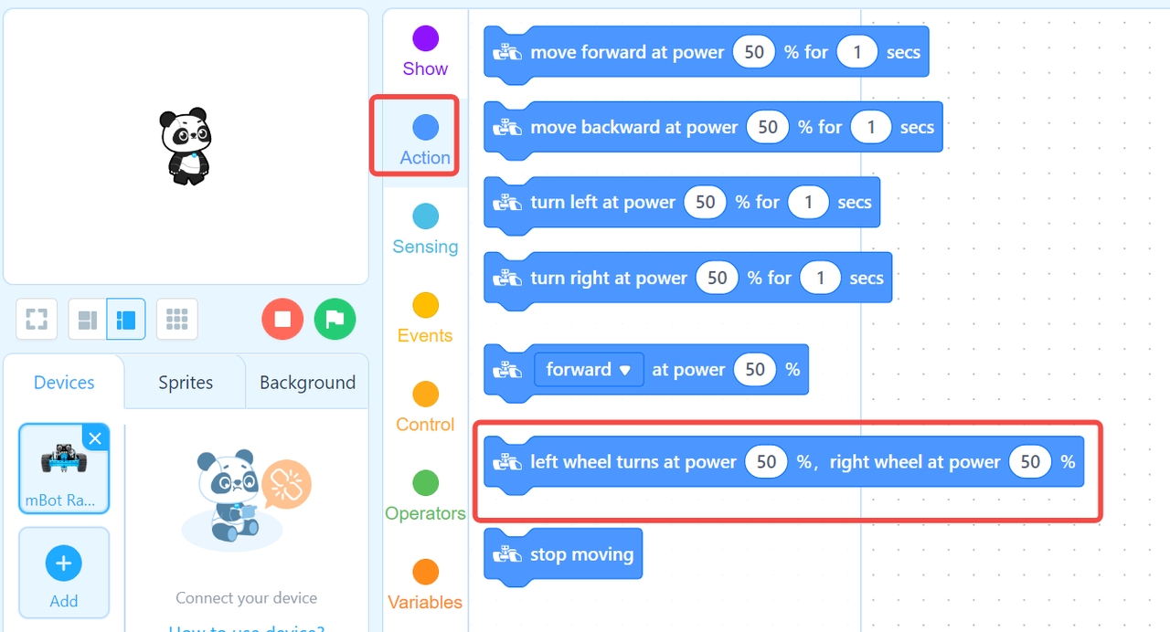

  1. Use the motor power setting block to synchronize the power of the wheels on both sides for testing.

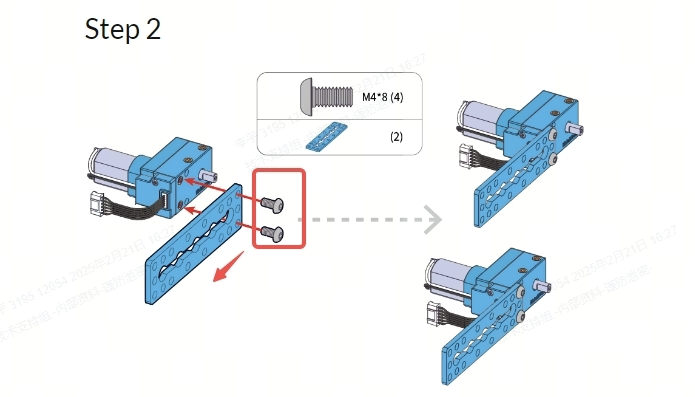

  2. Remove and reinstall the motor and track section. You can try to change the fixing holes of the motor and the metal beam, move the two screws on the both sides motor circled in the picture below in the direction of the arrows by one space, install it and then test if the problem still occurs. (If this does not solve the problem, install the screws back into the original holes).
