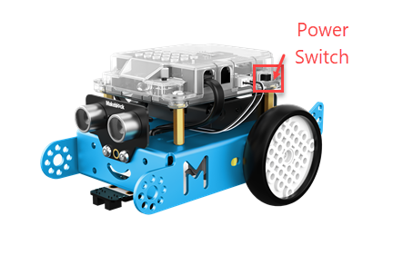

2.  Push the mBot power switch to the ON position and connect the machine to the computer using the original USB cable.

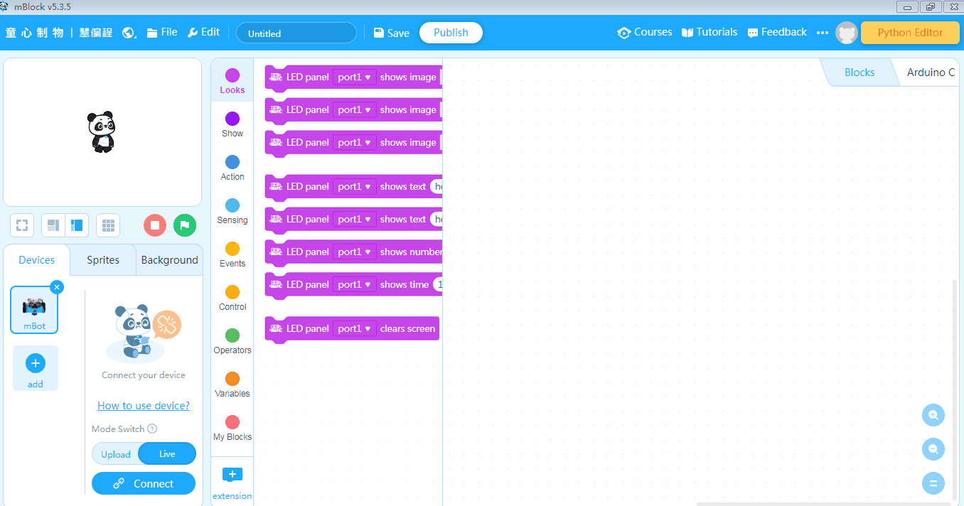

3.  Open mBlock, click the device library and choose the mBot device extension to add (if there is a green arrow in the upper right corner of the device, please click the arrow to update the device plug-in first)
4.  Click Connect and note that you do not need to tick the “Show all connectable devices” box.

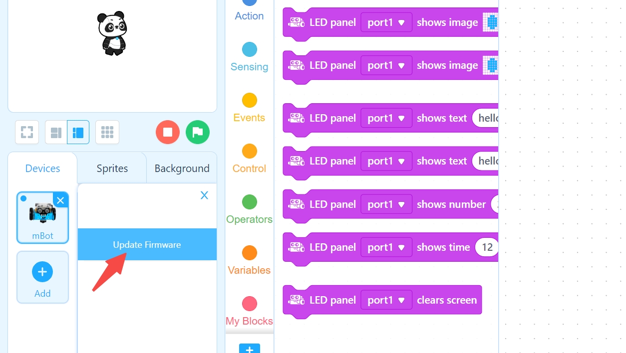

5.  Click “Setting” after successful connection and click on "Firmware Update". (PS: When the firmware is a low version, the setting position will automatically change to the firmware update button)
6.  After clicking Firmware Update, you can choose whether to update the online firmware or restore the factory firmware. Click on the desired firmware and wait for the update to complete.
