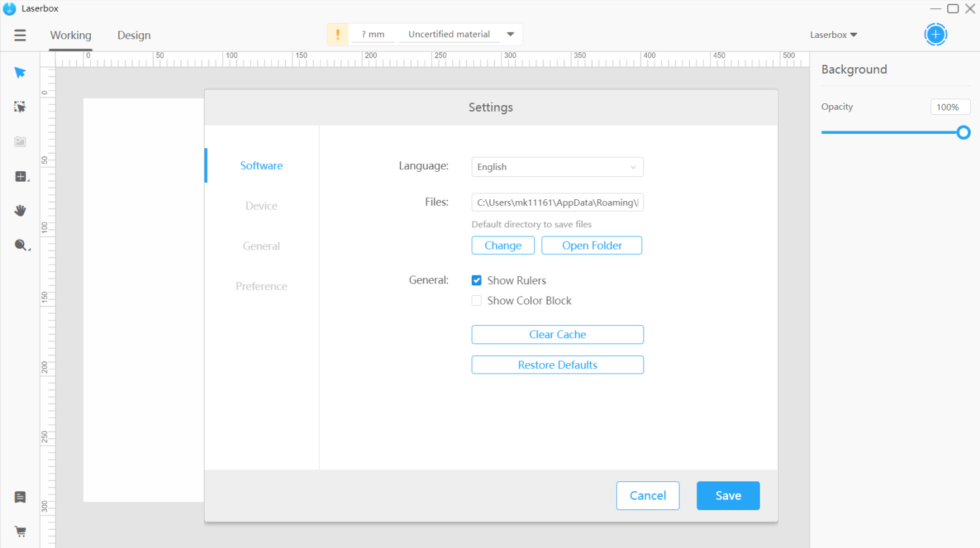

  5. Open Folder: Open the folder into which Laserbox automatically saves projects.

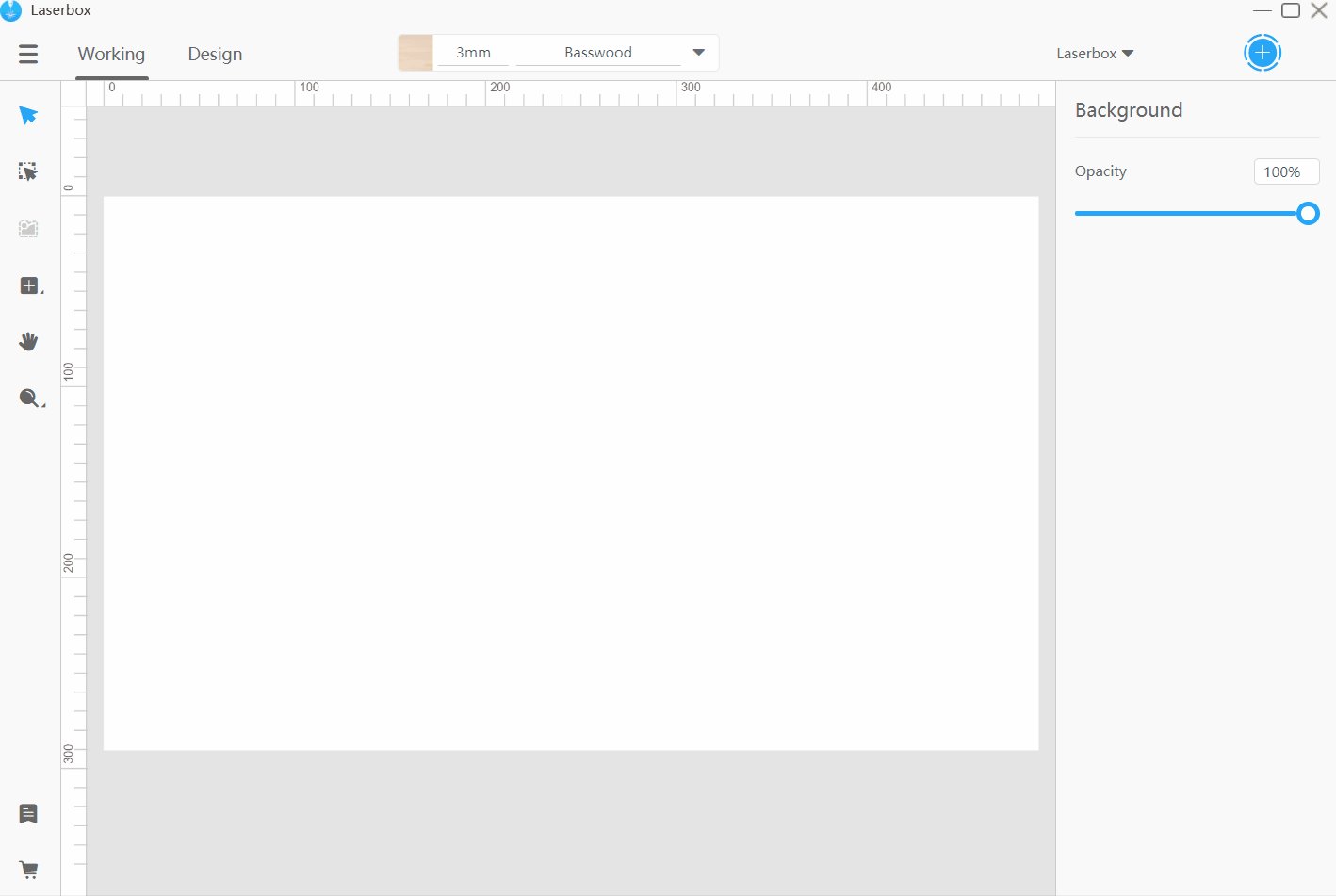

Working interface

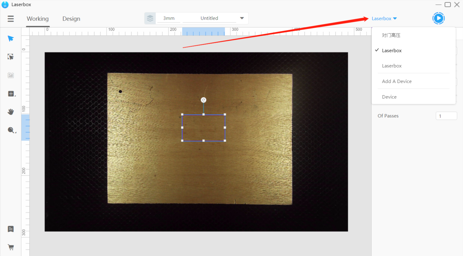

  1. Menu: In Menu, you can import/export files, or change settings.
  2. Working/Design: Click it to switch between interfaces.
  3. Material management: Here displays the material already identified or set up. Click to select a material for processing, add a new material or change the processing parameters.
  4. Device management: Here displays the connected device. Click it to manage all the devices that were once connected.
  5. Start button: Click the start button to start a cutting or engraving procedure.
  6. Parameter setting panel: Use this panel to change cutting or engraving parameters. Parameters are displayed only when there’s a layer on the canvas. If you enable Show Color Block in Settings, then the panel will display custom parameters.
  7. Other links: Visit Makeblock official website or online store to access more courses or buy consumables.
  8. Canvas: The canvas is the area where you create images for processing. It’s the same as the working area in the laser cutter. So when the software is connected to the laser cutter, the canvas will display the picture from the camera in real time.
  9. Toolbar: The toolbar includes many tools and options that are frequently used.

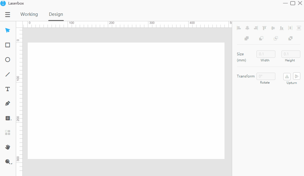

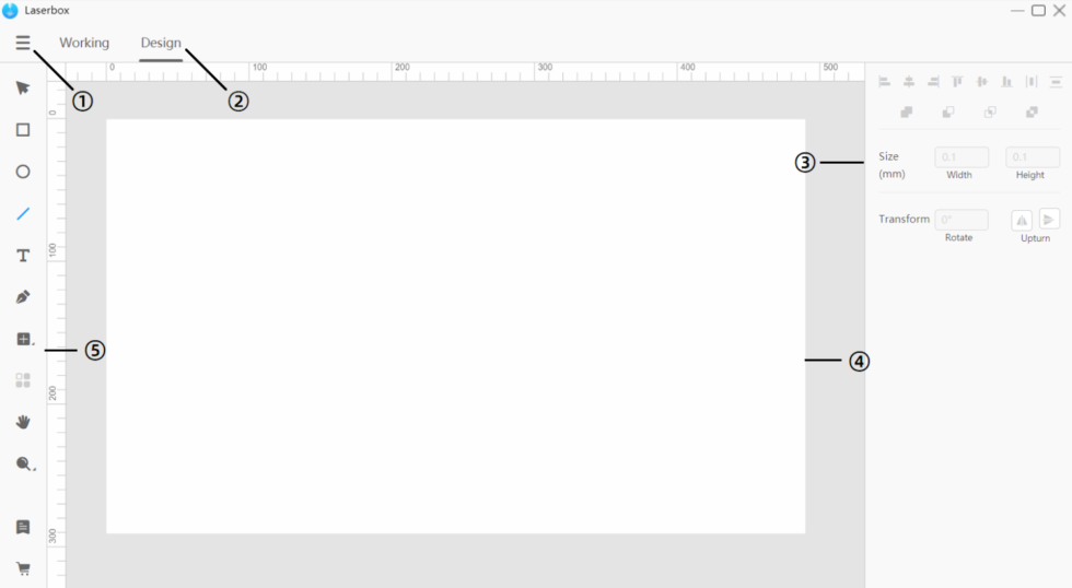

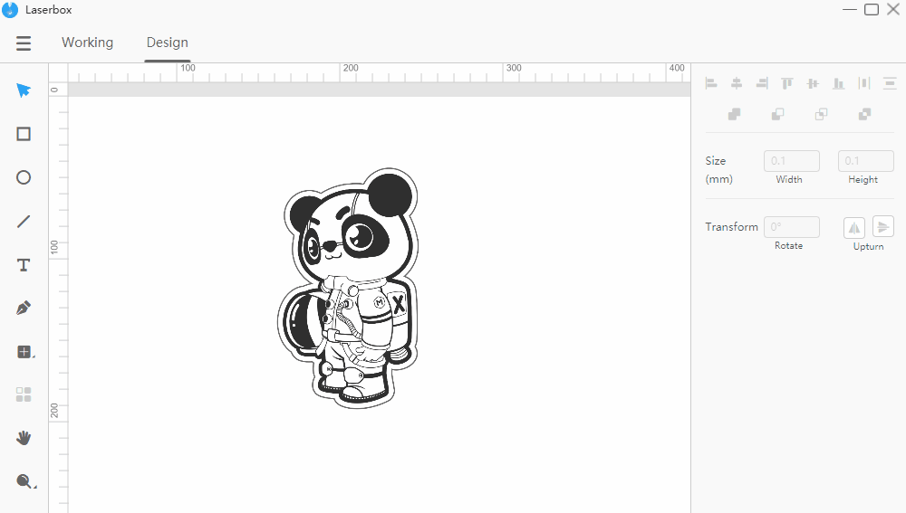

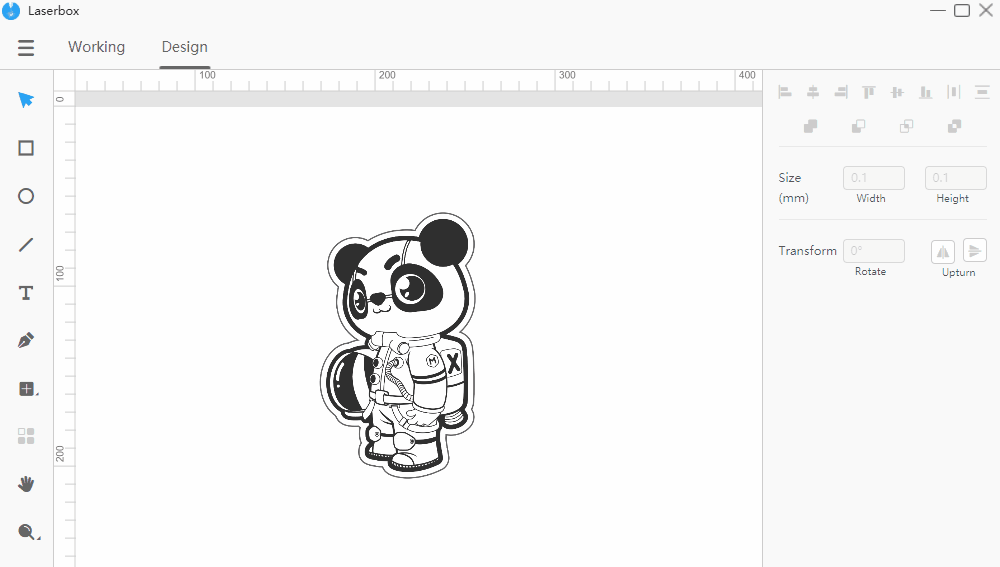

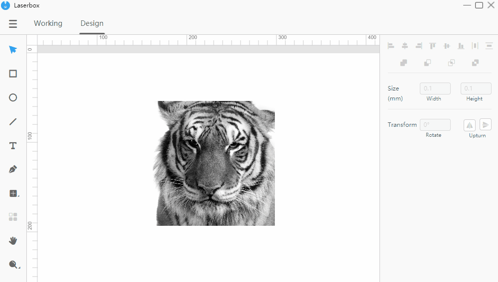

Design interface
  3. Styles panel: This panel includes lots of tools allowing you to combine and change shapes to create more complex images.
  4. Canvas: The canvas is the area where you create images for processing.
  5. Toolbar: The toolbar includes many tools and options that are frequently used.

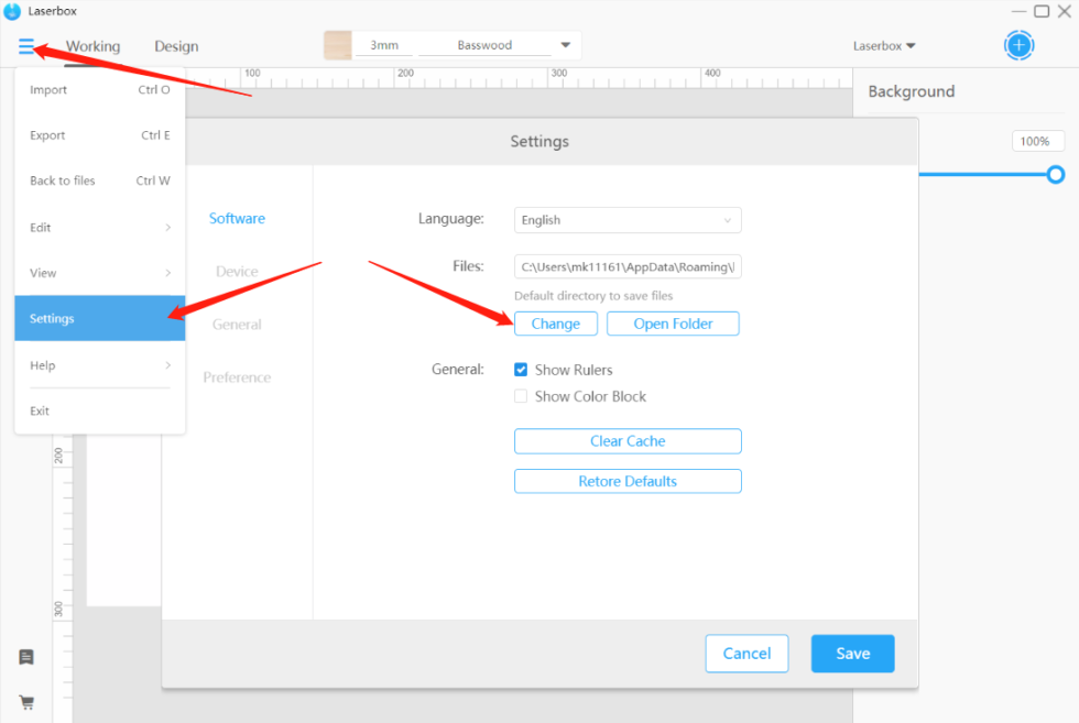

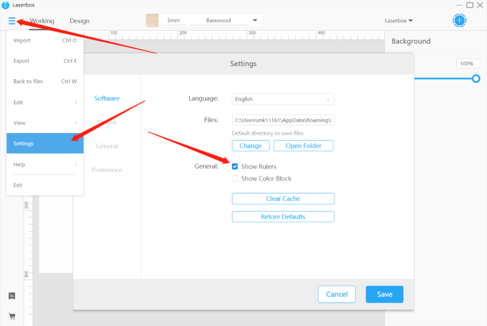

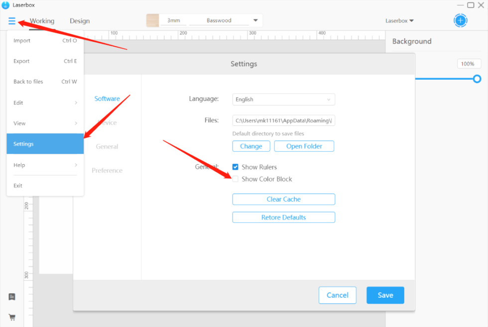

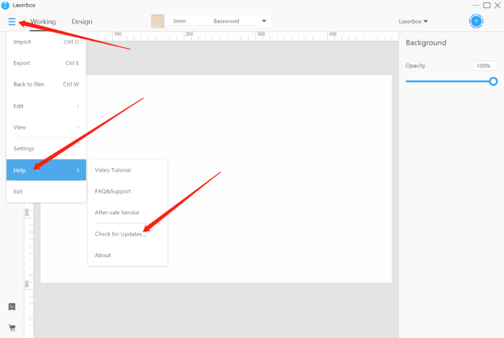

Menu
In Menu, you can do plenty of things. The working interface and design interface have the same menu list.
  • Import: Import projects or image files into the canvas. The shortcut is [Ctrl] + [O]. Or you can directly drag a file into the canvas.
  • Export: Save the file as .lq format specific to Laserbox. The shortcut is [Ctrl] + [E].
  • Back to files: Back to the project management interface.
  • Edit: Edit layers.
  • View: Zoom in /out or drag the canvas.

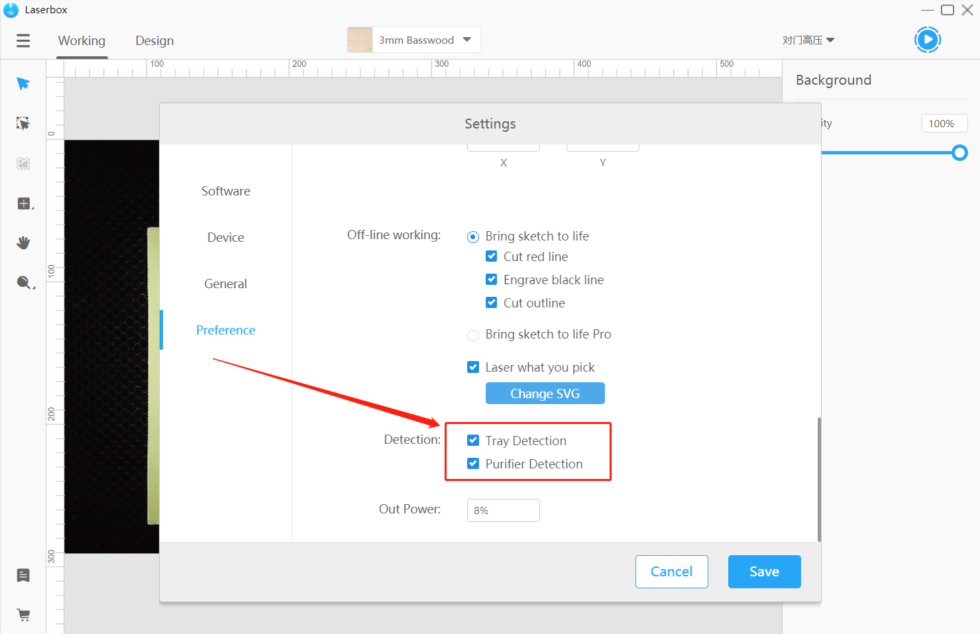

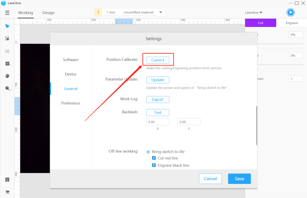

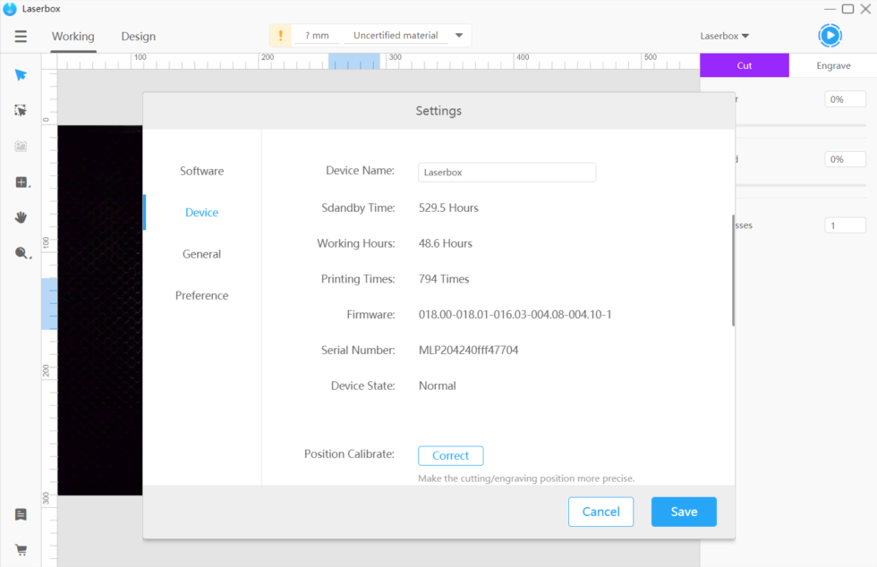

  • Settings: Change the settings for the software and laser cutter that’s connected.
  • Help: Redirect to websites where you can see help documents.
  • Exit: Close the software.

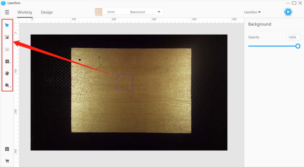

Toolbar
The working interface and design interface have different toolbars.
Toolbar in working interface
  • Select: Left click or frame a layer to select it.
  • Marquee: Extract images from the camera on the laser cutter. Learn more about extracting images in the "Add layers" section.
  • Outline: Extract outlines from the images on the canvas. Learn more about extracting outlines in the "Add layers" section.
  • Insert: Insert in-built graphs or components. Learn more about inserting elements in the "Add layers" section.
  • Hand grip: Drag the canvas to see different parts of the canvas.
  • Zoom: Make the canvas appear larger or smaller.

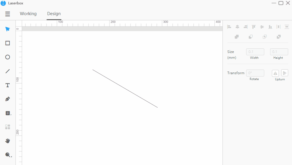

Toolbar in design interface
  • Rectangle: Create rectangle layers in the canvas.
  • Oval: Create oval layers in the canvas.
  • Line: Create line layers in the canvas.
  • Text: Create texts in the canvas.
  • Pen: Create vector paths in the canvas.
  • Array: Quickly duplicate layers and arrange them in the way you set up.

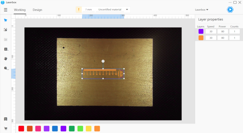

Add layers in the working interface

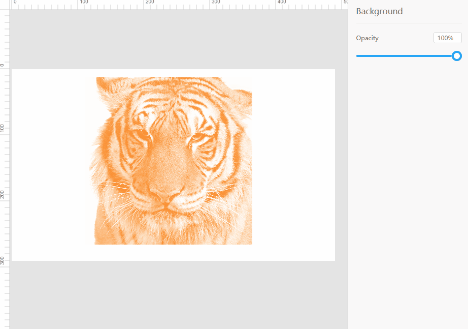

Import images
Go to Menu > Import, then select the image file you’d like to import. Or, you can directly drag an image into the canvas. The shortcut is [Ctrl] + [O].
Extract images
The Marquee tool enables you to extract images from the camera on the laser cutter. Click Marquee in the toolbar to frame any portion you’d like to extract.
Extract outlines

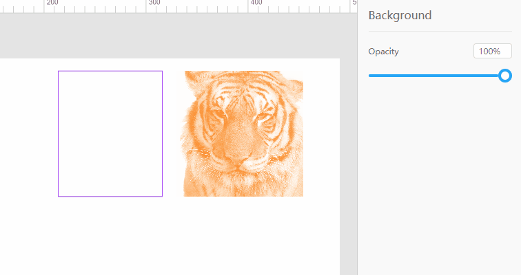

The Outline tool automatically outlines a bitmap. The result can be used for the laser cutter to cut the image by its outline. Select a bitmap layer made of enclosed outlines, then click Outline in the toolbar, and wait until a vector path layer of the outline is generated. Set up in the software to cut the enclosed outline.

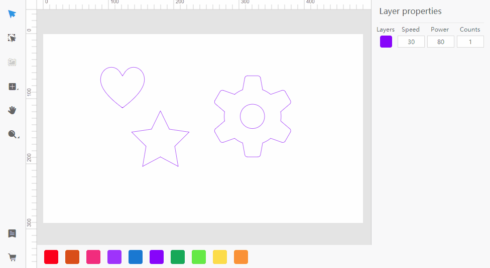

Insert

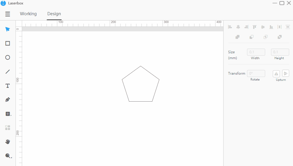

The Insert tool contains the options you can use to draw shapes on the canvas. Click Insert on the toolbar on the left, and select graphs or components on the panel. Click and drag the shape or part into the canvas to insert it.
Add layers in the Design interface

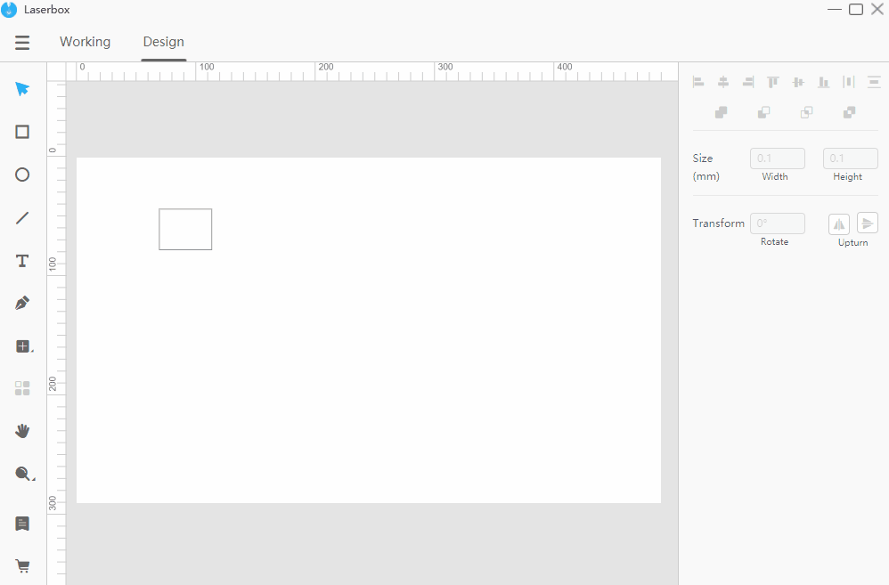

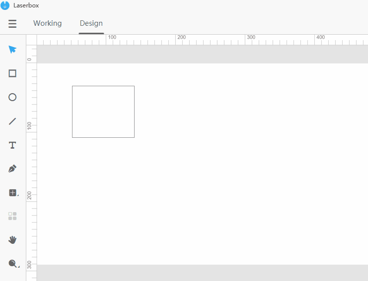

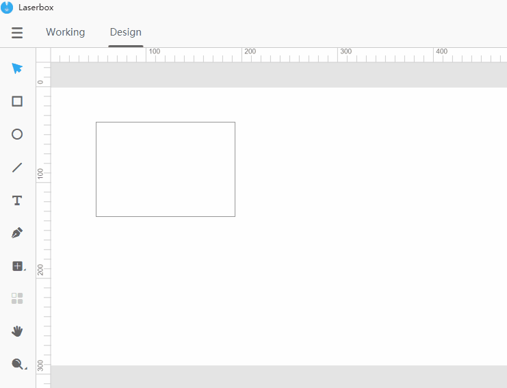

Rectangle

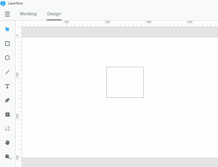

For making rectangles. In the Design interface, select Rectangle on the toolbar on the left, and then drag on the canvas to create a rectangle. If you hold down Shift while dragging the mouse, you lock the width-height ratio to 1:1, which means you’re drawing a square. The keyboard shortcut to draw a rectangle is [R].
When you draw a rectangle, its width and height appear at the bottom right corner of the mouse-pointer.

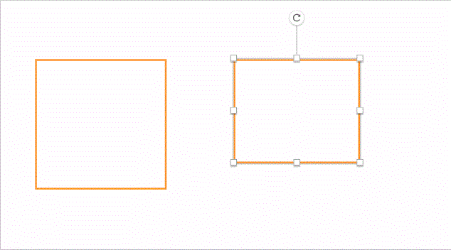

When you select a layer, anchor points appear on its borders. Drag the anchor points to resize the layer. Or, you can specify the width and height in the style panel on the right for more accurate size control.
Click the lock icon between the size parameters to lock/unlock the aspect ratio. If the aspect ratio is locked, it won't change even when you drag the anchor points of the layer or adjust the size parameters. If the ratio isn't locked, you can adjust the width or height without changing the other. To quickly lock the aspect ratio, hold down Shift when dragging the anchor points of a layer.

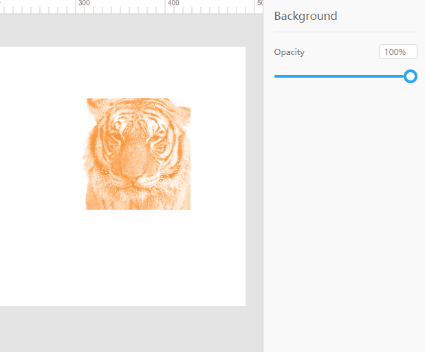

Filter setting

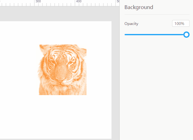

When you select an image, the Filter Setting area appears in the style panel. Click the options to apply different filters to your image. To remove an applied filter, click the filter again.

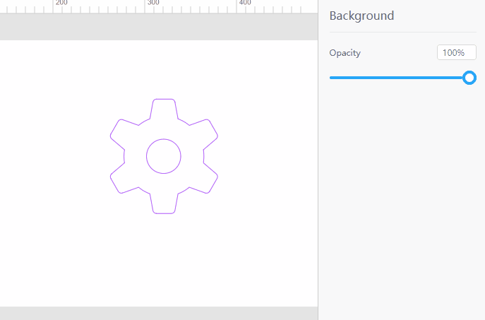

Pen tool anchor points
When you select a vector path that is created with the pen tool, you can double-click the layer to edit the anchor points. Select an anchor point and define it as a Corner Point or Smooth Point in the style panel on the right.

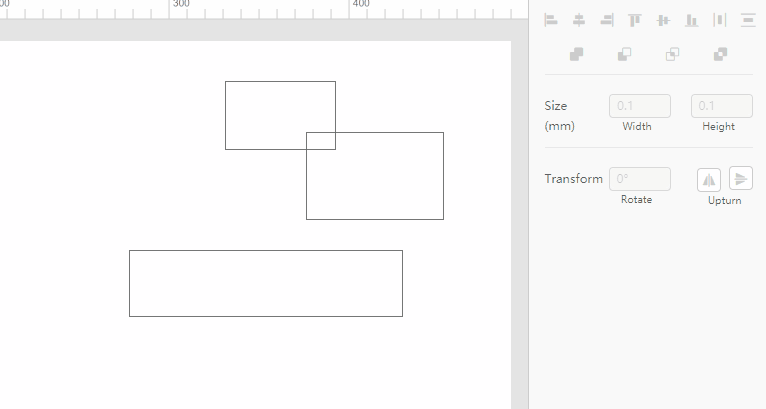

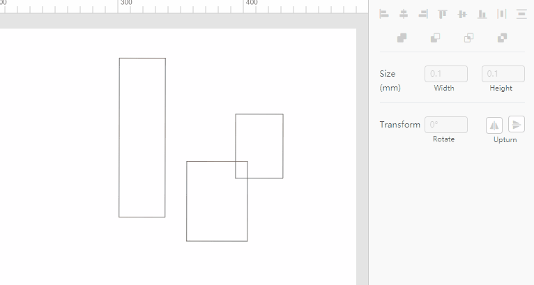

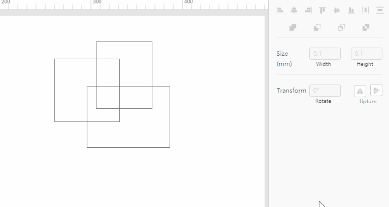

Boolean operations
Use Boolean operations to transform two or more shapes into one. Four types of operations are available:
  • Union: Merges multiple shapes into one.
  • Subtraction: Removes the region of the bottom shape that is covered by the top shape and keeps the uncovered region of the bottom shape.
  • Intersection: Keeps the overlapping region and deletes the rest of the shapes. If the shapes aren’t overlapping at all, then all shapes will be removed.
  • Differentiation: Removes the overlapping region of the shapes and leaves the rest on the canvas. Opposite to Intersection.

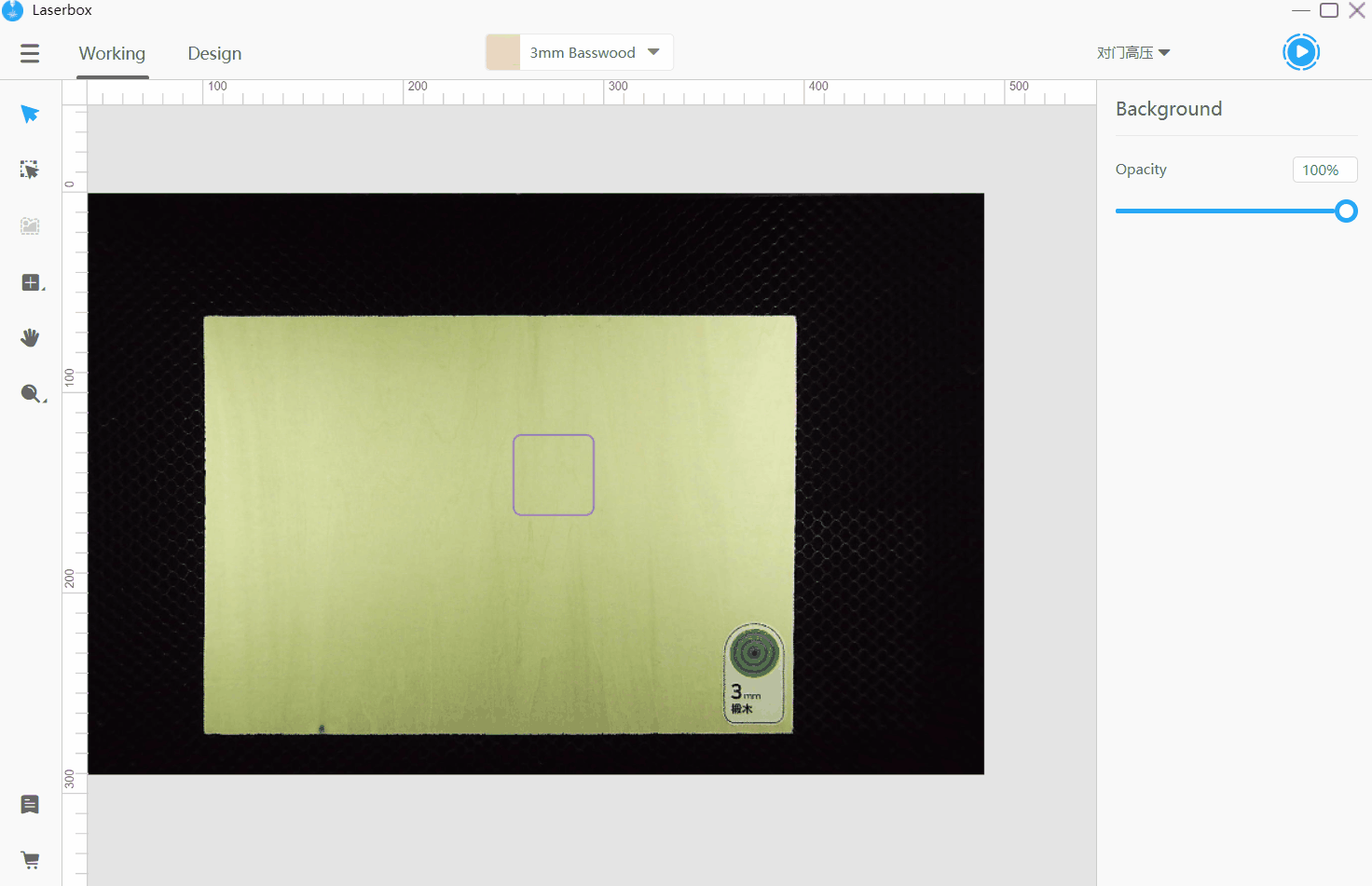

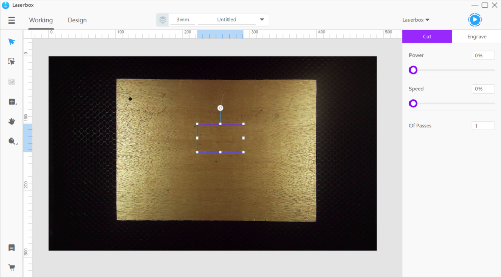

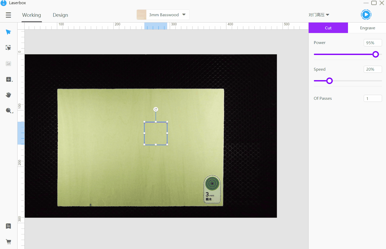

Select a material

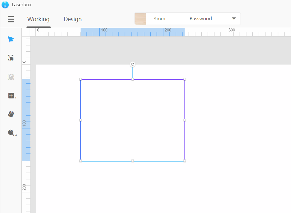

Laserbox is equipped with a high-resolution ultra-wide-angle camera. The Laserbox software relies on the camera to read the ring codes on Makeblock materials and identify the materials. If you want to process a material that is the same as a Makeblock material but without a ring code on it, you can select the material manually with the materials management tool in the software.
1. View the materials list
Click the triangle icon on the right of the materials management tool to display the materials list.
2. Select a material
On the drop-down list, select the material you want to process. Laserbox will then configure the parameters accordingly.
Note: The processing parameters will be shown on the right side of the Working interface only when you select at least one layer on the canvas.

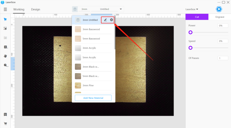

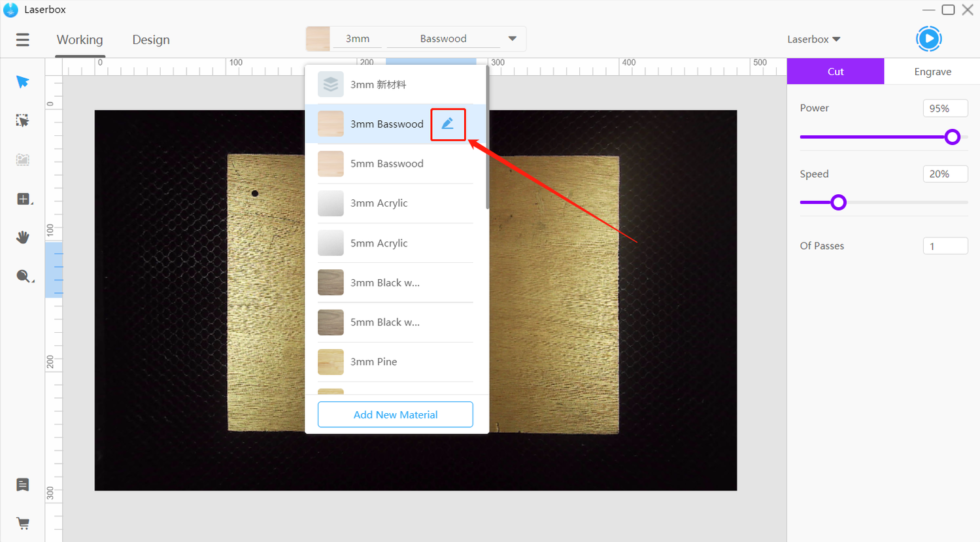

Edit material parameters
If you're not happy with the default processing parameters and effects, change them with the materials management tool.
1. Edit material
When the mouse pointer stops at a material name on the materials list, an edit button appears on the right side. Click the button to open the material editing window.
2. Adjust parameters
In the Edit Material window, you can configure the laser cutting or engraving parameters for any Makeblock material.
3. Save parameters
Click Save at the bottom right corner of the window to apply the new parameter configuration in the software. After that, the new parameters will be applied to the same materials that are identified through the ring codes.

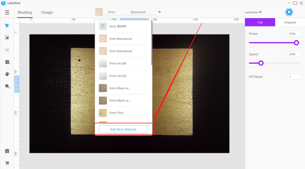

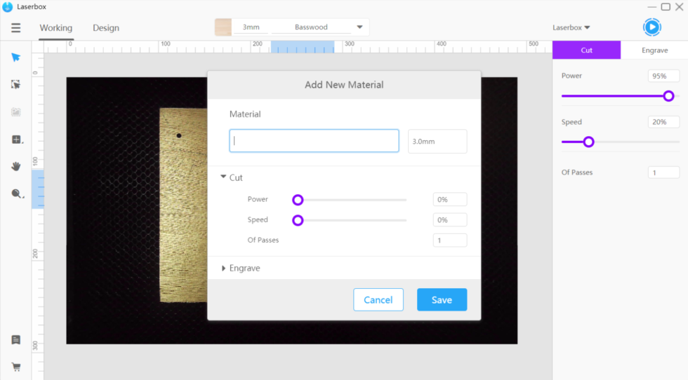

Add a new material
Non-Makeblock materials that have gone through processing parameter tests can be added to the materials list in the software. This offers quick access to parameter settings for later use.
1. Add a new material
Click Add New Material at the bottom of the materials list.
2. Enter material information
In the pop-up window, type in the material information, including name, thickness, engraving parameters, and cutting parameters.
3. Save material information
Click Save at the bottom right of the window. And the window automatically closes when you do this, and the materials management tool will select the new material.
4. Select the material to save
The newly-added material is displayed at the top of the materials list. Click x on the right of the material name to remove the material from the list.
Parameter settings
Processing parameters include three types: engraving parameters, cutting parameters, and custom parameters. By default, engraving or cutting parameters will appear on the right of the Working interface after you select a layer.
Bitmap images can’t be cut, so you can only tune the engraving parameters if you select a bitmap layer.
If you select a vector layer, you can adjust both cutting and engraving parameters for it
Orange means engraving and blue for cutting.

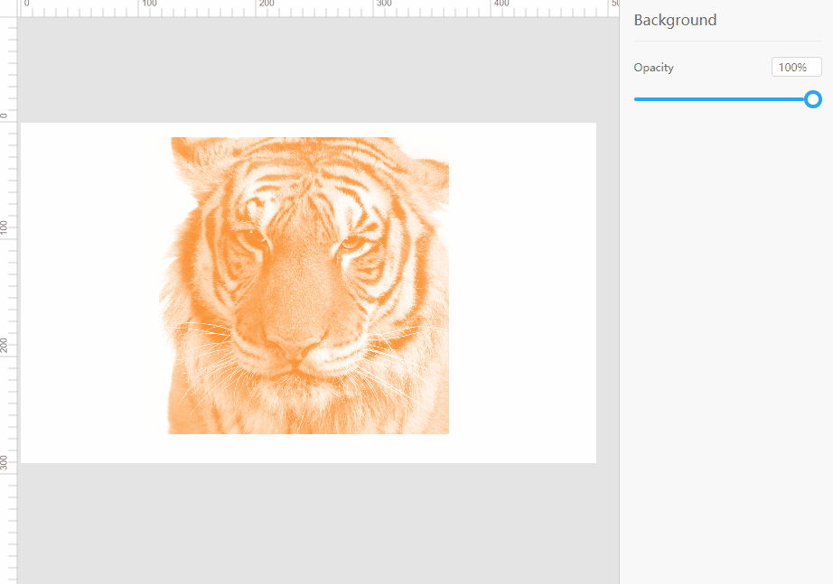

Engraving parameters

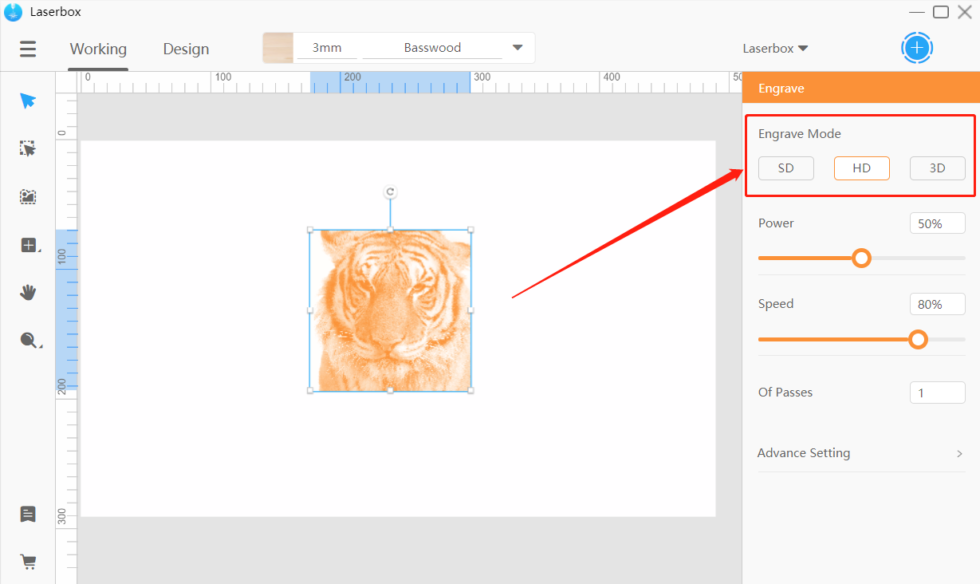

Engrave mode
What can it do?
Engrave mode options are only available when you select a bitmap. There are three modes:
  1. SD Muddier engraving but shorter engraving time.
  2. HD Fine-carved but longer engraving time.
  3. 3D Generates a 3D profile based on the gray level of a bitmap. The darker the color is, the deeper the engraving will be, producing a relief effect.
How to use it?
Select a bitmap image and choose the engraving mode you want in the style panel on the right.

Lines per cm
What can it do?
Lines Per CM is only applicable to bitmap images. This parameter defines how many horizontal passes are made in one centimeter. More lines per cm can result in a finer result, but it takes longer to complete the engraving. And fewer lines per cm helps save time.
How to use it?
Select a bitmap image and go to Advance Setting in the parameters panel. Then click Lines Per CM and select a value in the drop-down menu. Optionally, drag the slider to tune the parameter.

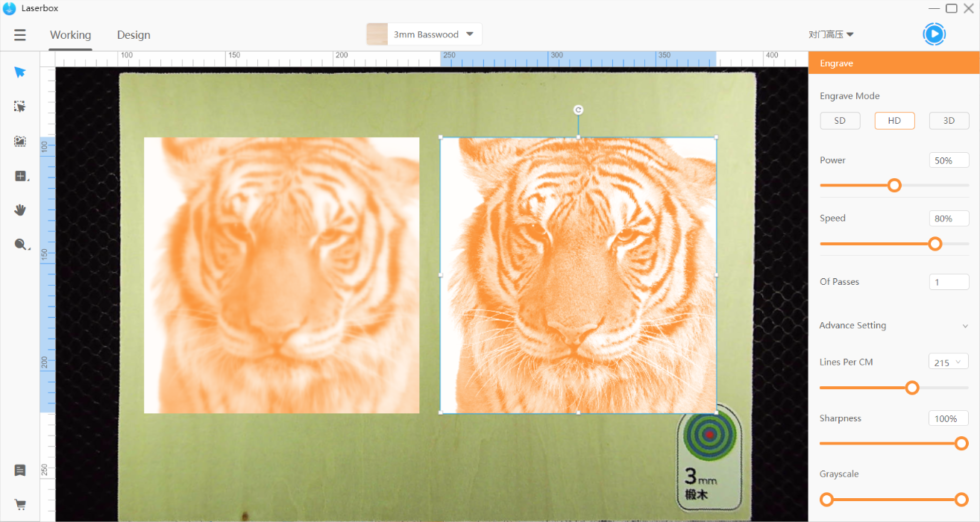

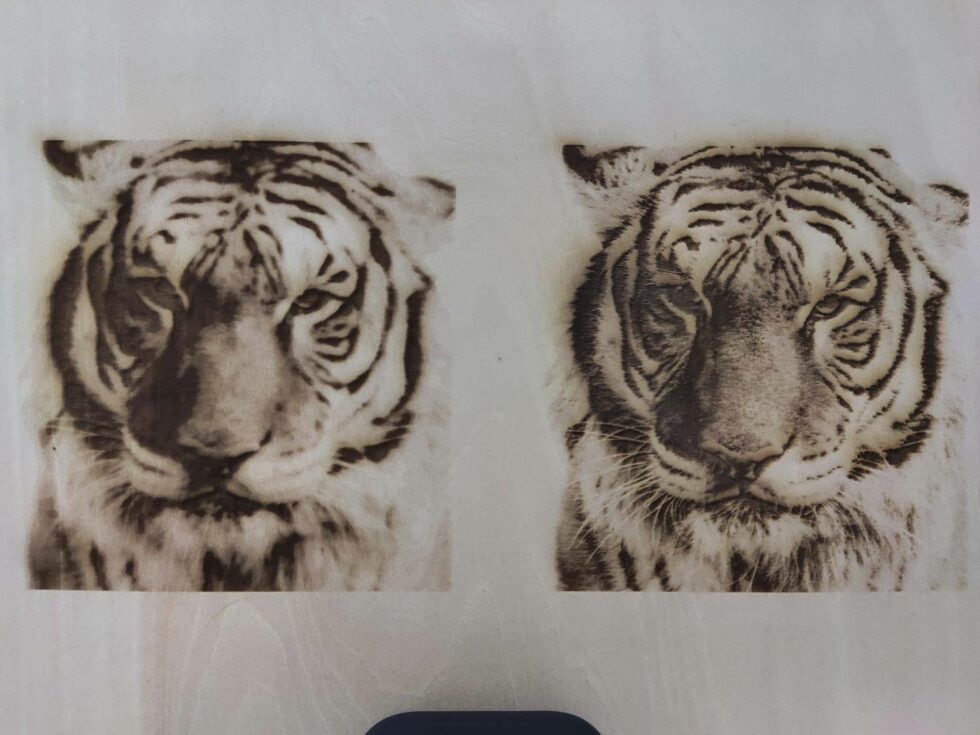

Sharpness
What can it do?
Sharpness is only applicable to bitmap images. An image with higher sharpness has sharper edges and details, and one with lower sharpness has smoother edges and details.
The sharpness of the image on the left is 0, while the sharpness of the one on the right is 100.
How to use it?
Select a bitmap image and go to Advance Setting in the parameters panel. Then drag the slider under Sharpness or enter a value to define the parameter.
Grayscale
What can it do?
Grayscale is only applicable to bitmap images. The grayscale option is available in the Laserbox software, allowing you to produce different engraving effects. Lower grayscale gives higher contrast but causes loss in detail.
How to use it?
To change the grayscale, select a bitmap image, then go to Advance Setting in the parameters panel, and drag the slider under Grayscale.

Color block mode
What can it do?
In the Laserbox software, you can sort the layers based on their colors and apply different processing parameters to layers of different colors. Check Show Color Block in Settings to activate the mode. In the color block mode, you can configure power, speed, and number of passes without considering whether they’re for cutting or engraving.
How to use it?
Go to Menu > Settings > Software, check Show Color Block, and click Save. To set color groups for layers, select a layer and click a color on the color block list at the bottom. A color used in the canvas will appear in the Layer properties on the right side. In the Layer properties, you can set the parameters based on colors.
Device management
Add/Switch Devices
What can it do?
The Laserbox software allows connections to multiple Laserboxes at a time and saves the connected devices to the device list. So, you can easily switch between devices.
How to use it?
At the upper right corner of the window, find the device name and click the drop-down icon on the right of the name to show the device list.
Click on the device name to connect to the device. To remove a device from the list, put the mouse pointer on the name of an unconnected device and click × on the right.
Click Add A Device and select Connect to a new Laserbox or Connect to a networked Laserbox in the pop-up device connection window.

View/Change file locations
What can it do?
The software saves a processing file as a project. It automatically saves your file as you work. You can find your work in the recent files. So, don’t panic if you accidentally close the program before completing your work. You can view and change the default file location in Settings.
How to use it?
Go to Menu > Settings > Software and find Files. Click Change to choose a new location to save your files. Click Open Folder to view the saved files in the file manager and click Save to confirm the settings.
Show/Hide rulers
What can it do?
The canvas has two rulers on its edges, one horizontal and the other vertical. When you select a layer, you can see its width and height from the highlights on the rulers. The rulers tell the size and location of a layer.
How to use it?
Go to Menu > Settings > Software and check Show Rulers. Check the box to display the rulers on the canvas and uncheck the box to hide the rulers. Click Save to confirm your option.
Show color block
What can it do?
The software supports grouping layers by colors and setting processing parameters for layers based on different colors. When this feature is on, you can directly set up the power and speed for your project without considering whether they’re for cutting or engraving.
How to use it?
Go to Menu > Settings > Software and check Show Color Block. Check the box to turn on color block mode and uncheck the box to turn it off. Click Save to confirm your settings.

Device settings
View device information
What can it do?
You can view the information about the Laserbox that is currently connected. Device information includes:
  • Device Name: Name of the connected device, which also appears on the left of the start button in the software interface. You can change the device name in Settings.
  • Standby Time: Total time that a device takes to turn on.
  • Working Hours: Maximum length of time that a cutting/engraving task requires.
  • Printing Times: Number of times that a cutting/engraving task will be carried out.
  • Firmware: Current firmware version.
  • Serial Number: Factory-applied serial number of a device.
  • Device State: Operation status of a device.
How to use it?
Go to Menu > Settings > Device to view device information. The Device, General, and Preference tabs are only available when a device is connected.

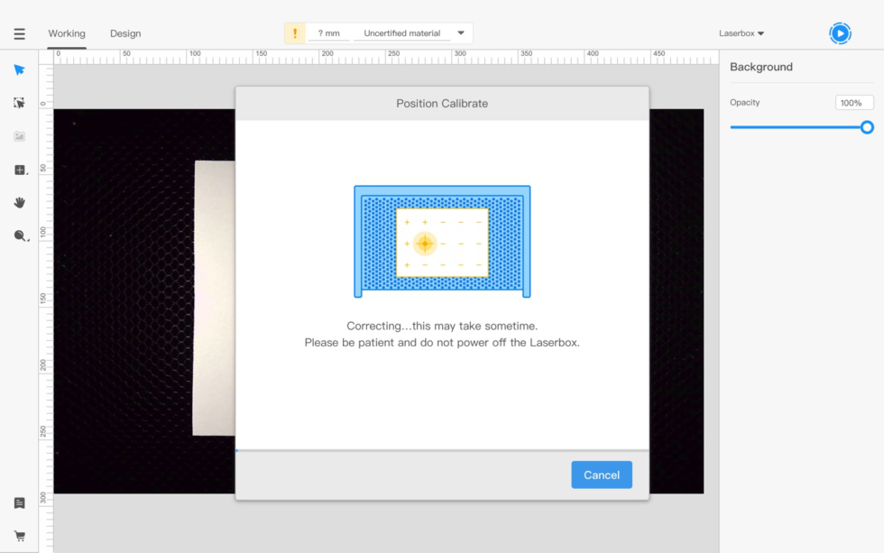

Position calibrate
What can it do?
The camera enables Laserbox to position design drawings and materials. When a deviation occurs, you can use Position Calibrate to reduce deviation from the visual position.
NOTE
When the laser cutter is calibrating, the A4 paper MUST be clean and flat, that is, no stains or curls, because these may hinder the camera from identifying the paper.
When the laser cutter is calibrating, DO NOT place any heavy objects on it because they may cause a positional deviation of the camera.
How to use it?
1. Clean the camera
Lift Laserbox’s lid, spray some alcohol on a cleanroom wipe, and clean the camera with the wipe. Next, check whether the camera comes loose. If it comes loose, glue it to hold it in place before letting the laser cutter start calibrating.
2. Connect Laserbox to your computer
Connect Laserbox to your computer and run the Laserbox software.
3. Click position calibrate
Go to Menu > Settings > General and click Correct after Position Calibrate. Then you will see a pop-up window as follows.
4. Put in A4 paper
Follow the software prompts to place the A4 paper.Use a glue stick or double-sided tape to avoid curls on the paper edges.
5. Start calibrating
Click Next in the prompt pop-up window and press the button on the laser cutter to start the calibration. It takes about three minutes to complete the calibration.
6. Calibration completes
A window below pops up when the calibration is done.

Detection settings
What can it do?
Laserbox can perform device detection, checking whether the tray or purifier is correctly installed. By default, Tray Detection is unchecked and Purifier Detection is checked. When Tray Detection is checked, the software will display a prompt if the tray isn't properly installed. Likewise, when Purifier Detection is checked, a prompt pops up in the software if the purifier isn’t properly installed or the filter cartridge is clogged.
How to use it?
Go to Menu > Settings > Preference and check the options under Detection to turn on the features. If you want to turn off the detection, uncheck the options.

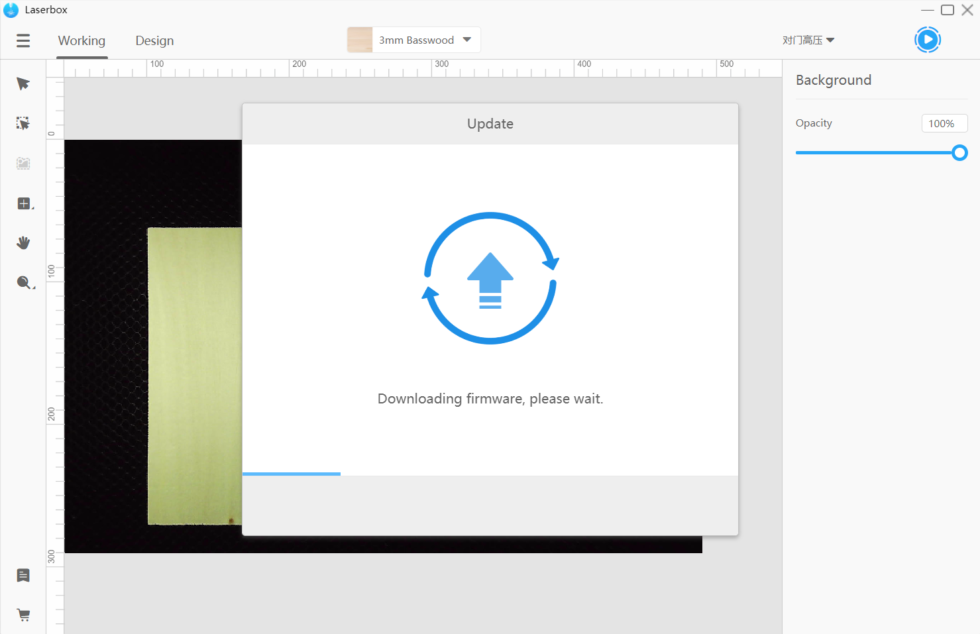

Firmware/Software updates
What can it do?
The Laserbox software and firmware will be updated on an irregular basis to provide you with more features and better user experience. Check for updates in the software, and update the software and firmware to the latest version.
How to use it?

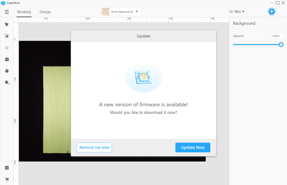

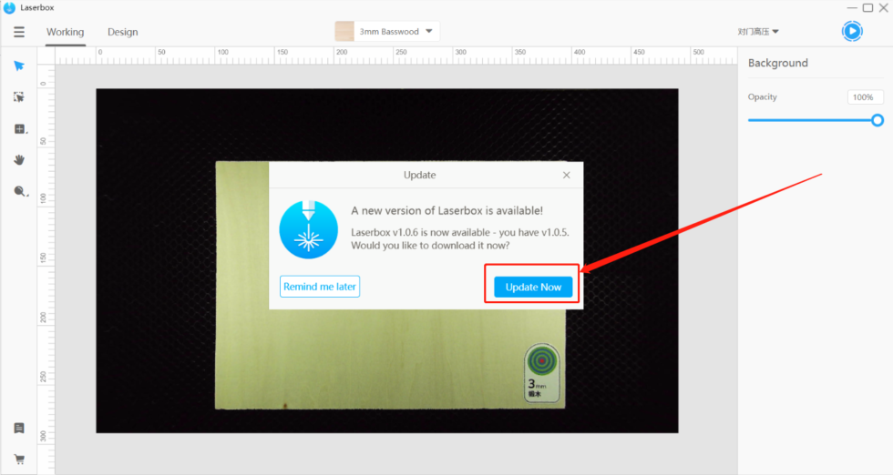

1. Check for updates
Go to Menu > Help > Check For Updates… to see whether the software and firmware are in the latest version.
2. Update software
2.1 Click to update
When a new version of the software is released, a prompt below will pop up. Click Update Now to download the latest version.
2.2 Restart the software
When the installation is complete, click Restart to complete the software update and open the latest version.

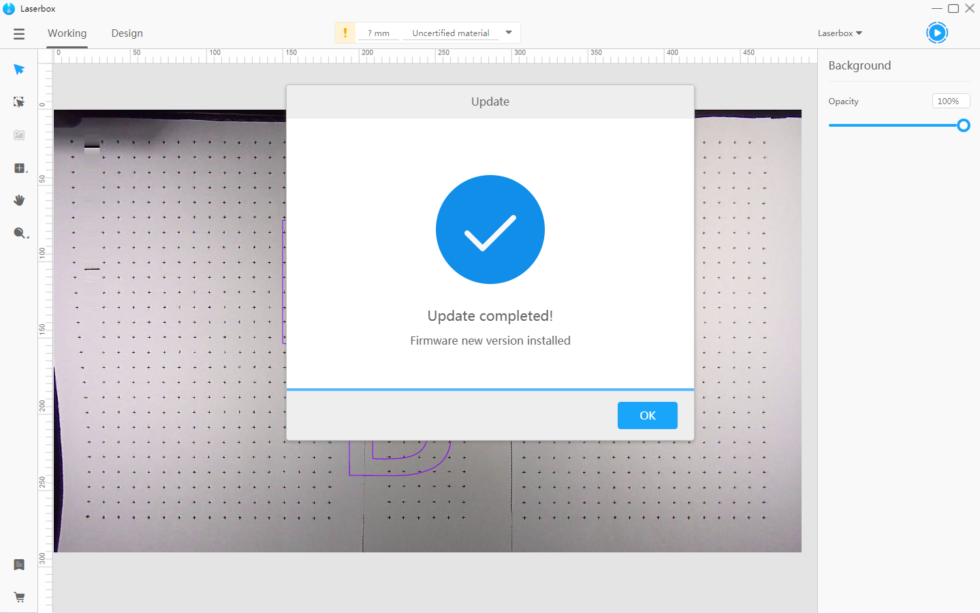

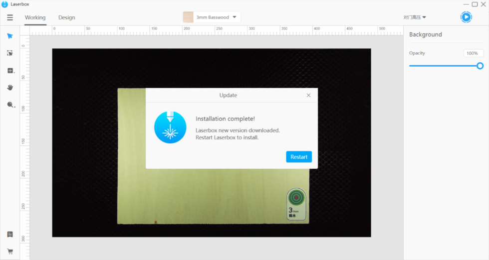

3. Update firmware
3.1 Click to update
When a new version of firmware is available, a prompt below will pop up. Click Update Now to download and install the latest version.
Closing the software or turning off the laser cutter in the middle of the update installation may cause a failed update or Laserbox unable to operate. So, wait for the firmware update to complete.
3.2 Finish
When the update is complete, a window below pops up.
