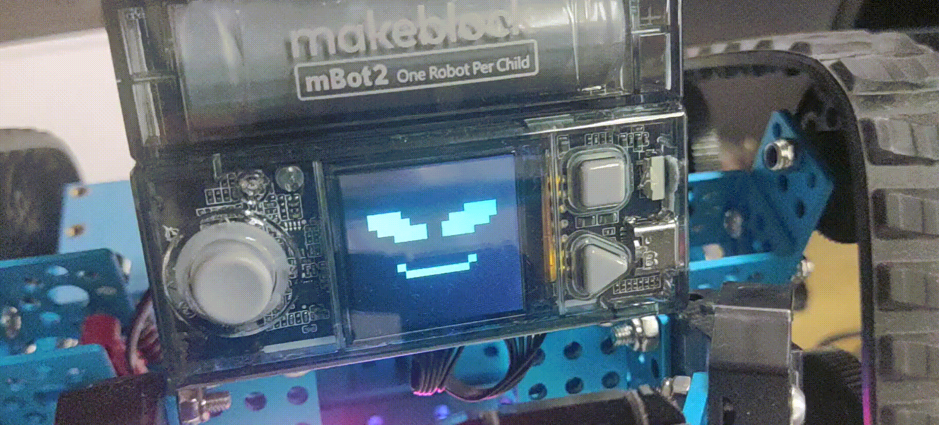

After you upload the program, mBot2 Rover's expression changes when the ambient light intensity is less than 10.

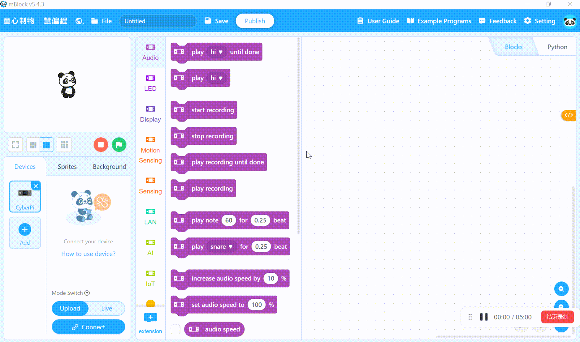

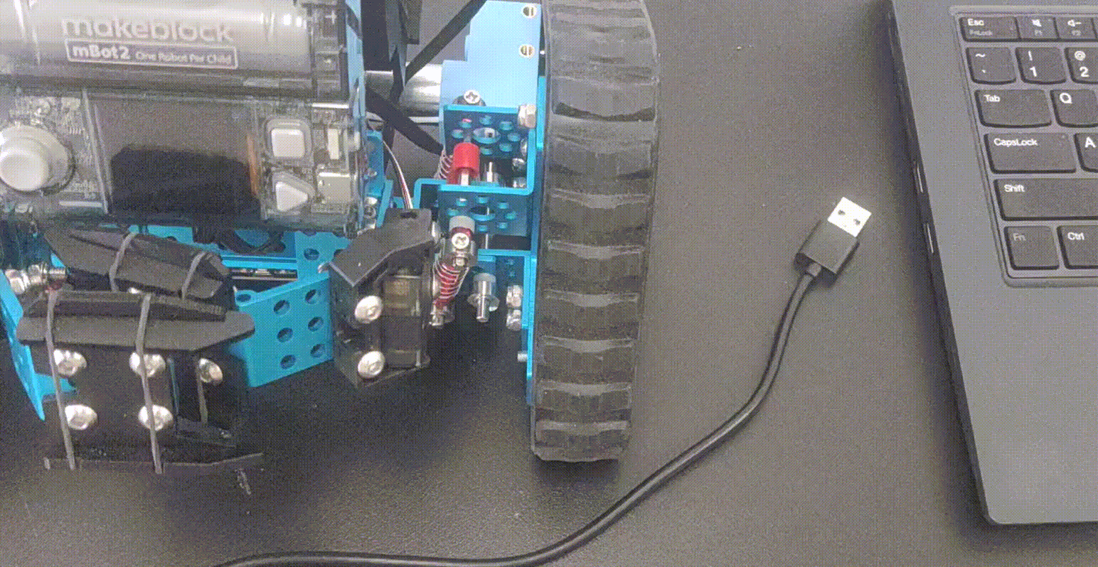

Turn on mBot2 Rover and connect it to the computer by using the cable. Open mBlock 5 (PC client or web version), connect CyberPi, and select the Upload mode.

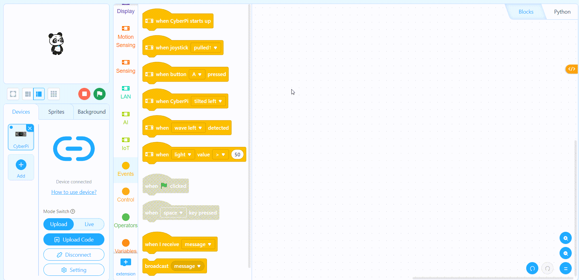

Click + extension on mBlock 5, and add Display+.

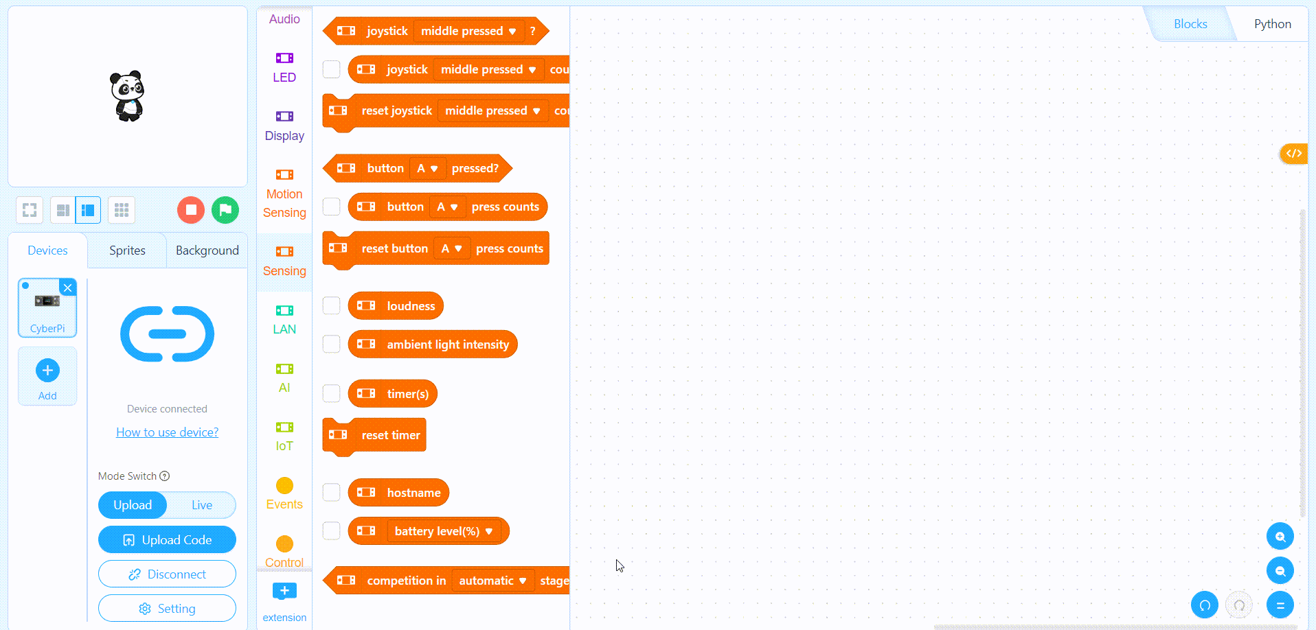

Write the following program, and upload it to CyberPi. Then you can put your finger on the light sensor to change mBot2 Rover's expression.
