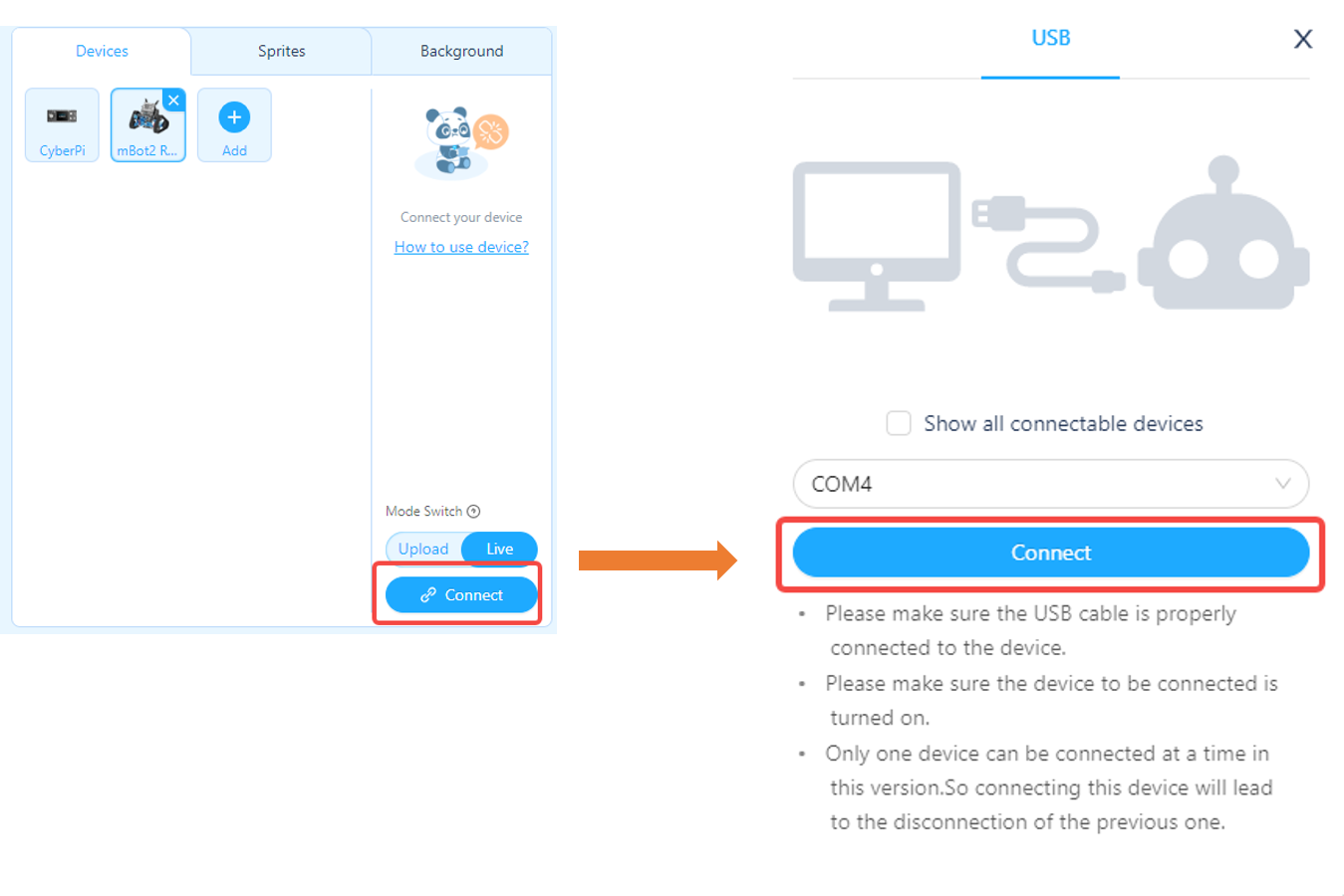

Connect mBot2 Rover to the mBlock 5 PC client

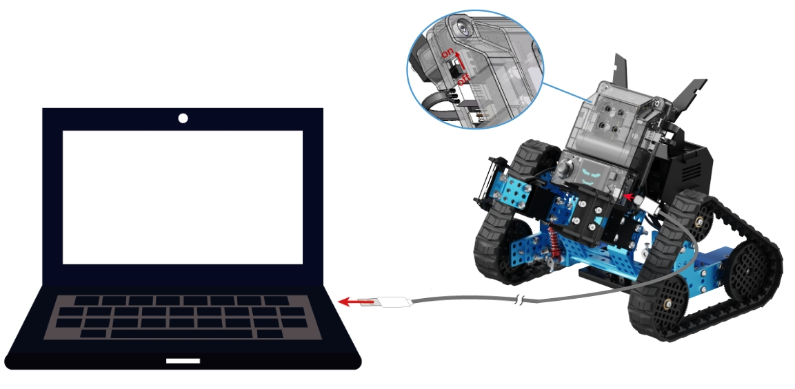

(1) Use the original USB cable to connect mBot2 Rover to your PC, and power on mBot2 Rover.

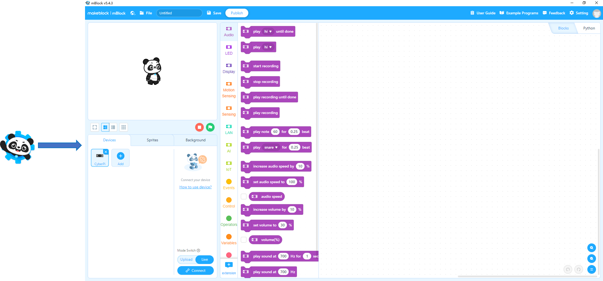

(2) Launch mBlock by double-clicking the mBlock 5 icon on your PC.

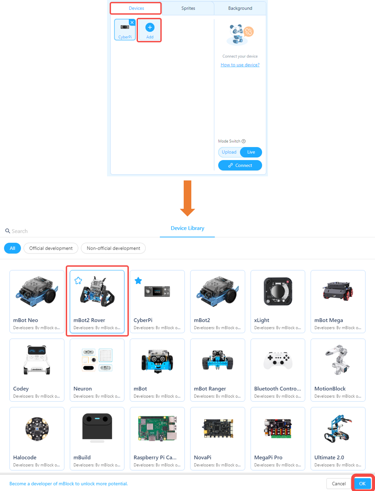

(3) On the Devices tab, click + Add, select mBot2 Rover, and click OK.

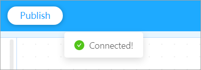

(4) Click Connect to connect mBot2 Rover to mBlock 5.
A message is displayed after mBot2 Rover is connected, indicating that the connection is successful.

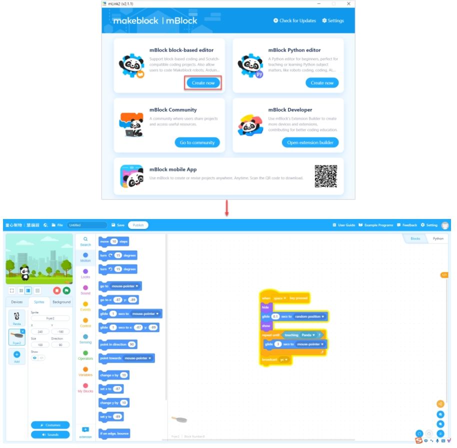

icon.ico Connect mBot2 Rover to mBlock 5 on the web

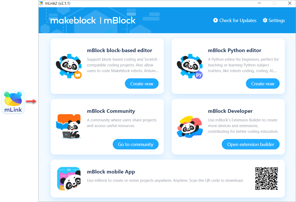

(2) Double-click the mLink2 icon on your PC to open it.
(3) Click Create now in the mBlock block-based editor area to open mBlock 5 on the web.
(4) Click the Devices tab, click + Add, select mBot2 Rover, and click OK.
(5) Click Connect to connect mBot2 Rover to mBlock 5.
A message is displayed after CyberPi is connected, indicating that the connection is successful.

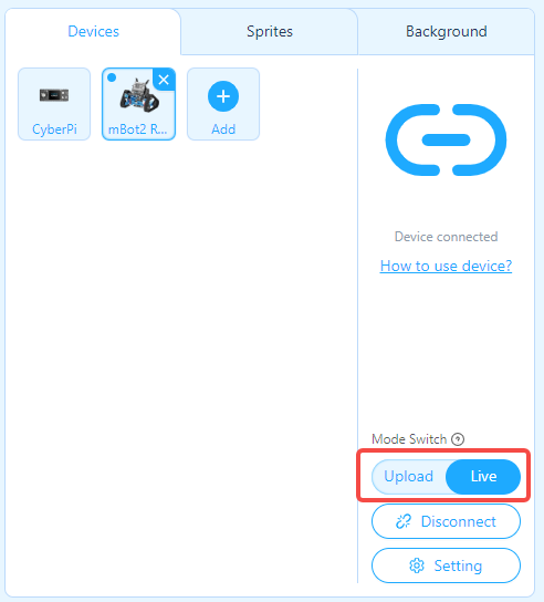

3. Set the programming mode
mBlock 5 provides two programming modes, namely Live and Upload. You can click to switch the mode.
Live: In this mode, you can view the program execution effect in real time, which facilitates the debugging of the program. In this mode, you must keep mBot2 Rover connected to mBlock 5. If they are disconnected, the program cannot be executed.
Upload: In this mode, you need to upload the compiled program to mBot2 Rover. After being successfully uploaded, the program can still run properly on mBot2 Rover when it is disconnected from mBlock 5.
Now you can start to program mBot2 Rover!

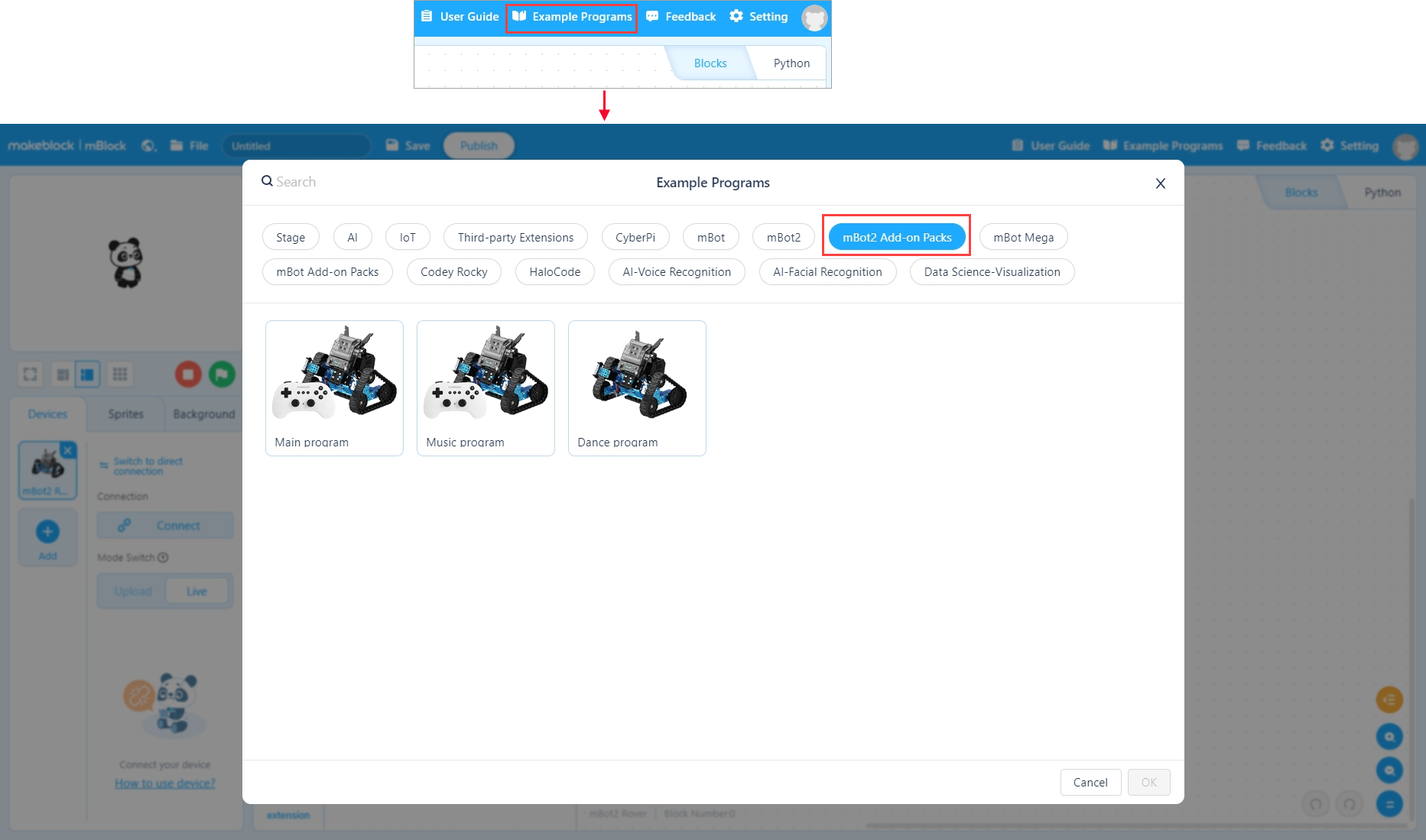

4.1 Example programs
You can understand the functions of mBot2 Rover through example programs.
On mBlock 5, choose Example Programs and click mBot2 Add-on Packs to view example programs provided for mBot2 Rover.

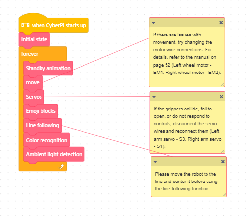

4.2 Block comments
You can read the block comments in an example program to better understand its function and operation.

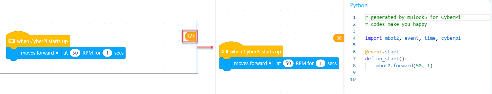

4.4 Learn Python based on blocks
mBlock 5 provides two programming methods for mBot2 Rover, namely block-based programming and Python programming. In Upload mode, you can click the buttons on the right to switch the programming method.
In addition, when programming mBot2 Rover in Upload mode, you can click the switching button on the right to view the corresponding Python statements (obtained by converting the blocks).

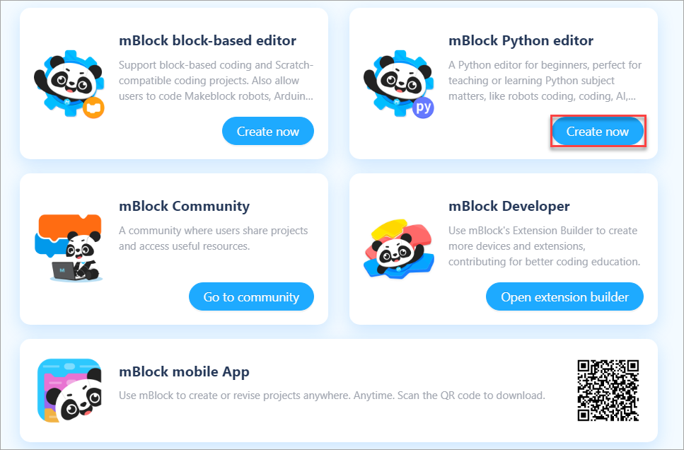

Open mLink2 and click Create now in the mBlock Python editor section.
For details about how to program mBot2 Rover on mBlock-Python Editor, see mBlock-Python Editor Online Help.
