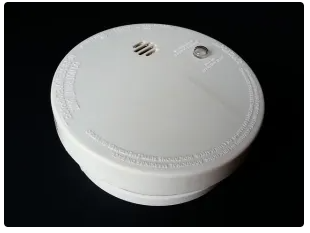

Real-life example
  • A smoke alarm can detect smoke and flammable gas.
