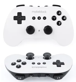

Bluetooth Controller
By pairing with the robots, main control boards, Bluetooth modules and Bluetooth dongles of Makeblock, the Bluetooth controller can be used to remotely control a range of projects.
The Bluetooth Controller is mainly used for robot control in the manual sessions of the MakeX Robotics Competition.

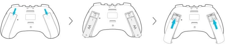

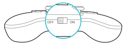

Installing batteries
Notes: When the indicator is solid red, it indicates the battery is low and needs to be replaced in time.

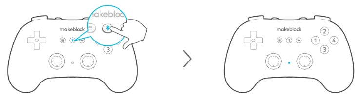

 Turn on the bluetooth controller. The indicator flashes slowly in blue.
Place the controller close to the Bluetooth module of the mBot, and press and hold the button  until the indicator flashes rapidly. Then release the button and the pairing is automatically performed.

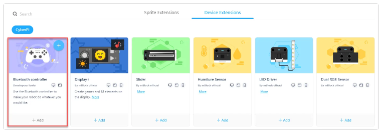

Adding extensions

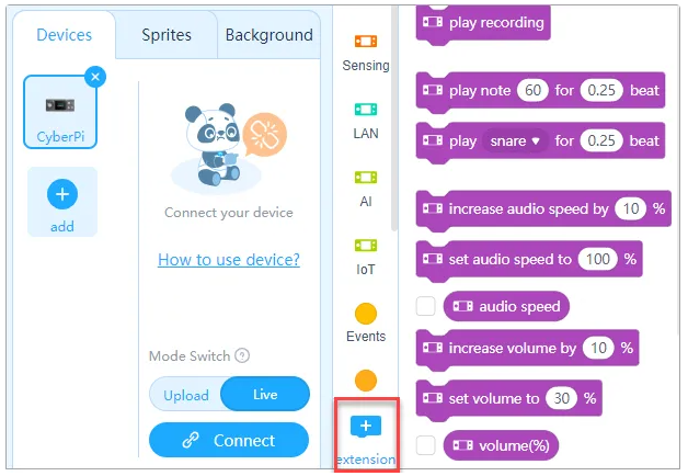

 When you use Bluetooth Controller to control CyberPi, mBot2, etc., you need to add the corresponding extensions on mBlock5 first.
Start programming
After adding the extension, you can write programs with the blocks in the extension, so that you can control products such as CyberPi and mBot2 with a Bluetooth controller.

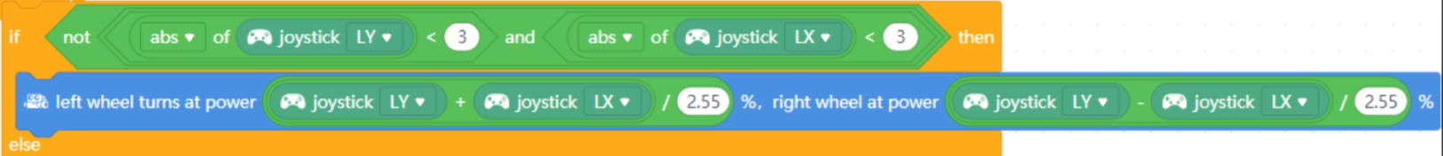

1.Use the joystick to move mBot
Move the left joystick
mBot moves in the same direction as the joystick and its moving speed depends on how far the joystick is pushed.

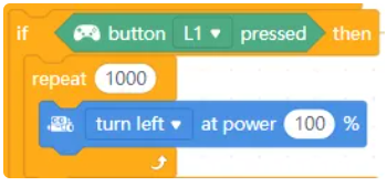

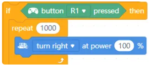

3.Use the buttons to make mBot turn around
Press button L1
Spins from right to left
Press button R1
Spins from left to right

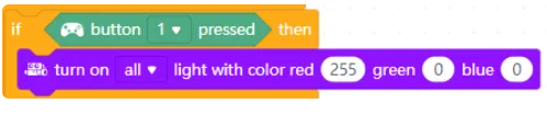

4.Use the buttons to control the color of LEDs
Press number button 1
All LEDs on red
