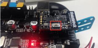

7. What's the differences between [online firmware] and [factory firmware]?
To switch between the two firmware versions, just follow the article “How to Update mBot Firmware” to operte.
  • Factory firmware: The robot is equipped with 3 built-in preset modes (Obstacle Avoidance , Line Following, and IR Remote Control). Therefore, the preset modes work properly only under the factory firmware. The user can switch modes via the remote control or the on-board button.
  • Online firmware: The online firmware does not contain the three preset modes. Under this version, it mainly supports online mode programming and uploading programs to the product to run.
