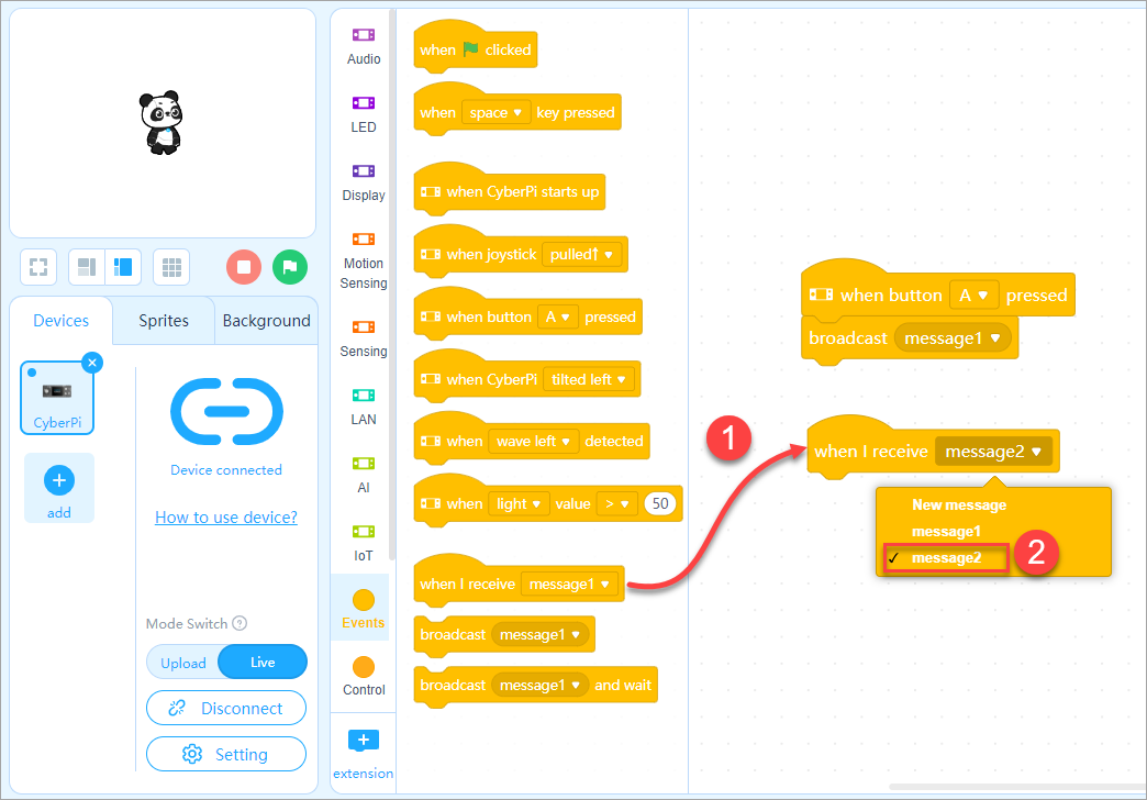

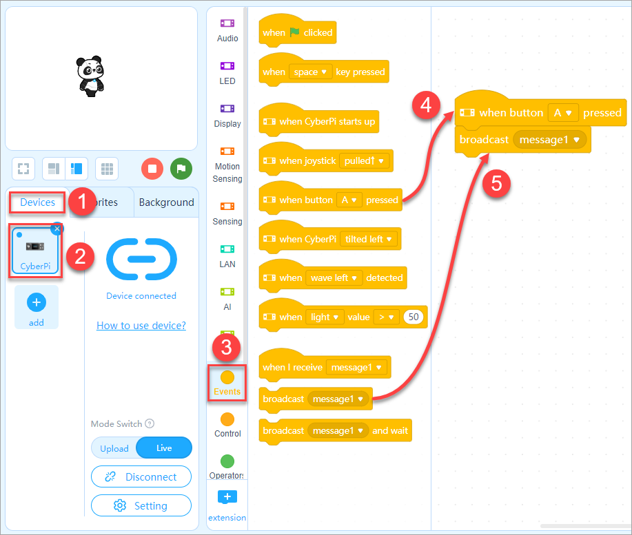

3. Program CyberPi.
Set the operation on CyberPi.

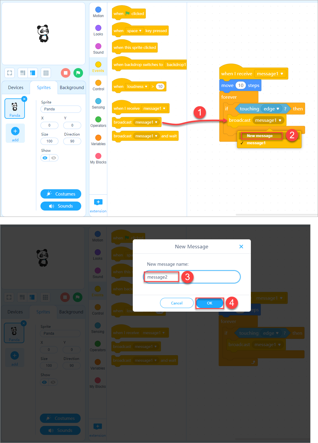

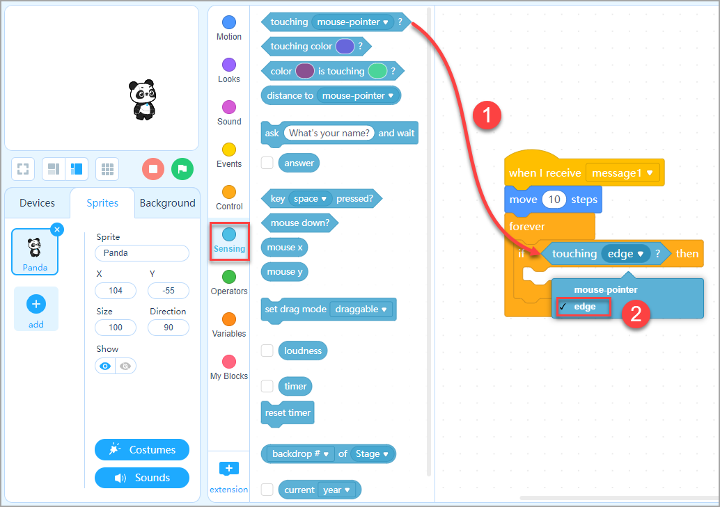

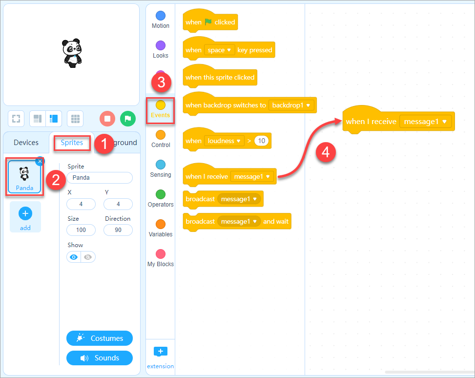

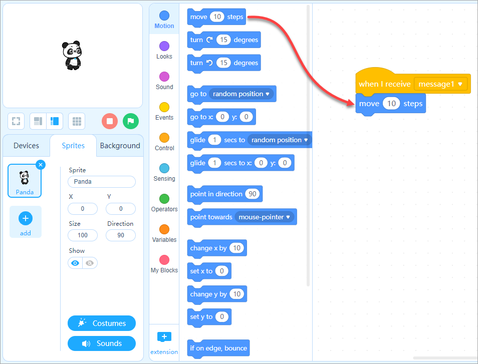

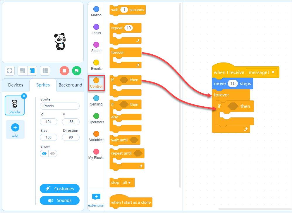

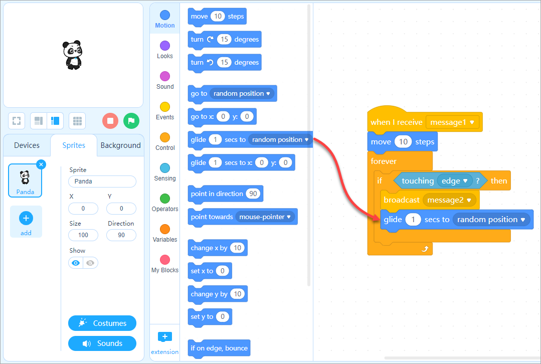

4. Program Panda.
Set the action of Panda.

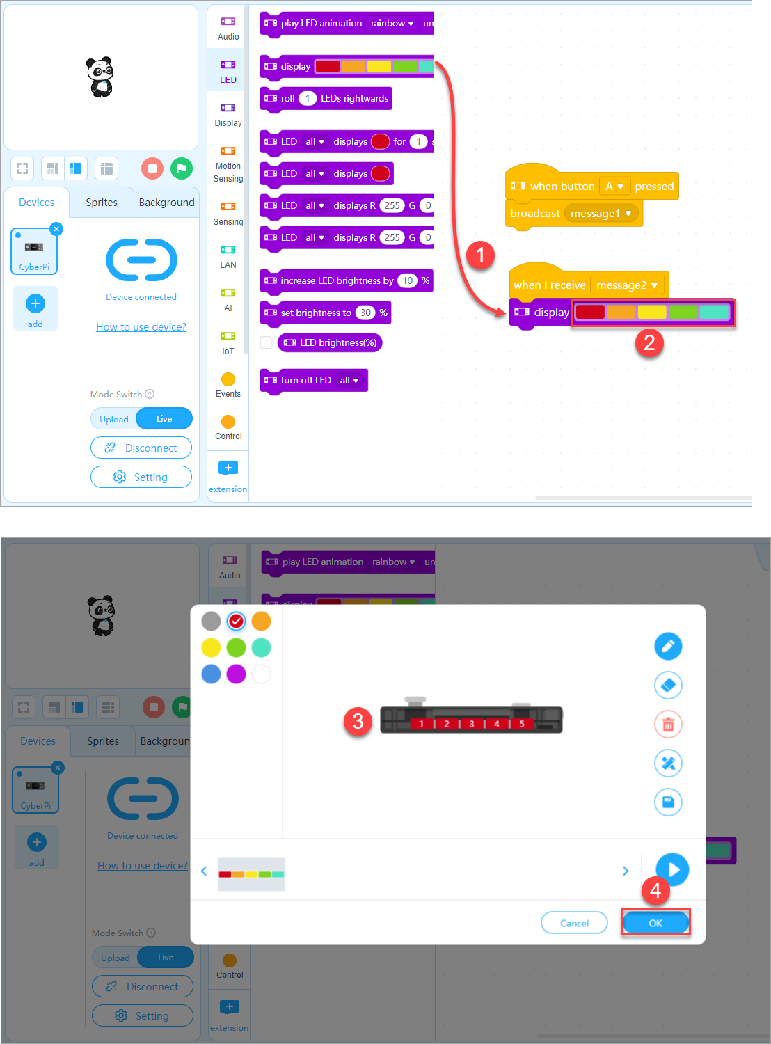

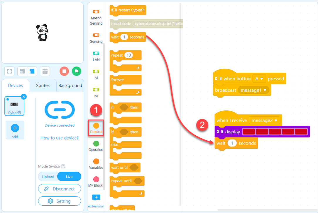

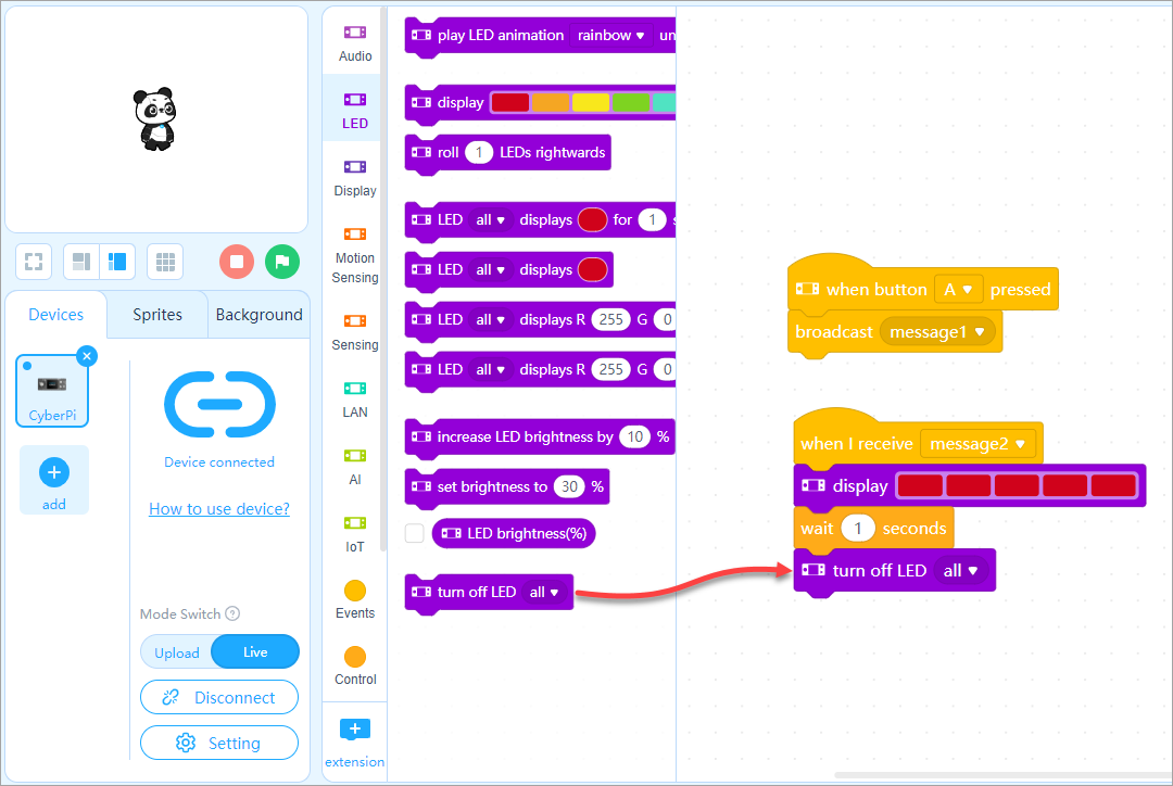

6. Program CyberPi.
Set the action of CyberPi.
The program is complete.
When you press button A on CyberPi, Panda moves on the stage on mBlock 5.
Keep pressing button A.
When Panda touches an edge of the stage, it goes to a random position and the LEDs on CyberPi are lit up in red for one second.
