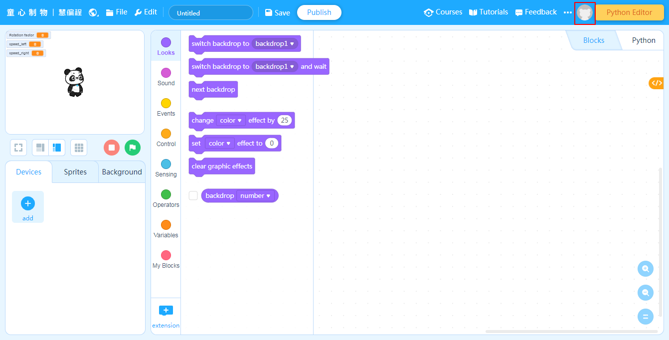

5. How come the IoT features don't work?
The IoT function requires a cloud server, you need to register an account on the mBlock software, log in and then connect to the Internet to use the IoT function.
Registration method: Click the icon on the top right corner of the software.
