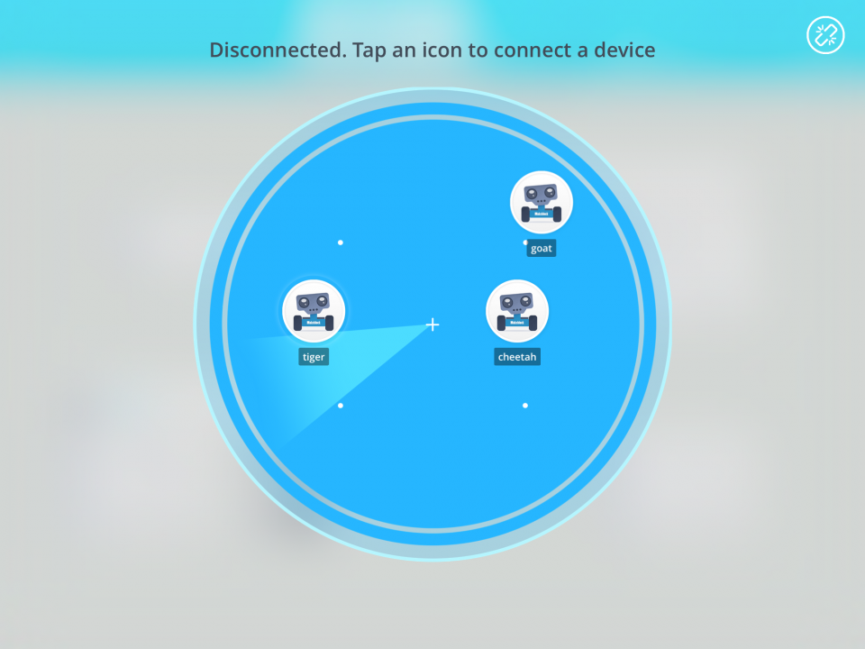

2. Connect via Bluetooth
Turn on your robot and your smart device's Bluetooth. Hold your smart device close to your robot, and then Bluetooth will connect automatically. When the connection LED indicator is solid on, it means that your robot and your smart device have been paired successfully.

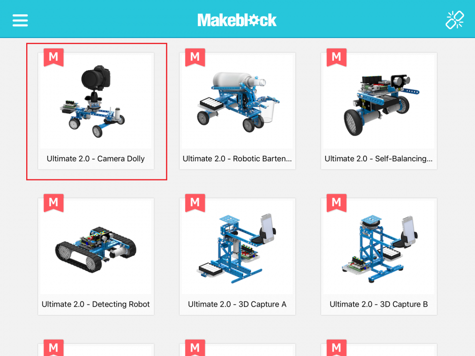

Control Camera Dolly
1. Choose the project by tapping Device → Ultimate 2.0 → Play → Camera Dolly
