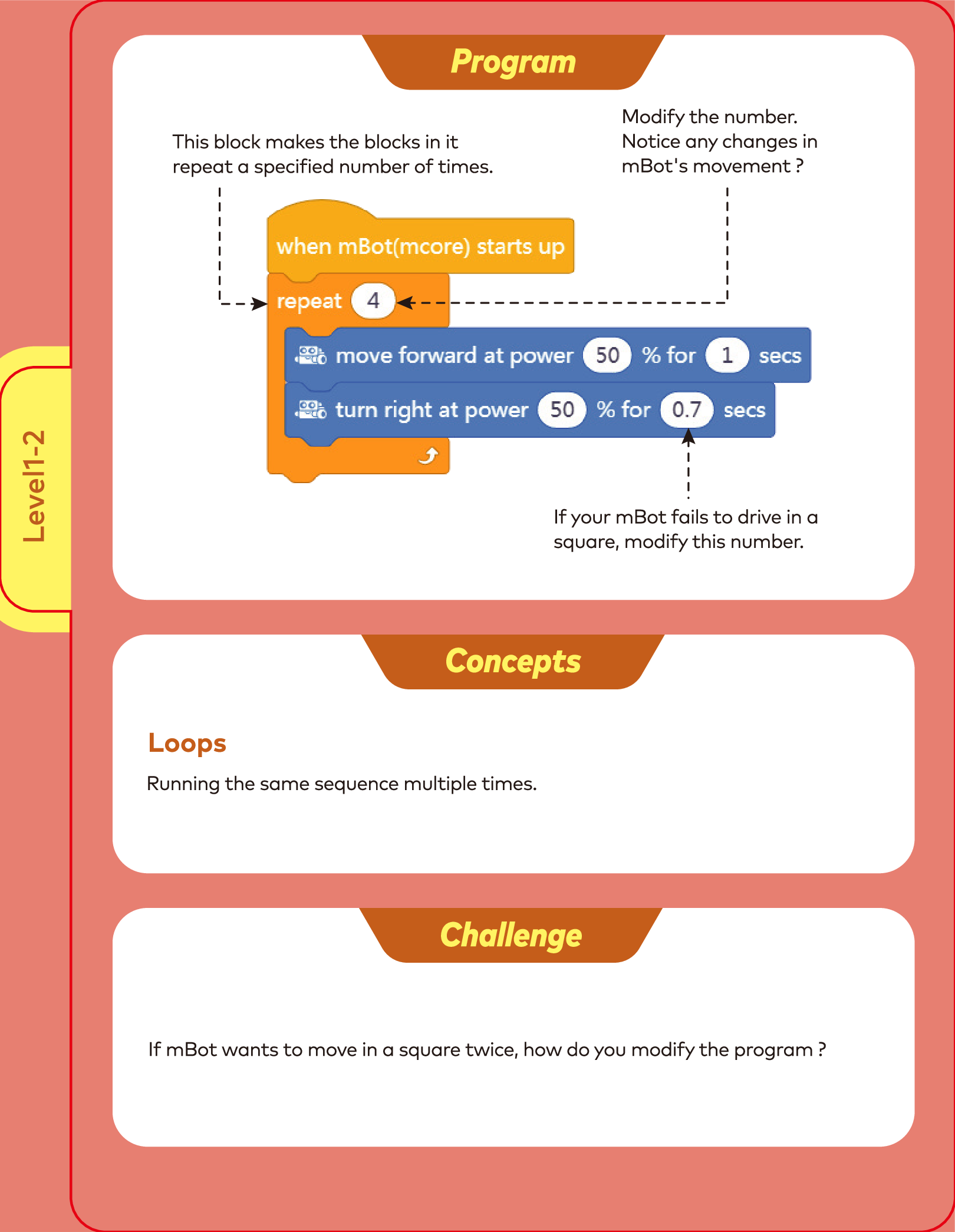

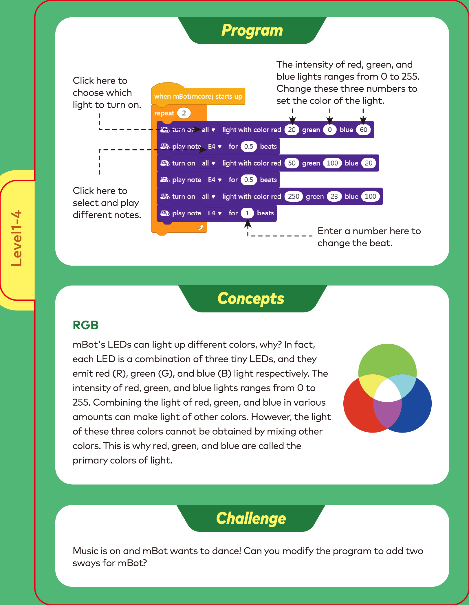

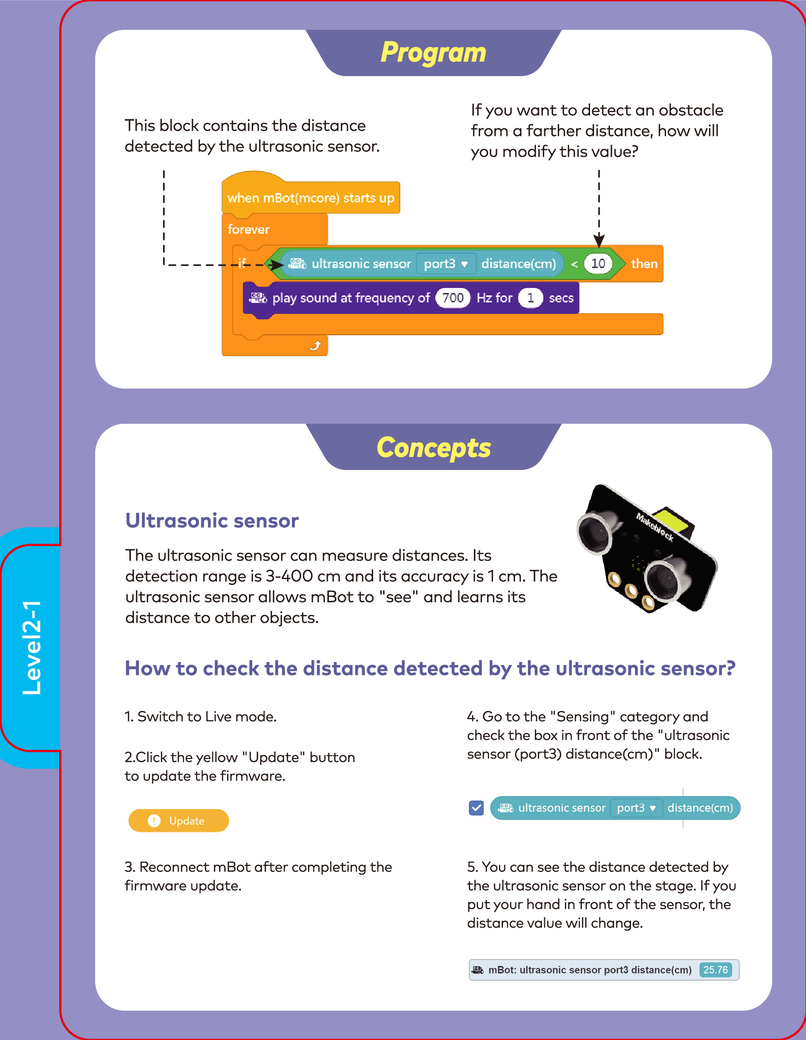

mBot Coding Knowledge Card Part 1
未标题-2_001.png未标题-2_002.png未标题-2_003.png未标题-2_004.png未标题-2_005.png未标题-2_006.png未标题-2_007.png未标题-2_008.png未标题-2_009.png未标题-2_010.png未标题-2_011.png未标题-2_012.png未标题-2_013.png未标题-2_014.png未标题-2_015.png未标题-2_016.png未标题-2_017.png未标题-2_018.png未标题-2_019.png未标题-2_020.png未标题-2_021.png未标题-2_022.png未标题-2_023.png未标题-2_024.png
