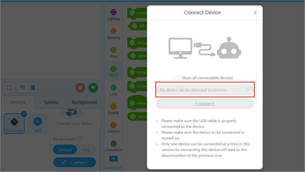

1. No device is detected when connecting Halocode?
When Halocode is connected to the USB port of PC via a USB cable and "Click" button clicked in mBlock 5, yet the Connect Device window says "No device can be detected to connect", as follows:
A: there are two possible reasons: USB cable, or driver. Following are corresponding solutions:
1) USB cable
Some USB cables are charge-only and cannot be used for data transmission. When a charge-only USB cable is used to connect Halocode, mBlock 5 PC might not detect Halocode properly.
If you have other USB cables, please try using another one.
2) The driver is not correctly installed
Due to PC protection software (system built-in or third-party), the driver might not be correctly installed during the installation process. Thus, mBlock 5 PC is unable to detect Halocode.

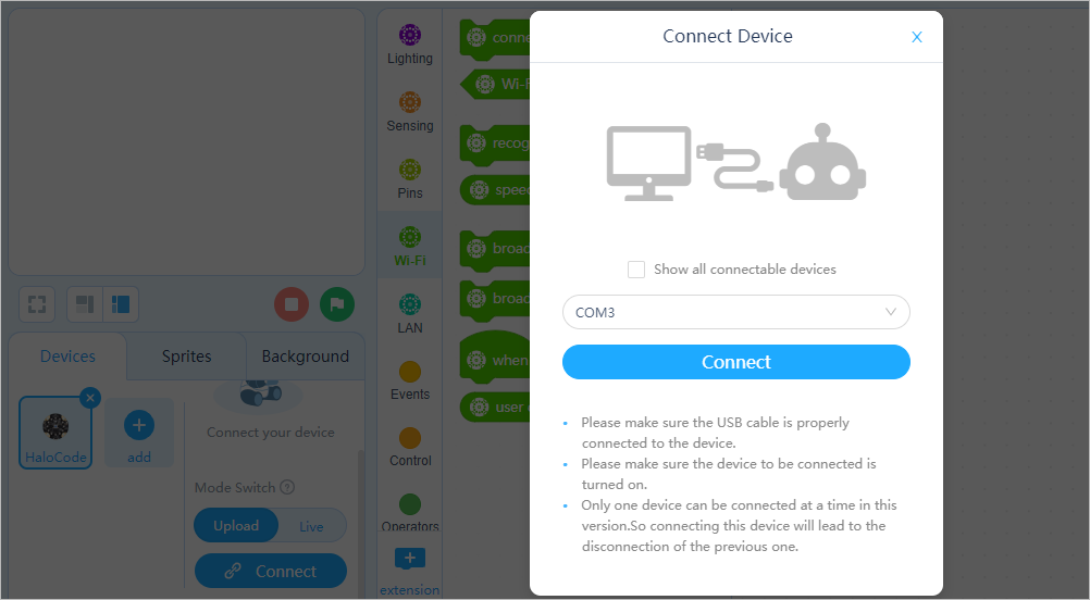

Please disconnect Halocode, and then download and install the driver for Halocode:
After the installation is complete, connect Halocode to PC via a USB cable. Click "Connect", and check whether the connection port is detected (as follows):

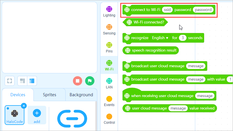

6. How to use the Wi-Fi of Halocode?
You can use the connect to Wi-Fi () password () block from the Wi-Fi category to connect Halocode to the internet. Both the name and password of the Wi-Fi should be correctly input to ensure successful connection.
Note:
Some public Wi-Fi may not work, like those provided hotels, which usually require extra authentication via your phone or other methods.

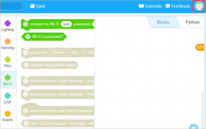

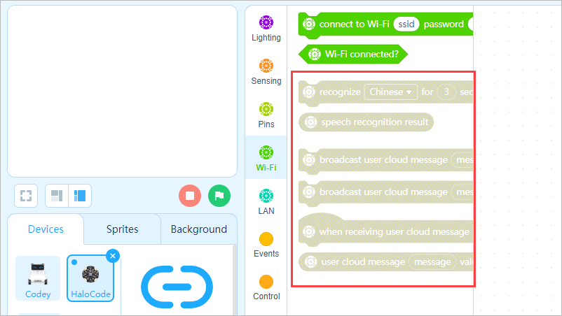

7. Why are some Wi-Fi blocks greyed out (disabled) in mBlock 5?
When using mBlock 5, if you do not sign in/up to mBlock 5, some Wi-Fi blocks will be greyed out (disabled) as follows:
In this case, please find the sign in/up entry in the upper-right corner, and then sign in/up to mBlock 5. All Wi-Fi blocks should be available when you finish.

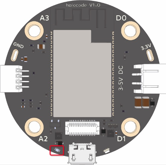

1) Is Halocode normally powered?
Check the blue indicator in the bottom-left corner. If the indicator is off, Halocode is not powered.

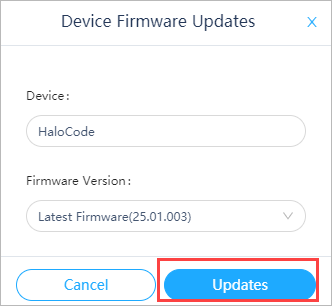

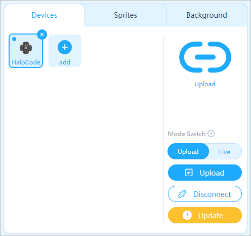

4) Does the firmware version match the block version?
The programming blocks will keep updating. If there are new blocks, the firmware of supported device also need to be upgraded. If your Halocode uses the older-version firmware, but new-version blocks are used, the program can not be uploaded, or won't run properly even though program is uploaded.
Usually, when there is new firmware available, there will be a corresponding prompt in the interface of mBlock 5.
Note: if you get an unofficial firmware version through some channels, these firmware versions will not be prompted for update in the interface of mBlock 5.
When there is a new version, firmware update prompt will be displayed as follows:

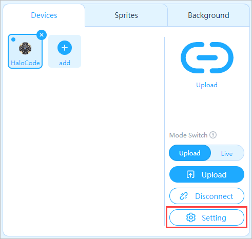

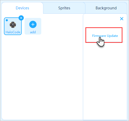

5) Is the firmware damaged?
In some rare situations, unstable power supply voltage will affect the FLASH of Halocode, thus damaging the firmware. Damaged firmware is not always detected by mBlock 5. Users thus are not prompted to fix the problem.
Follow the following steps to re-update and fix the firmware:
