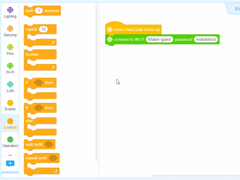

Connect to the internet
1. Drag an Events block when Halocode starts up and a Wi-Fi block connect to Wi-Fi () password (). Input the Wi-Fi name and password.

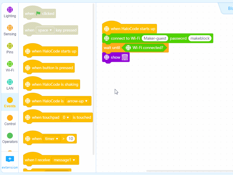

2. We want to know when the Wi-Fi is successfully connected. Add a Control block wait (), a Wi-Fi block Wi-Fi is connected?, and a Lighting block show ().

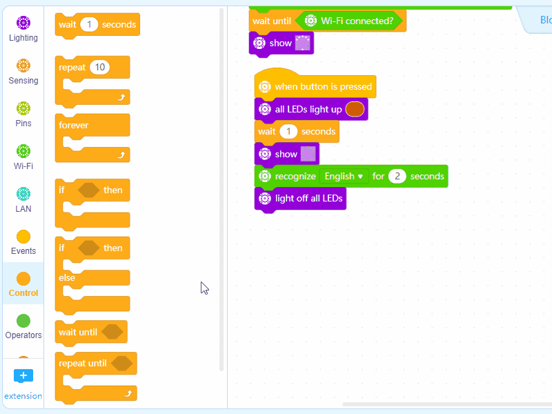

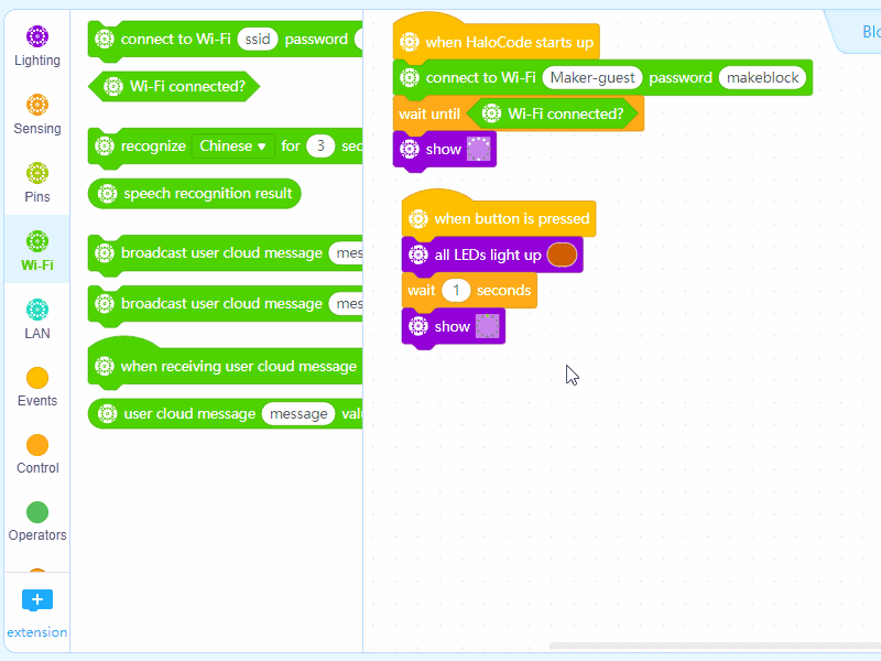

When the button is pressed, all LEDs will light up orange. The recognition process lasts for 2 seconds. When it's done, LED 1 will light up green.
3. Add an Events blocks when button is pressed and a Lighting block all LEDs light up (). Change the color to orange. Then add a Control block wait (1) seconds and a Lighting block show ().
4. Add a Wi-Fi block recognize (English) for (2) seconds, and a Lighting block light off all LEDs to light off all LEDs after the speech recognition is done.

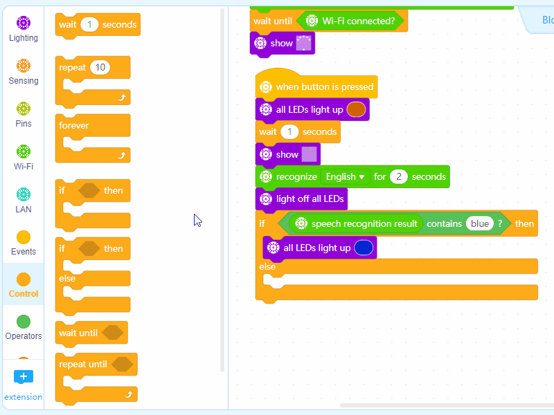

Recognize "blue"
5. Add a Control block if () then () else and an Operators block () contains ()?. Add Wi-Fi block speech recognition result to the first box and input "blue" to the second box. If the speech recognition result contains "blue", all LEDs will light up blue. Add a Lighting block all LEDs light up ()
