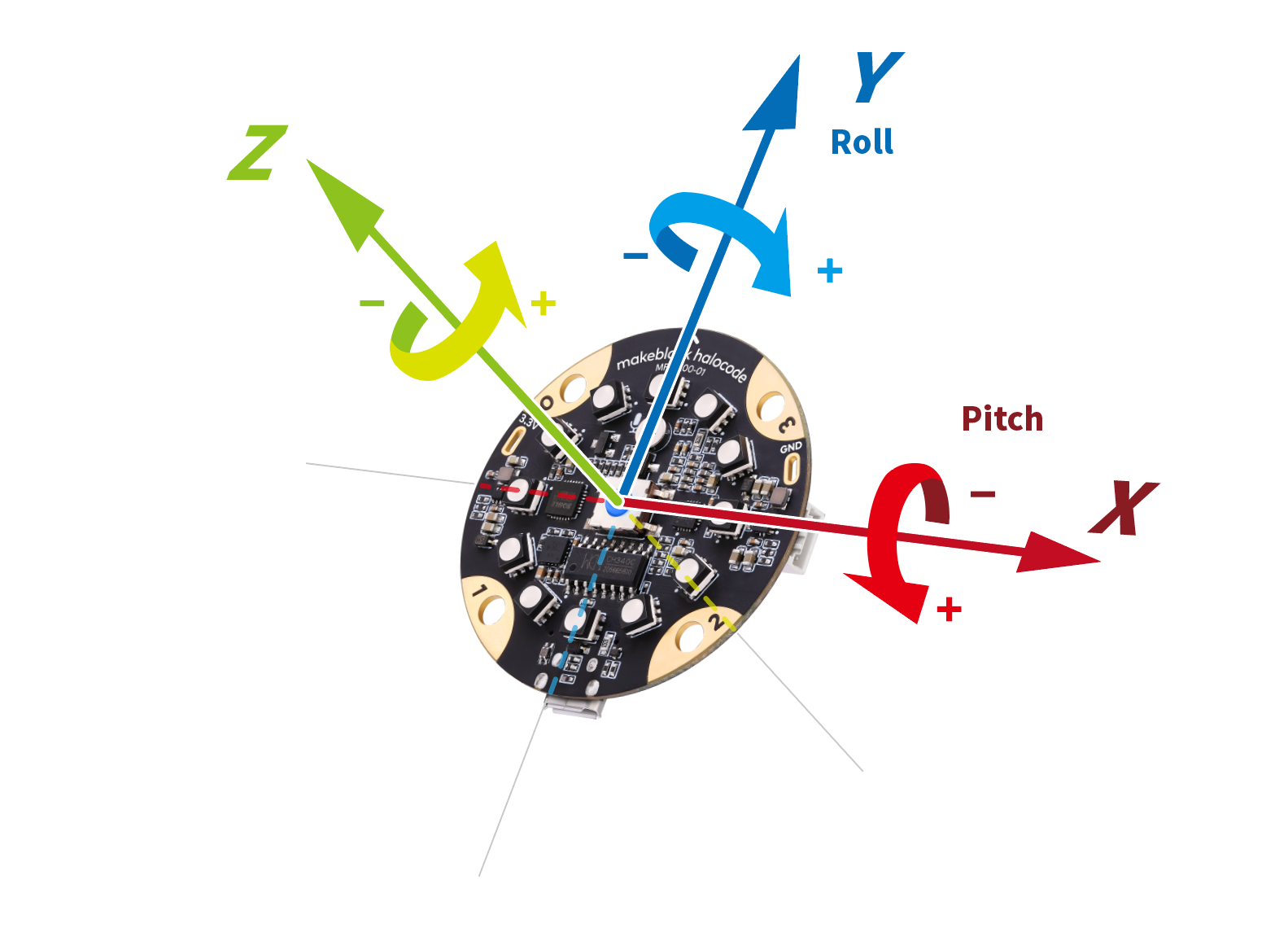

When you rotate Halocode around the y-axis, the sun on stage will rotate as well.
Introduction to Halocode's Axes
The axes of Halocode are as follows:

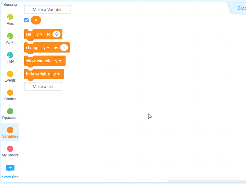

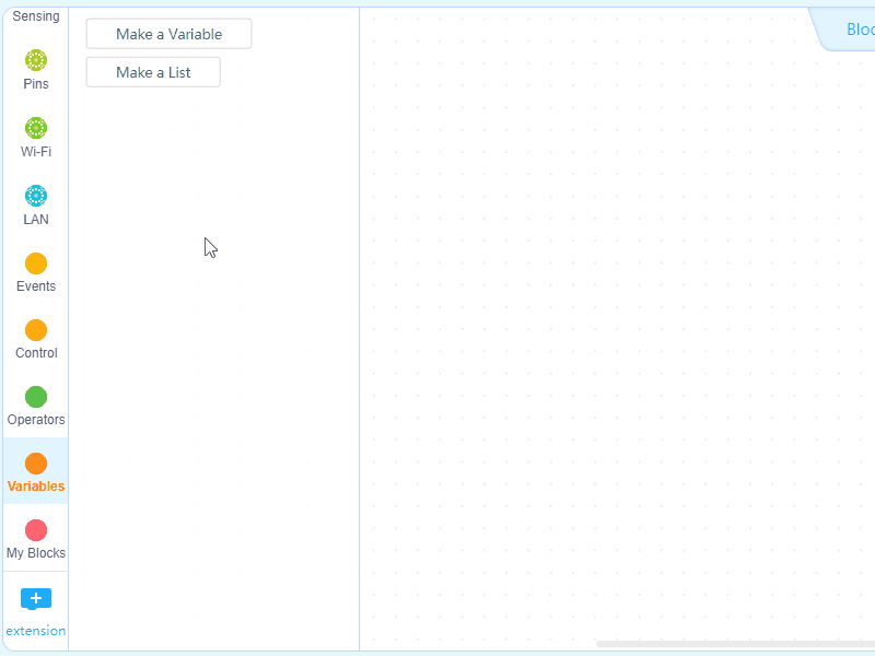

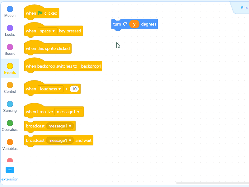

Create a new variable
1. Click Variables category, and then click "Make a Variable". Name the variable "y".

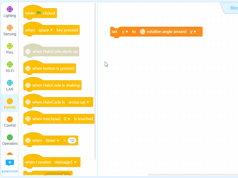

2. Add a Variables block set (y) to () and a Sensing block rotation angle around (). Choose "Y" axis.
Add event and control
3. Add an Events block when button is pressed and a Control block forever.

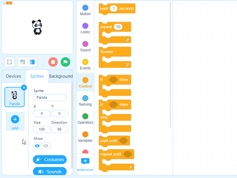

Add a sprite

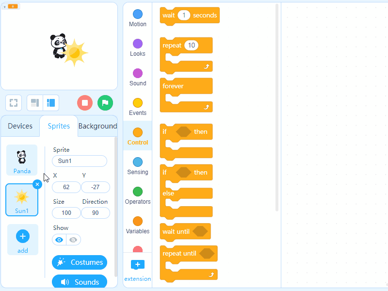

4. Under "Sprites", click "+". Choose "Sun1".
5. Delete default sprite "Panda".
Program the sun

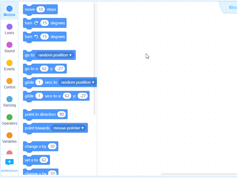

6. Add a Motion block turn ↷ () degrees and a Variables block y.
7. Add an Events block when green flag clicked and a Control block forever.
8. Rotate Halocode and see what happens.
