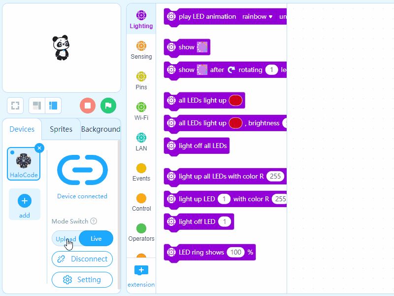

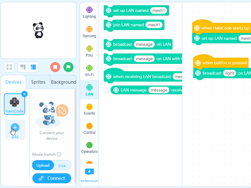

1. Connect Halocode A
2. Enable Upload mode

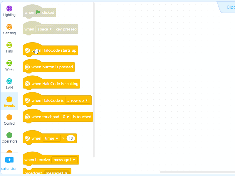

3. Add an Events block when Halocode starts up, and a LAN block set up LAN named (mesh1)。
Halocode A broadcasts on LAN
4. Add an Events block when button is pressed, and a LAN block broadcast () on LAN. Name the message "light"
5. Upload the program to Halocode A

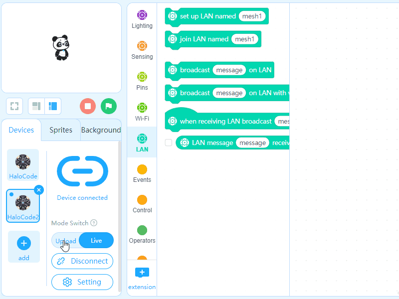

6. Connect Halocode B
7. Enable Upload mode

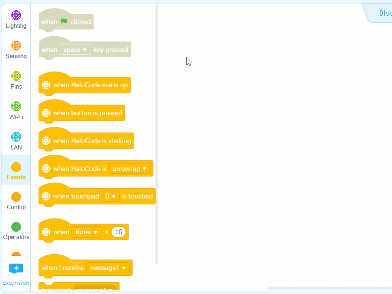

8. Add an Events block when Halocode starts up, and LAN block join LAN named (mesh1)

9. Add a LAN block when receiving LAN broadcast (), and input "light". Add a Lighting block all LEDs light up (), a Control block wait () seconds, and another Lighting block light off all LEDs

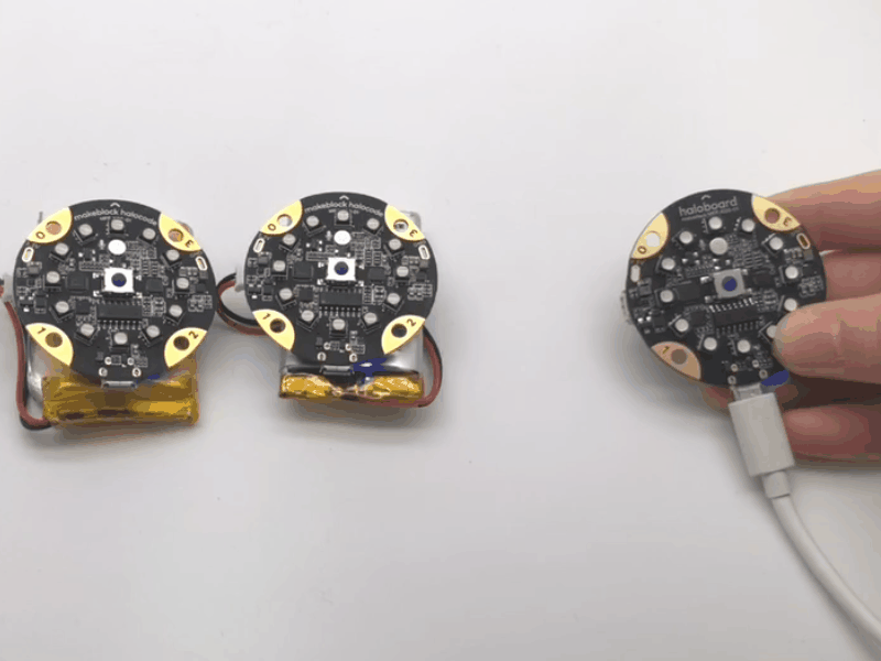

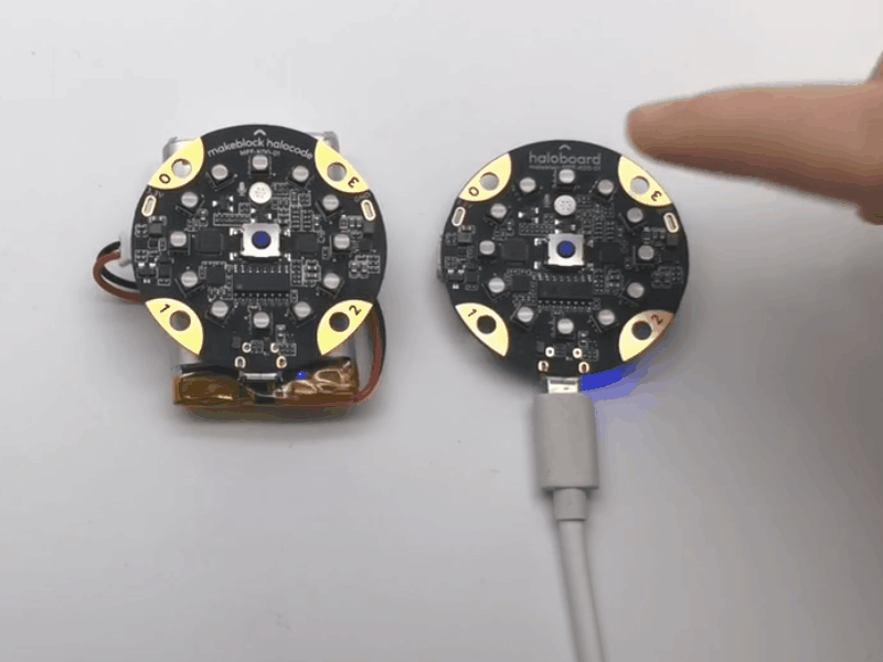

11. Press the button Halocode A
