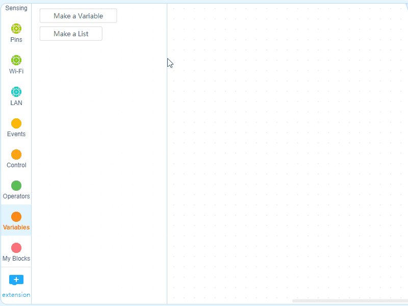

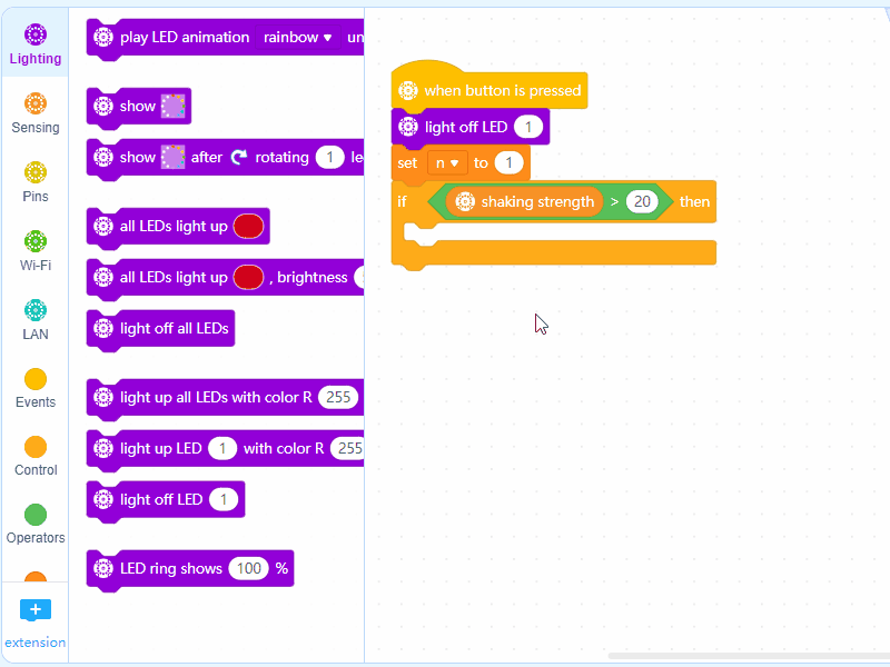

1. Choose Variables block, and click "Make a Variable". Name the variable "n"

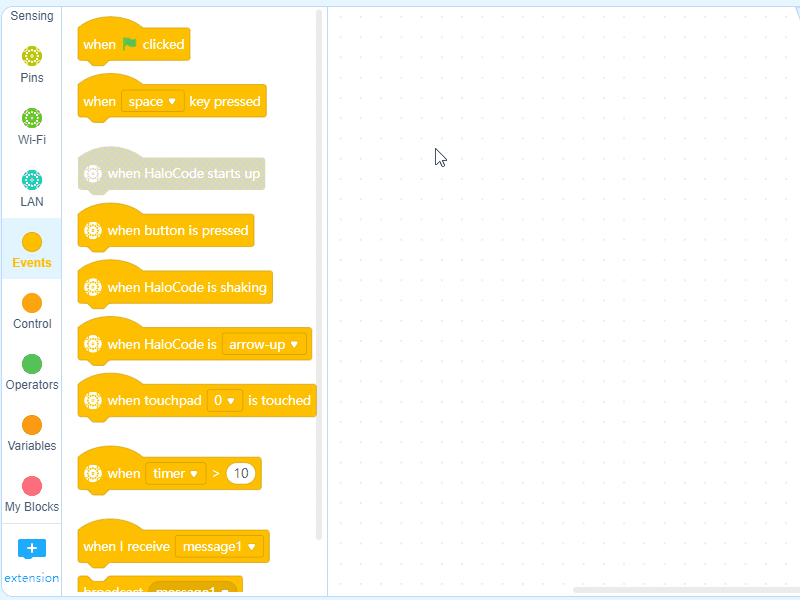

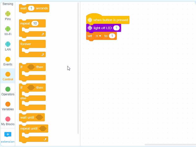

2. Add an Events block when button is pressed, a Lighting block light off LED (), and a Variables block set (n) to (). Input "1"

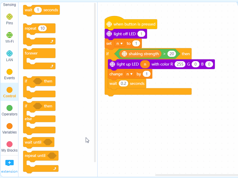

3. Add a Control block if () then (), an Operators block () > (), and a Sensing block shaking strength. Input "20"
4. Add a Lighting block light up LED () with color R()G()B(), two Variables block n and change (n) by (1), a Control block wait () secs. Input "0.2"

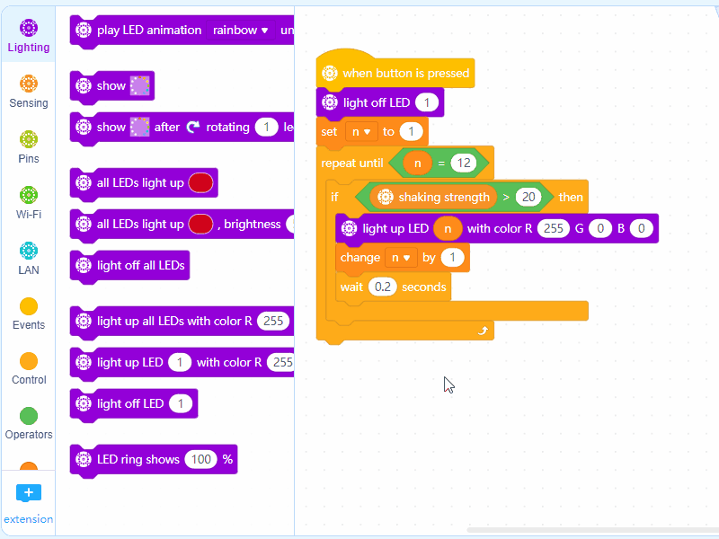

5. Add a Control block repeat until (), an Operators block () = (), a Variables block n. Input "12"
6. Add a Lighting block all LEDs light up (). Set the color to blue
