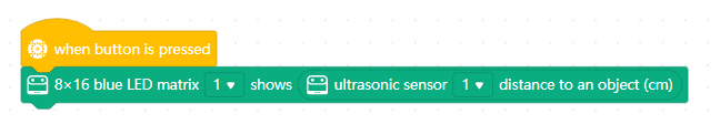

When the button of Halocode is pressed, the distance of obstacle detected by ultrasonic 1 will be displayed on blue LED matrix 1.

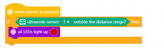

When the button of Halocode is pressed, if the obstacle is outside the range of ultrasonic sensor 1, the LED ring of Halocode will light up red.
