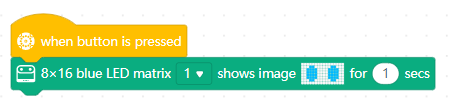

1. 8×16 blue LED matrix (1) shows image () (1) secs
Displays the specified image on the specified blue LED matrix for a specified period of time.
Example
When the button of Halocode is pressed, the specified image will be displayed on blue LED matrix 1 for 1 second.

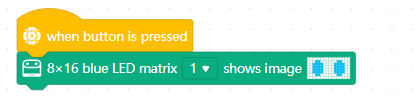

2. 8×16 blue LED matrix (1) shows image ()
Displays the specified image on the specified blue LED matrix.
Example
When the button of Halocode is pressed, the specified image will be displayed on blue LED matrix 1.

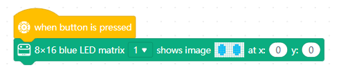

3. 8×16 blue LED matrix (1) shows image () at x:(0) y:(0)
Displays the specified image in the specified position of the specified blue LED matrix.
Example
When the button of Halocode is pressed, the specified image will be displayed at (0,0) of blue LED matrix 1.

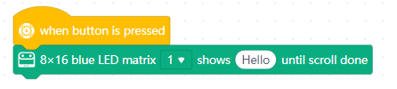

5. 8×16 blue LED matrix (1) shows (Hello) until scroll done
Scrolls the specified text on the specified blue LED matrix until done.
Example
When the button of Halocode is pressed, "Hello" will be scrolled on blue LED matrix 1 until done.

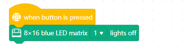

7. 8×16 blue LED matrix (1) lights off
Lights off the specified LED matrix.
Example
When the button of Halocode is pressed, blue LED matrix 1 will go off.

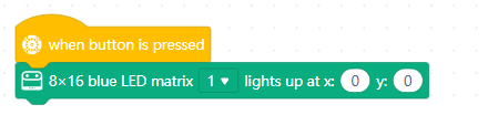

8. 8×16 blue LED matrix (1) lights up at x:(0) y:(0)
Lights up the specified LED of the specified LED matrix.
Example
When the button of Halocode is pressed, the LED at (0,0) of blue LED matrix 1 will light up.

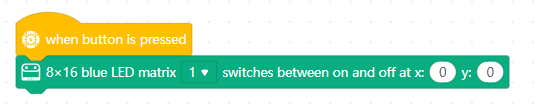

10. 8×16 blue LED matrix (1) switches between on and off at x:() y:()
Switches the on-off status of the specified LED of the specified blue LED matrix.
Example
When the button of Halocode is pressed, the on-off status of the LED at (0,0) will be changed.

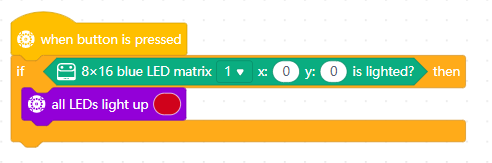

11. 8×16 blue LED matrix (1) x:() y:() is lighted?
If the specified LED of the specified blue LED matrix is lighted up, the report condition is met.
Example
When the button of Halocode is pressed, if the LED at (0,0) of blue LED matrix 1 is lighted up, the LED ring of Halocode will light up red.
