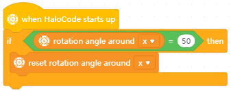

8. () = ()
If the value of the specified parameter equals the specified value, the report condition is met.
Example:
When Halocode starts up, if the rotation angle around the x-axis equals 360 degrees, the rotation angle will be reset.

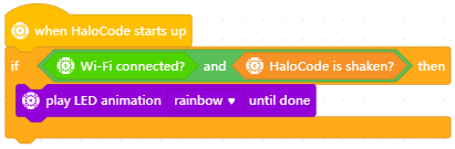

9. () and ()
If both the conditions are met, the report condition is met.
Example:
When Halocode starts up, if Wi-Fi is connected and Halocode is being shaken, the LED animation "rainbow" will be played.

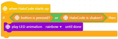

10. () or ()
If either one of the two conditions is met, the report condition is met.
Example:
When Halocode starts up, if the button is pressed, or Halocode is being shaken, the LED animation "rainbow" will be played.

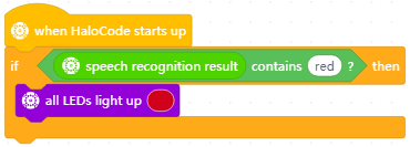

15. () contains ()?
If the specified character string contains the other specified character string, the report condition is met.
Example:
When Halocode starts up, if the speech recognition result includes "red", all the LEDs will light up red.
