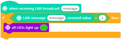

5. when receiving LAN broadcast ()
When the specified LAN broadcast is received, run the script.
Example:
When Halocode receives LAN broadcast "message", all the LEDs will light up green.
6. LAN message () value received
Report the value sent with the specified LAN broadcast.
Example:
When Halocode receives LAN broadcast "message", if the value received with the message is "1", all the LEDs will light up green.
