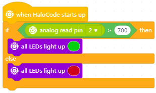

3. analog read pin ()
Read the analog value of the specified pin (0, 1, 2, 3). The value range is 0-1023.
Example:
When Halocode starts up, if the analog value of pin2 is greater than 700, all the LEDs will light up green, otherwise, red.
