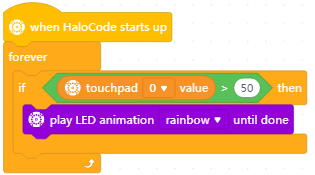

4. touchpad () value
Report the strength by which the specified touchpad (0, 1, 2, 3) is touched. The value range is 0-100.
Example:
When Halocode starts up, if the touchpad0 is touched by strength greater than 50, the LED animation "rainbow" will be played.

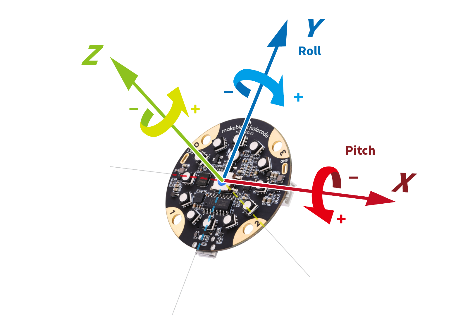

Motion Sensor
The picture above shows the three axes (x, y, z) of Halocode and corresponding directions of the roll and pitch.

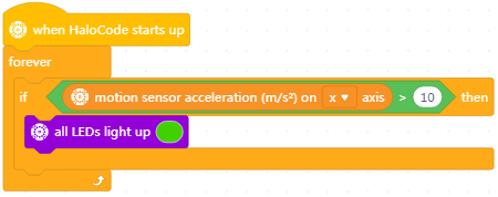

8. motion sensor acceleration (m/s²) around ()
Report the acceleration (m/s²) detected by motion sensor around the x, y, or z axis.
Example:
When Halocode starts up, if the acceleration around the x-axis is greater than 10, all the LEDs will light up green.

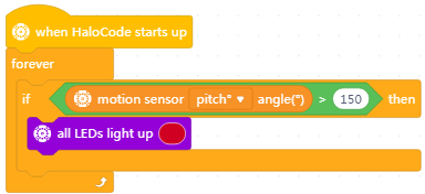

9. motion sensor () angle°
Report the roll or pitch angle.
Example:
When Halocode starts up, if the pitch is greater than 150 degrees, all the LEDs will light up red.

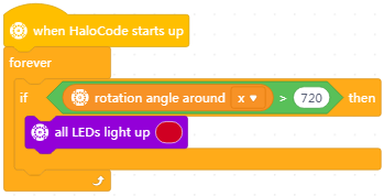

10. motion sensor rotation angle around ()
Report the rotation angle around the x-axis, y-axis, z-axis, or all axes.
Example:
When Halocode starts up, if the rotation angle around the x-axis is greater than 720 degrees, all the LEDs will light up red.
