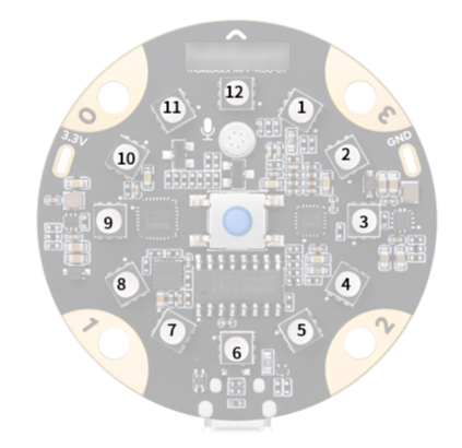

The LED ring of Halocode consists of 12 LEDs. The position and ID of each LED are as follows:

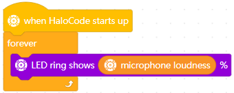

10. LED ring shows ()%
Display percentage with the LED ring.
Example:
When Halocode starts up, the LED ring will show current loudness by lighting up its LEDs.
