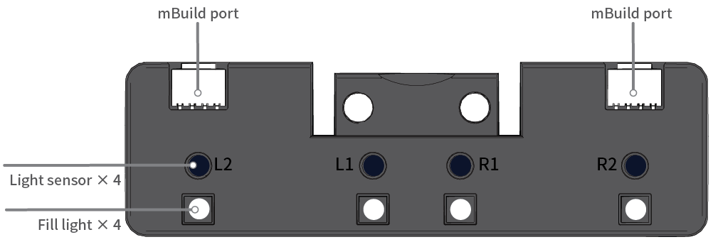

Quad RGB Sensor
quad_rgb_sensor.get_line_sta(index = 1)
Obtains the state of the background.
Returns an integer ranging from 0 to 15, corresponding to the binary numbers 0000 to 1111, where 1 indicates that the background color (light color by default) is detected and 0 indicates that the line (dark color by default) is detected.

Parameter:
- ch: int or str, indicates the specified sensor.
Value range: "L2"/"L1"/"R1"/"R2"/"l2"/"l1"/"r1"/"r2"/4/3/2/1
Returns a value ranging from 0 to 100.
quad_rgb_sensor.set_led(color = "white", index = 1)

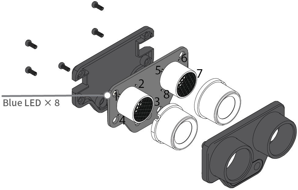

ultrasonic2.led_show(bri, index =1)
Sets the brightness of all the LEDs.
Parameter:
- bri: int_list
This parameter must be set in the format of [bri1,bri2,bri3,bir4,bri5,bri6,bri7,bri8], where x indicates the number of an LED.
The following figure shows the LEDs and their numbers.

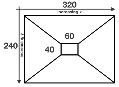

The following figure shows the areas of a captured image.
